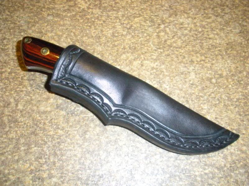

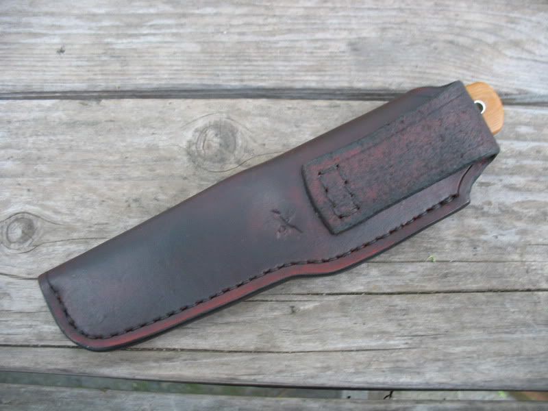

I wish I could get my belt loop edges to be as nice. I may be doing something wrong...I'm beveling both the inside and outside corners of the edge on those loops. Should I not be doing that?
Also, for a nice gloss coating, what product should I be looking at? I like the matte finish I'm currently getting, but I may have folks who want a gloss.
Right now, after dying when I finish up the sheath, I work in 3-4 coats of mink oil with a hair dryer, then hand buff with a microfiber towel.
Thanks! Yeah they're separate strap loops. I'd like my next sheath to have an included loop made into the top....figure I'd give that style a try.
One more question...what is the advantage of taking the last couple of inches along the spine of a pouch sheath and splitting it, then sewing it together flat? Is it purely cosmetic, or does it allow better blade retention?

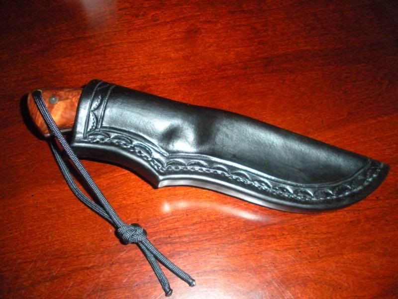

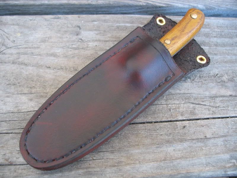

dangler style sheath for a David Farmer "tribal utility" belt knife..

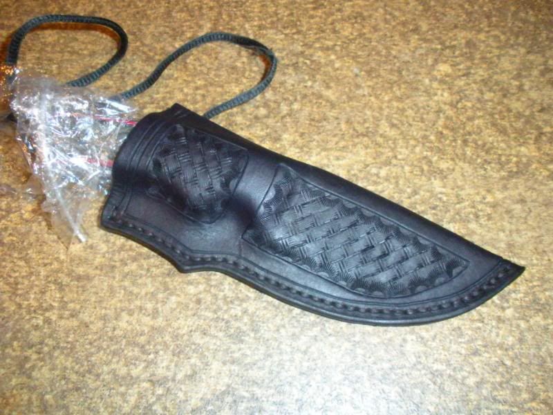

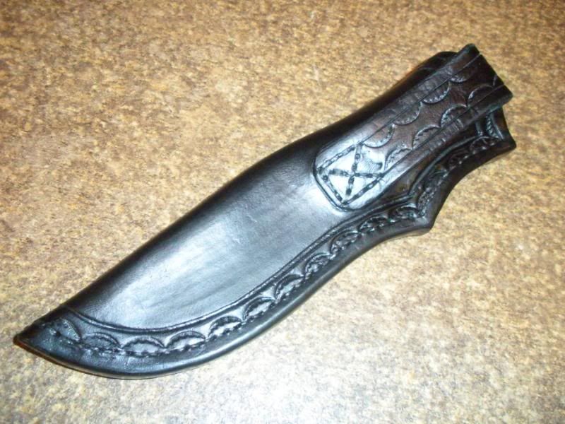

necker sheath.

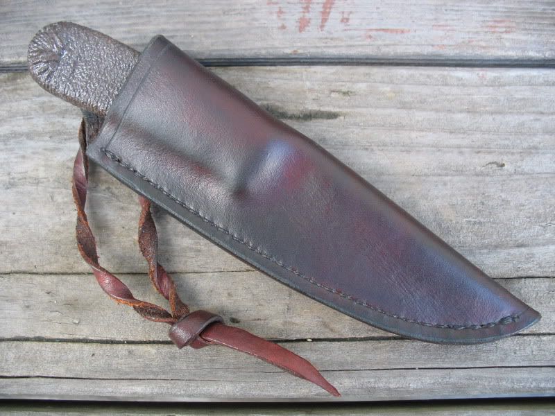

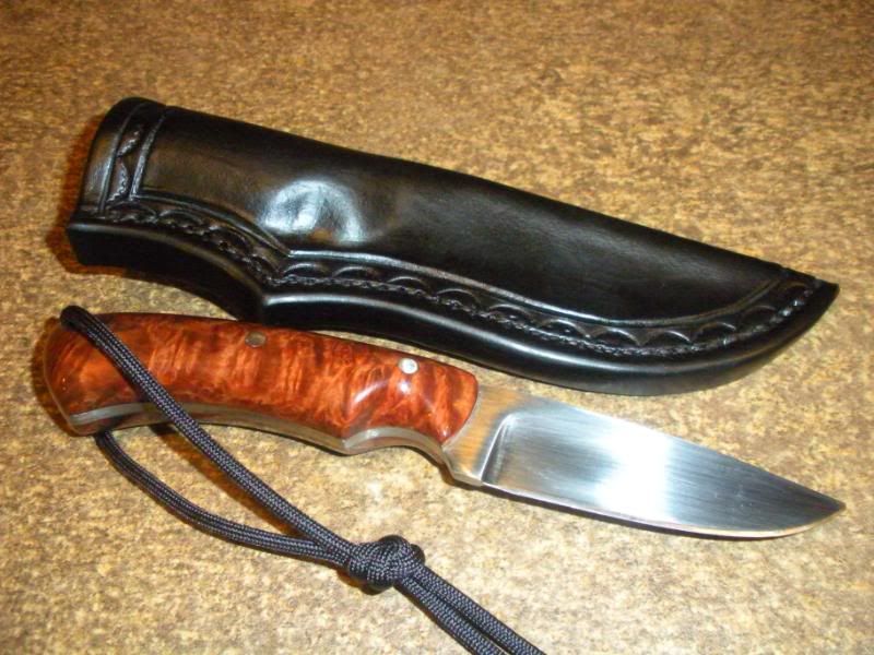

sheath for a Ray Laconico Kephart..

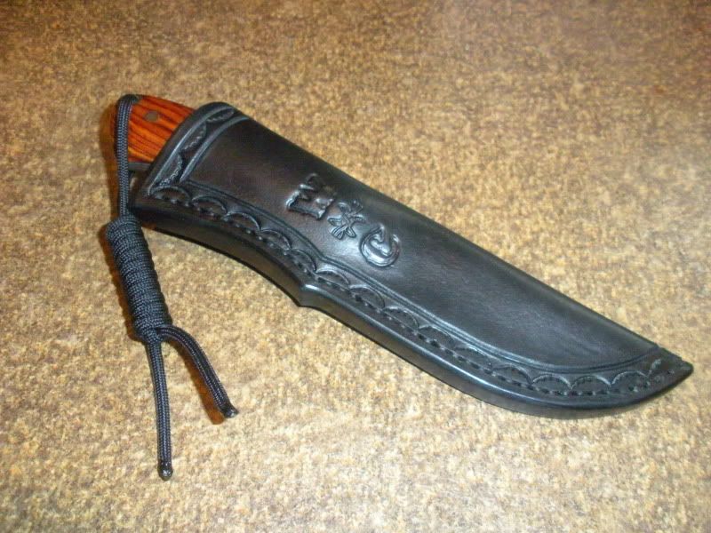

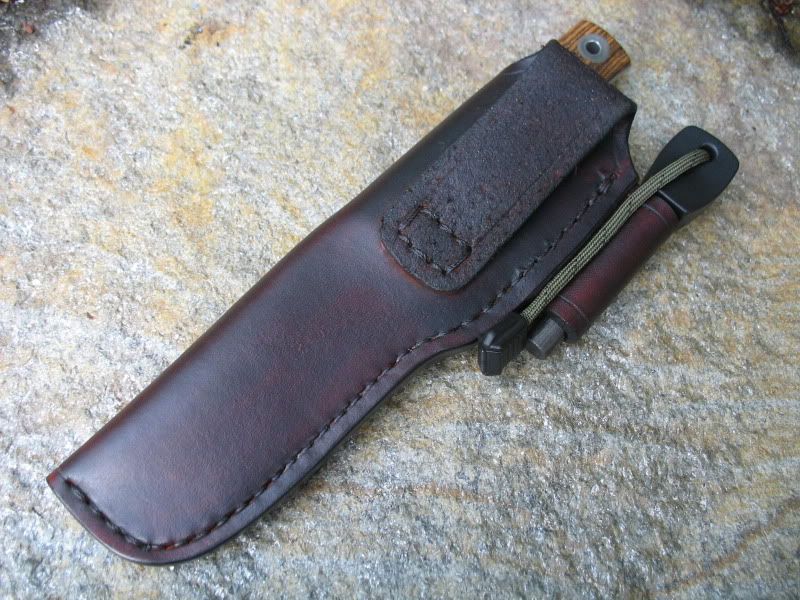

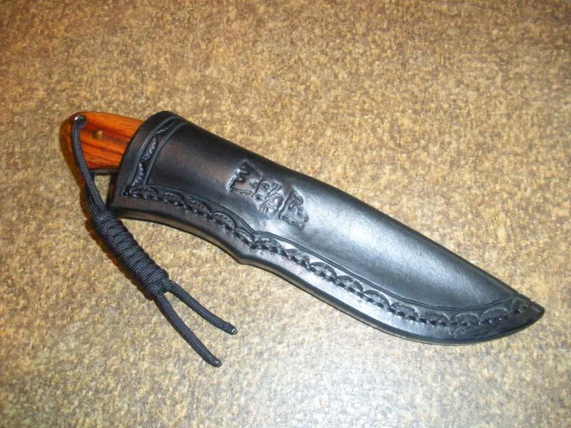

Fiddleback Terrasaur sheath with firesteel loop..

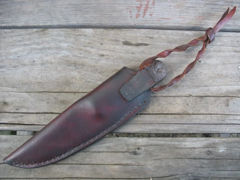

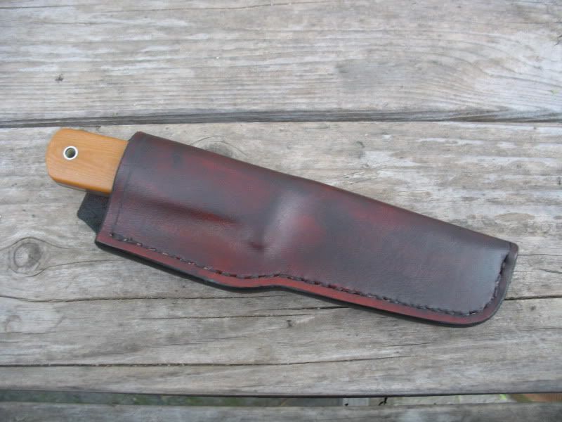

Hey, what dye are you using (and finish) to get that beautiful reddish brown color on those last few pics?
What kind of feel do your sheaths have with the beeswax on it? Do they feel gummy at all? A friend of mine made cow's knee (a leather cover for a flintlock's firing mech) and worked it over with beeswax but it felt gummy.
Nice, I may have to try this on my next sheath. Do you simply take a piece and rub it on the leather after heating the sheath up? Then go over it with a hairdryer to melt the wax further and soak it in?

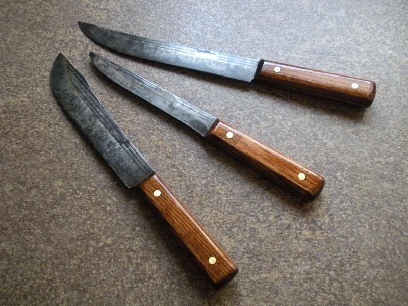

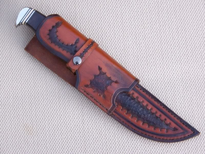

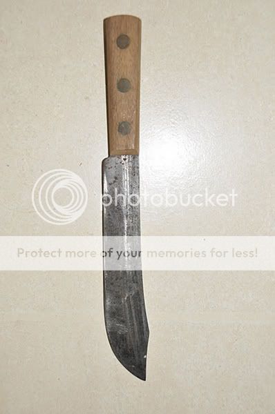

I have the same Forgecraft butcher on the left and one like the style in the center. They were my mom's who had them for no telling how long. I refinished them and still would like to make some kind of sheath for them.
