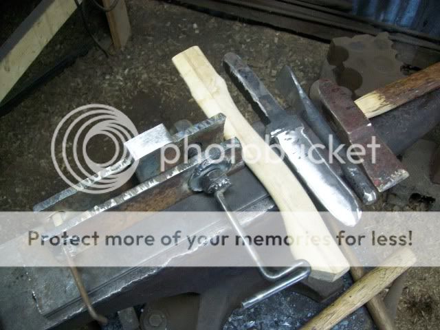

Most of mine is blacksmith related but...

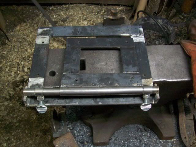

guilliotine tool..
drifting post back before I got my swage blocks.
axe making tools

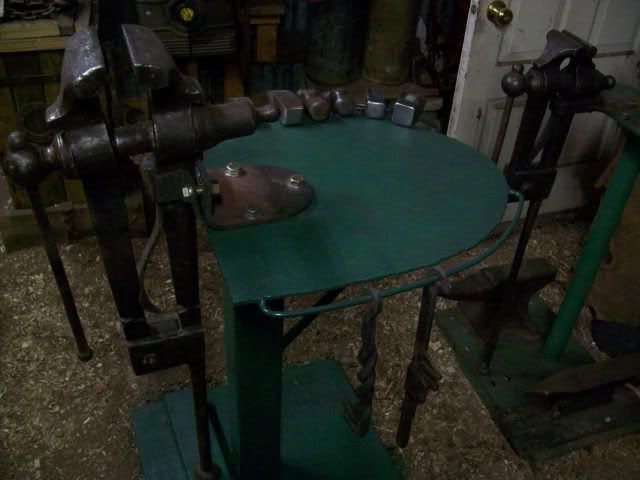

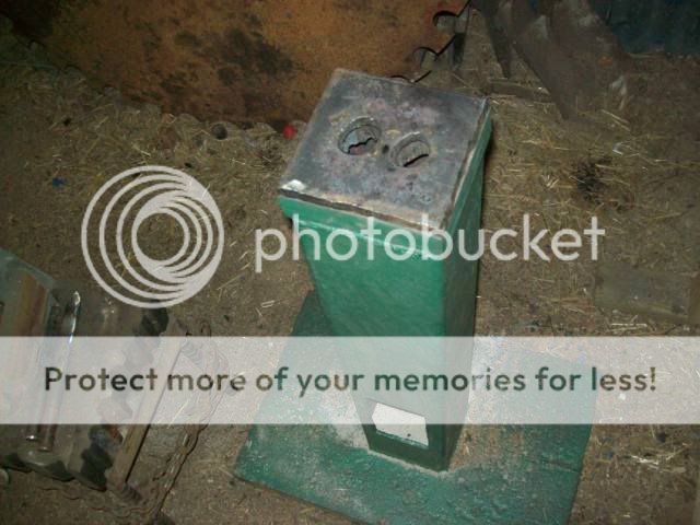

This vise stand(and others)

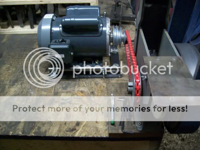

movable motor mount for grinder

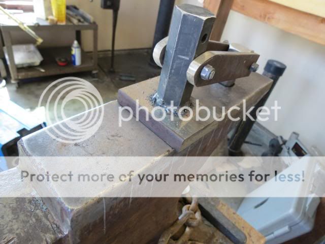

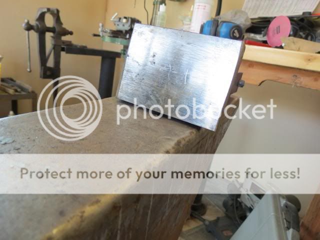

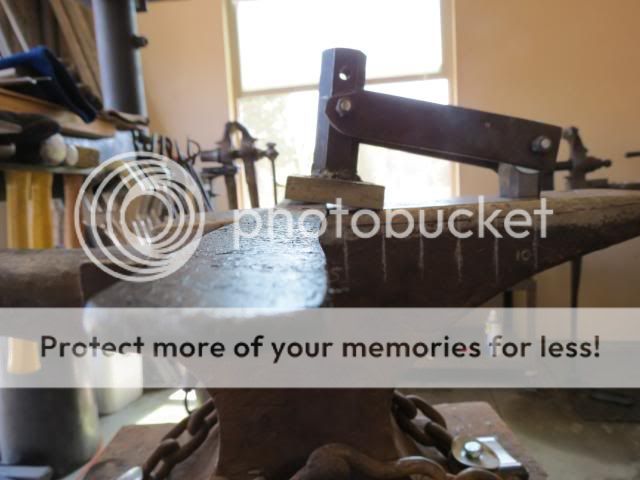

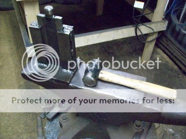

I've always thought flatter hammers were pretty neat, but I never found one in a price range I was willing to pay, plus I never seem to have enough hands to use one. So, I made this to go on my anvil; pivots so it can accommodate angles. If I did it again, I'd make it a bit smaller, but it definitely helps take out some hammer dings (if I was better at forging, I suppose I wouldn't need it...).
Yes....really ugly welding....

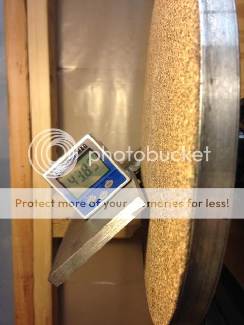

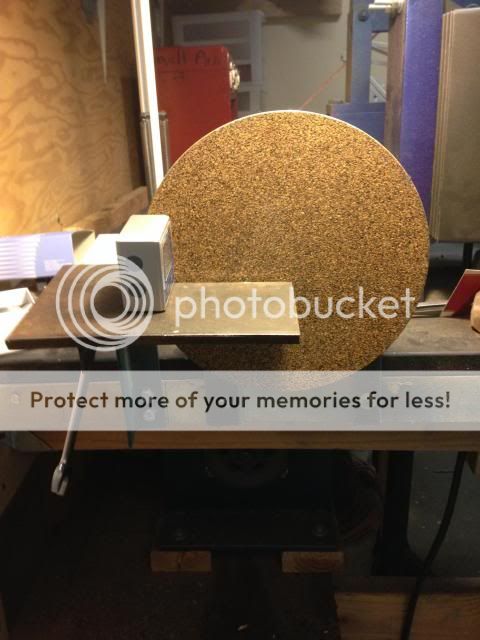

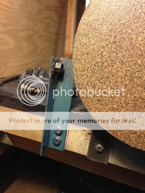

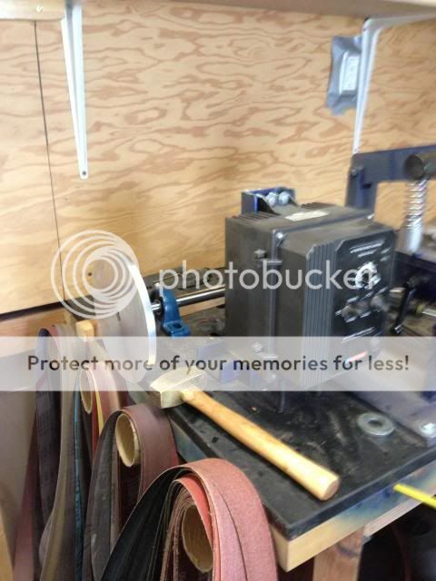

Probably my favorite tool is courtesy of Bruce Bingenheimer. I used a disc grinder for the first time at his shop and stole his idea (thanks Bruce). I have a KMG, too so it all worked out rather well. I bought a longer shaft from MSC (I think) and a friend with a lathe turned the end down to fit the aluminum disc I bought. A pillow block and a few pieces of steel bolted to the end of the bench keep deflection to a minimum. I added a forward/stop/reverse switch to my VFD and now I have a reversible disc grinder, using the same motor and VFD from my 2x72-WAY cheaper than a stand alone setup and saves room in my small "shop". This was an in progress photo (the belts got moved to a new location):
I put on 1/16" cork gasket material to the face of the disc and just recently got an adjustable table put together. I'm hoping this will help me with liner locks and dove tailed bolsters/scales and a few other things. Please ignore the painfully ugly manufacturing...someday maybe I'll upgrade from a flux core wire welder...
