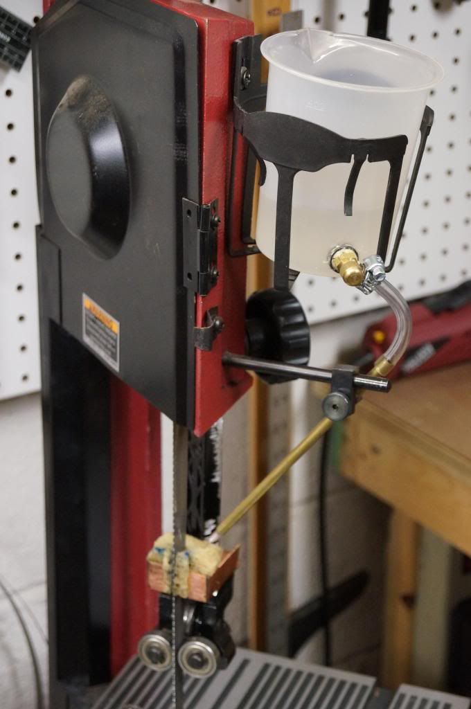

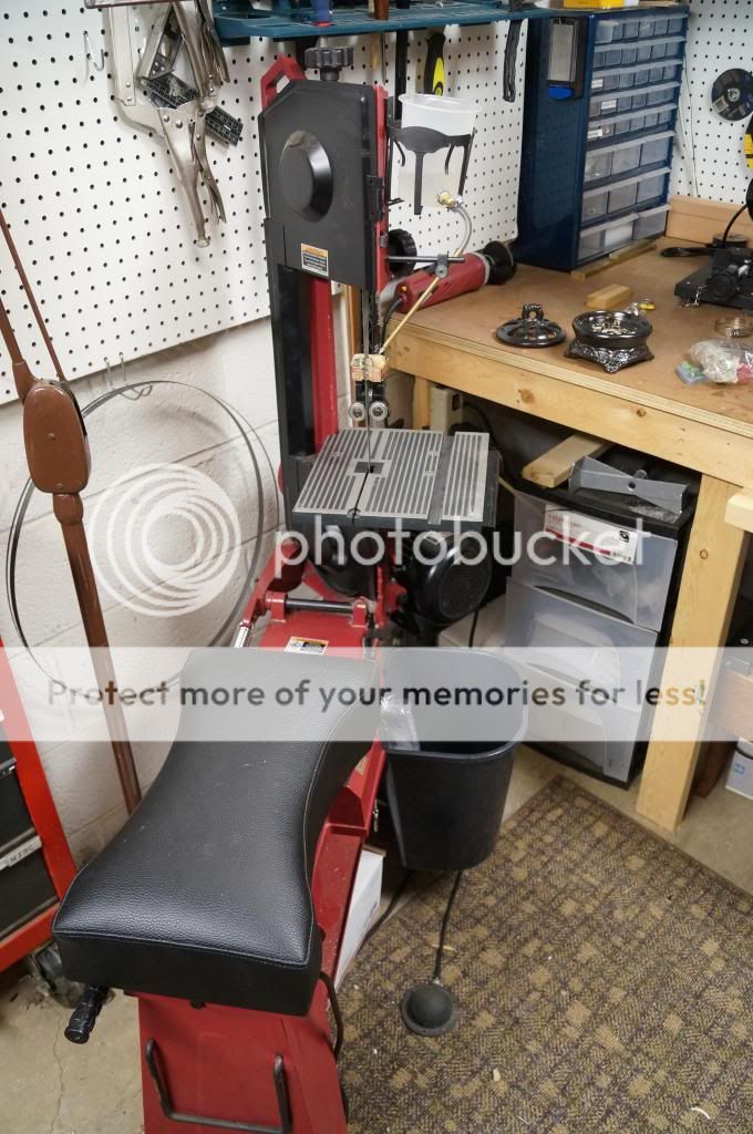

Here are some pictures of modifications I made to my HF band saw.
I removed all the 'horizontal' parts and a friend of mine made the seat, the larger, solid cutting table came from a cheap band saw that bit the dust. The oiling system came from a few aquarium parts, a piece of brass tubing and a copper sponge holder. Power is received through a foot switch for safety. Very much fun to use and it cuts steel like butter. Teddy
@Teddy
That shop is way tooooooooooooooooooooo clean
Corey "synthesist" Gimbel

@Teddy
I agree. Maybe the attention to detail required of a jewelry maker has something to do with it?

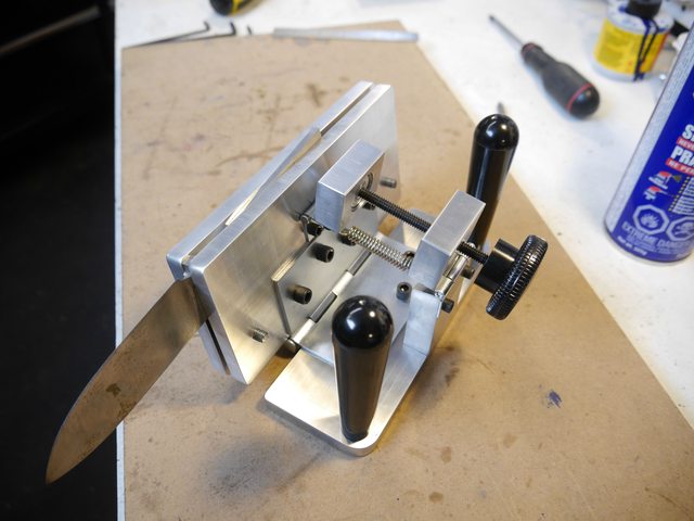

My favourite 'tool' that I've made so far is definitely my grinding jig:
I can grind freehand (though not as cleanly as I'd like) but I find it very stressful. The grinding jig takes the stress out of it for me, and the nature of the adjustment mechanism means that I don't miss much in terms of being able to tweak the grind as I go...
Great idea on that extended shaft/disk grinder attachment for the KMG!
I usually dont use jigs but if you could send that my direction Ill give it a shot :D, that is a cool little guy.

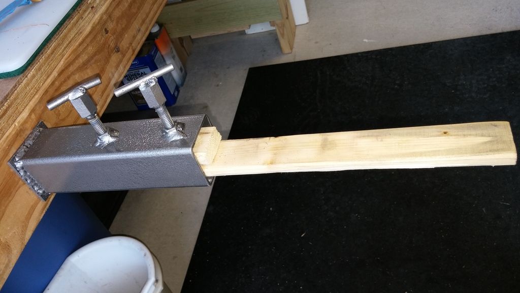

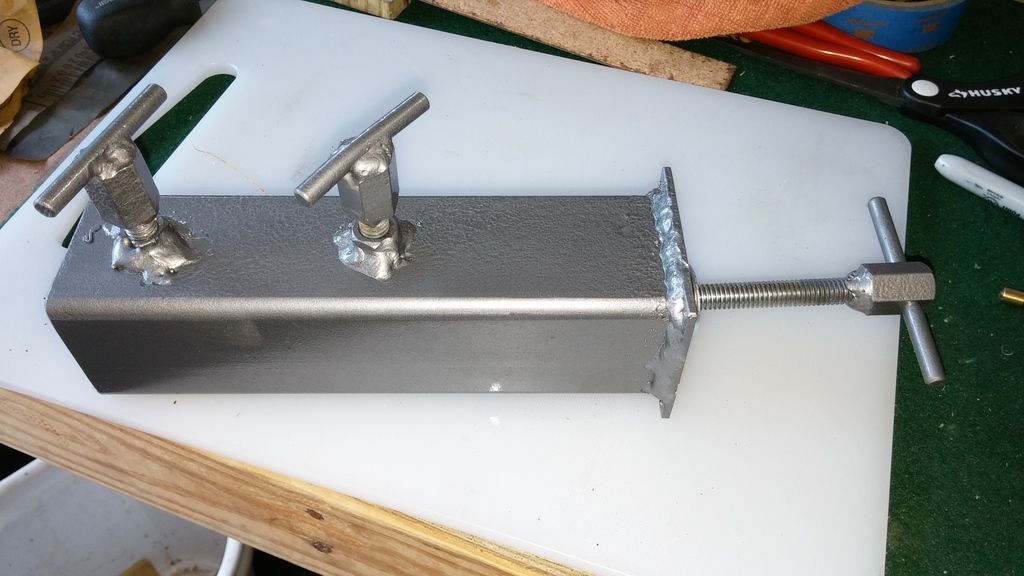

Not an original idea, but I wasn't going to pay $100 for one of these knife vises from the knife supply places. Plus, if I put it on top of my bench it wouldn't be comfy so I wanted something to be at a comfortable working height. This is the first thing I welded up with my Miller 180 230v mig. I purchased the welder back in 2007 for a rat rod project that I had to sell when I split with my live in girlfriend because I wanted to raise money to buy a home.

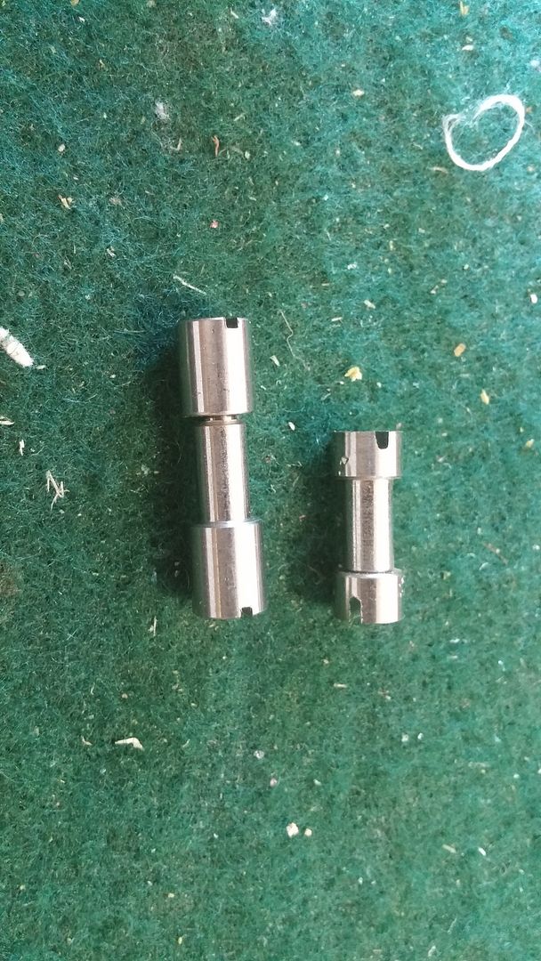

This isn't anything ground breaking, but I like to try to get my scales as close as possible before epoxy so I ground down 2 sets of corbys & put new flat head grooves with my rotary tool & one of the thin stone cutoff style wheels. Now I can get them clamped down tight and not have the heads stick up beyond the surface of the scales so I can get almost all of the shaping done before epoxy. My reason for this is that I've had some scales crack/break, and this allows me to easily replace them if this occurs without having to grind off an epoxied slab. Plus you can get a better idea of what it will look like finished without having clamps in the way.
