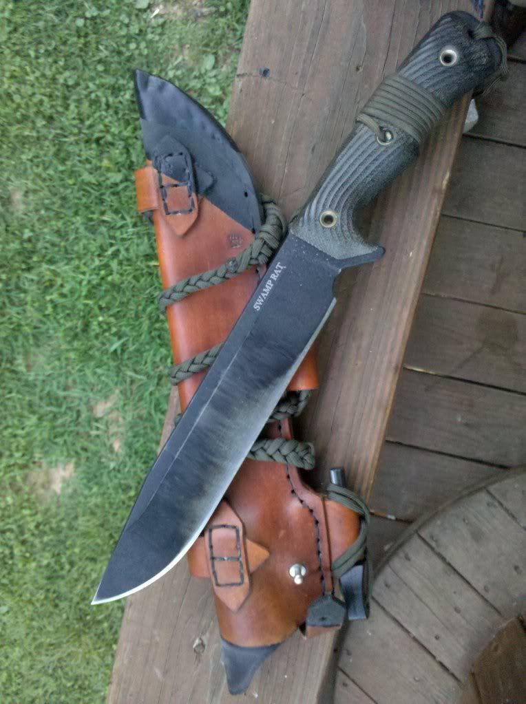

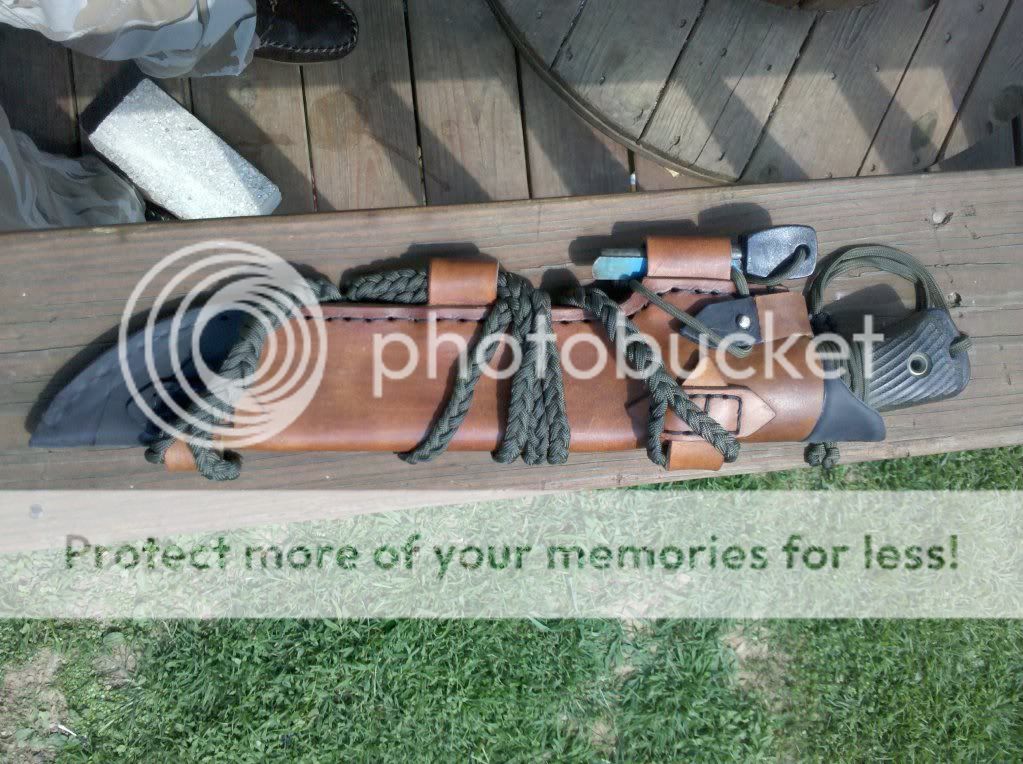

An extremely gracious Friend on the forum, found out I had a little financial difficulty a few months back, and had to sell much of my collection..and I was "chopperless"..so he sent me a brand spanking new Rodent 9...wow, what an awesome and efficient chopper!!! (plan to post a review on it in a few days, Lord willing)..it had no sheath..and I could not afford to buy what I wanted, so I took the opportunity to make my first Sheath from scratch out of some leather I had received in trade, really made me appreciate the exquisite work of the professionals, but I am very pleased for how it suits my needs for the woods.
Also have added about 20ft of 160lb bankline to it, since these pics, and hopefully will get them up tomorrow..Thank you W&SS members, most of the ideas implemented on this, came from seeing yours through the years, and discussions for what you like best for the woods..can't wait to see yours!!!
nasty, the OP asked for "homemade" stuff and I guess yours qualifies but what really jumped out at me was the fire steel attachement on your rig. I never considered a hard mount but this makes perfect sense. cant loose it (even better than with elastic band holddown) and a bigger handle to boot. I might borrow this technique but will remember to give you the asterick/footnote recognition! Afraid my skillset leans toward cardboard and duct tape.

Schmit..how did you do the pouch for your stone??? :confused: I could not for the life of me, figure out how to add one without forming the pouch by guessework..held me up for a few days before I finally just gave up for now...please, do tell.

For the pouch, I wet molded and clamped it around a sharpening stone, one the size I wanted. I do not use the stone with this kit though. I made a mini strop just for this setup. The pouch is far from perfect, but useable.
Thanks Barrabas...standard kydex directions...get it to 350 or so, let it set until soft, fold it around the knife, clamp it down between foam.
The interesting part to me was figuring out how to attach my minimum kit to it.

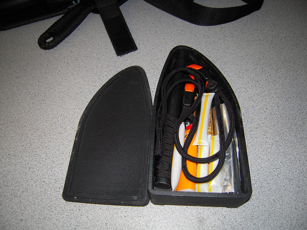

Here's a sheath I made for my Wohlwend Bushcrafter with an EESE pouch & contents.
And for my JK Hudson Bay XL I used inner tube bands to hold the gear on & wrapped it all with paracord.
Here's my BK2 sheath I put together last year-ish.
Drop leg setup with thigh strap.
In the box is a firesteel (.5"x5") some firestraws, a piece of fatwood, some water purification tabs, a lighter, a knife lanyard, stormproof matches. Had room for more but that was what was in it at that point.
The strappy belt part was modified to hold a fresnel lens, ez lap diamond sharpening card, and a plastic card with some ground to air signals on it that I had printed up. Behind the sheath proper is a holder for the allen wrench needed for the handle scales. And there was also a BK14 attached to the back for small knife work.
