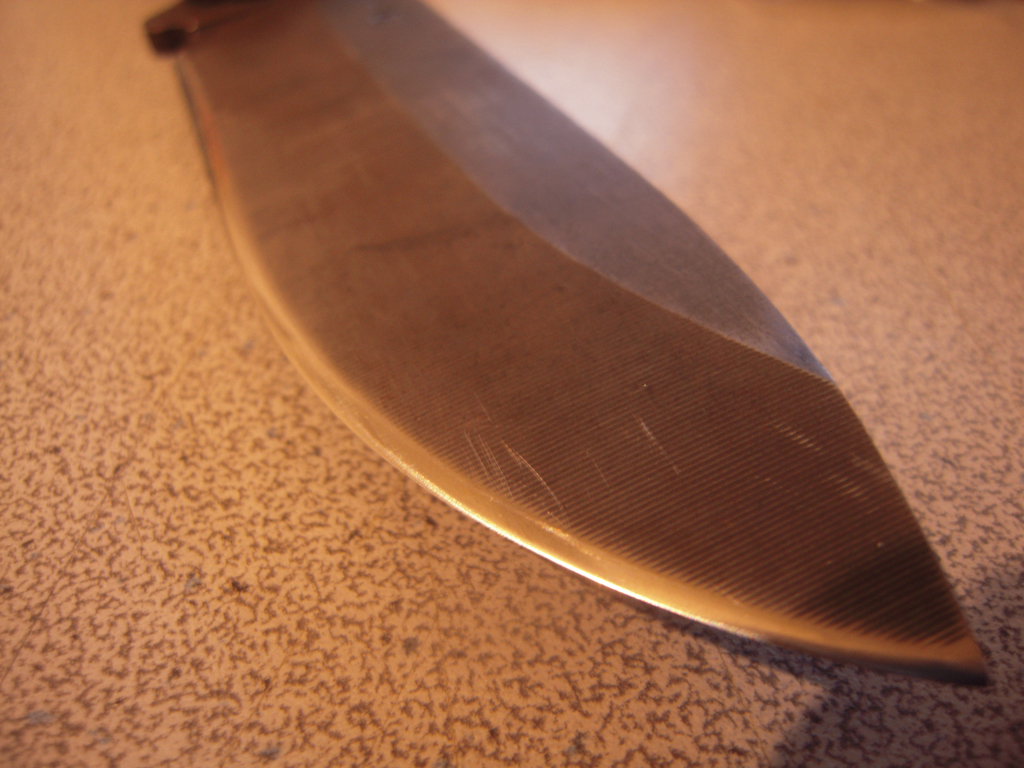

Sorry for my poor photography skills--- my bk 14 edge done on the kME with a back bevel of 34 inclusive and micro bevel of 44 inclusive finished with a black ultra fine Arkansas stone and knivesplus strop block with green compound for a semi polished bevel:

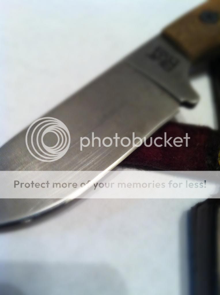

My 16 with 40° inclusive convex edge stropped with white / green compound, not mirror polished or anything, but it's pretty sharp. :p

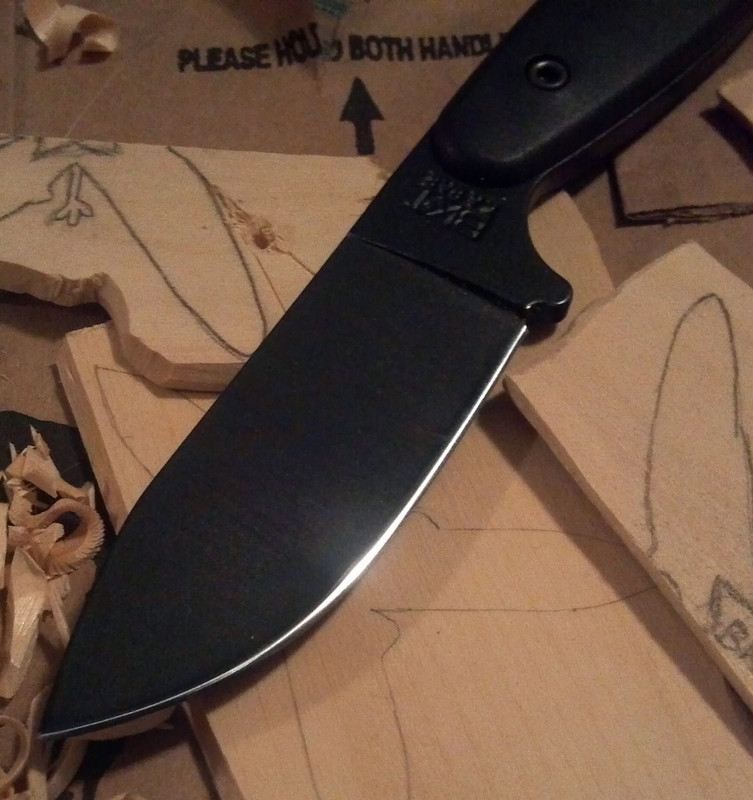

BK14 from the snowflake carving challenge. I used a 3000 grit Naniwa water stone to bring that baby to a nice mirror shine. It could be sharper, but it looks great.

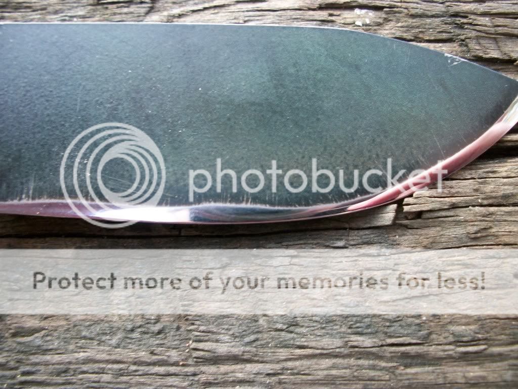

My first convexing attempt on a BK14 using a mousepad w/ 150 > 220 > 400 > 600 > 1000 > 2000 grit then some stropping. Have since added the Izula scales and loving this blade.
^^^^^that is a well loved beauty right there! Convex on that, or just free hand?
Both those are polished convex :) the 14 is a great little knife, the convex suits it well.
