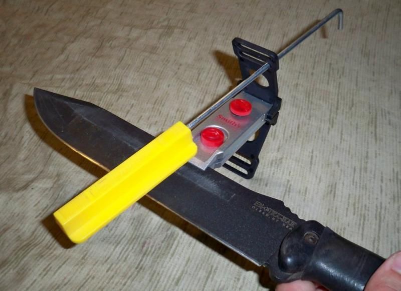

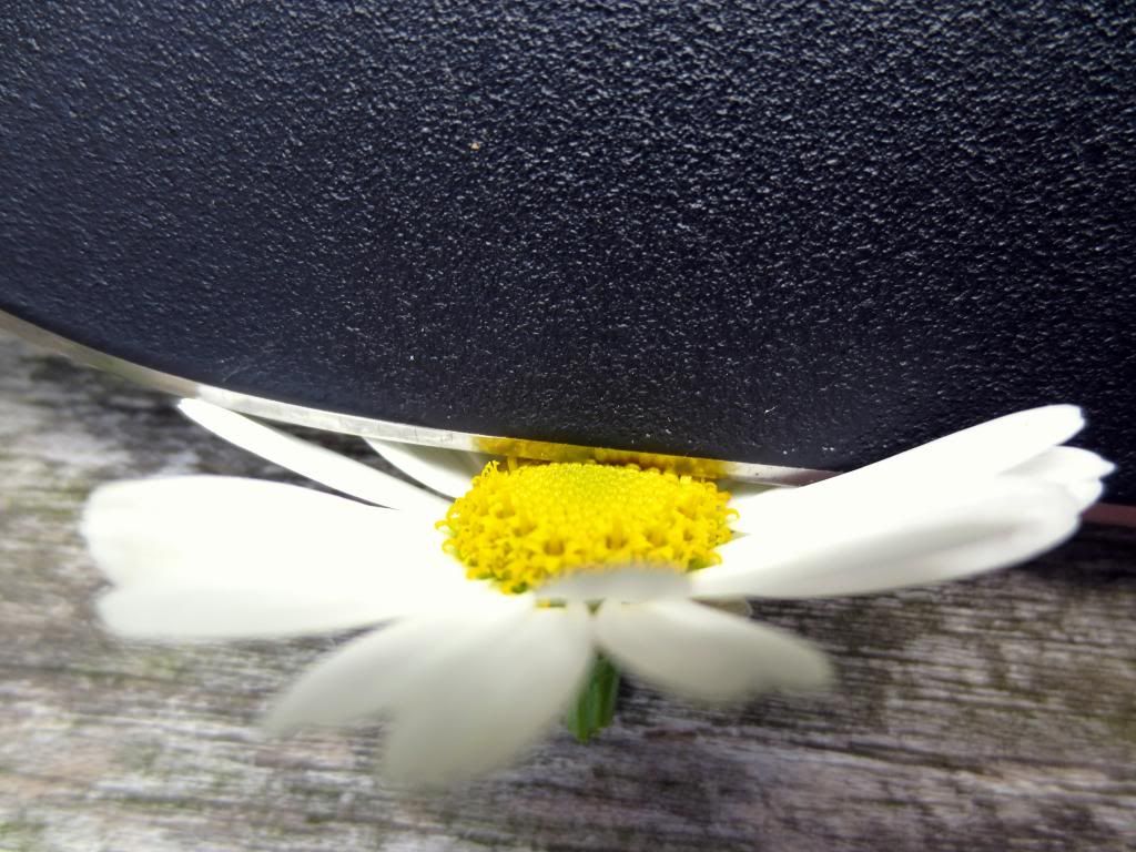

This week I really got to know my KME Sharpening system and was most impressed not only with what it can do, but also how it does it.
My sharpening session gave me an idea for this contest, which will award a BK-2 to one hair-splitting Becker owner.
The idea is to show off your best Becker Edge and what it can do.
Some ground rules:
  • The knife you sharpen must be a Becker knife, whether it's Cincinnati, Blackjack, Camillus, or Ka-Bar.
  • You must do the sharpening yourself and not outsource it.
  • Three pictures are required.
  1. Picture of how you sharpened the knife. Stones, systems, strops, mechanical devices, whatever.
  2. Picture of the edge, hopefully better than mine above. My cell phone kept focusing on the blade and not the edge.
  3. Picture of what it will do. Shave arm hair, shave your face, shave GUNYON into your chest, split a hair, slice paper, make a featherstick, split an atom, shave Ethan's face onto the side of llama, whatever.
That's it. One entry per person. Please keep chatting to a minimum. We'll run this one till July 4 (two weeks). Have at it.

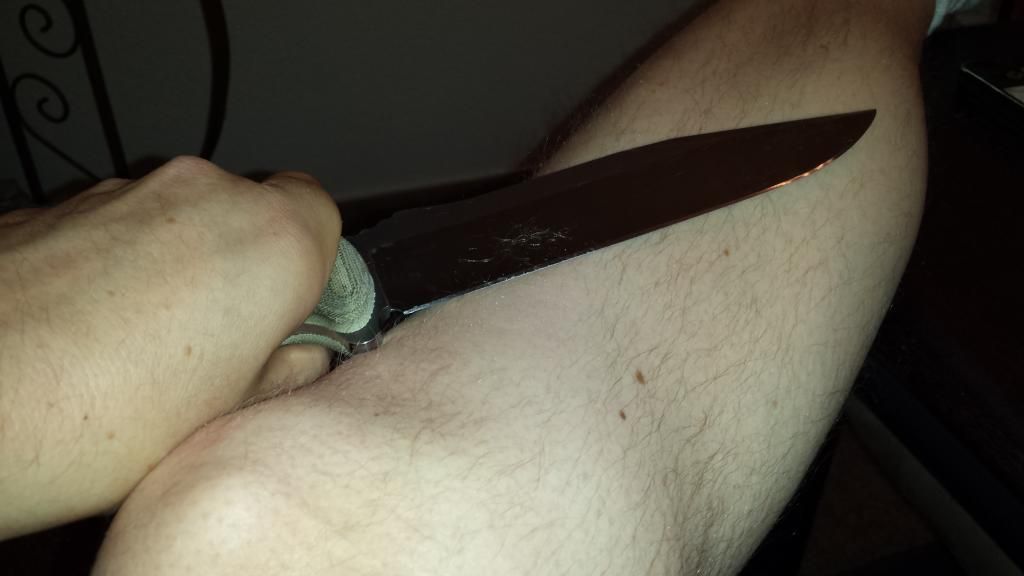

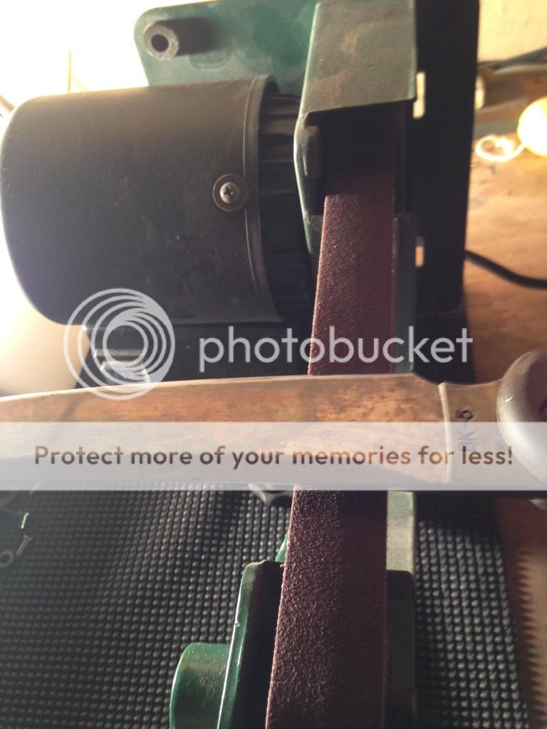

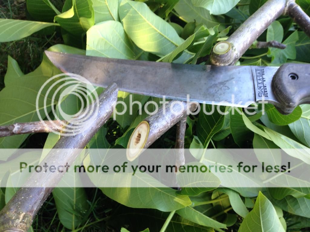

Fisked my BK5 on my HF 1x30 belt sander with 120 grit.
Mouse pad and sandpaper. 320, 400, 600. (Because that's what I had).
Brought to a mirror polish on a strop loaded with Mother's Mag Polish.

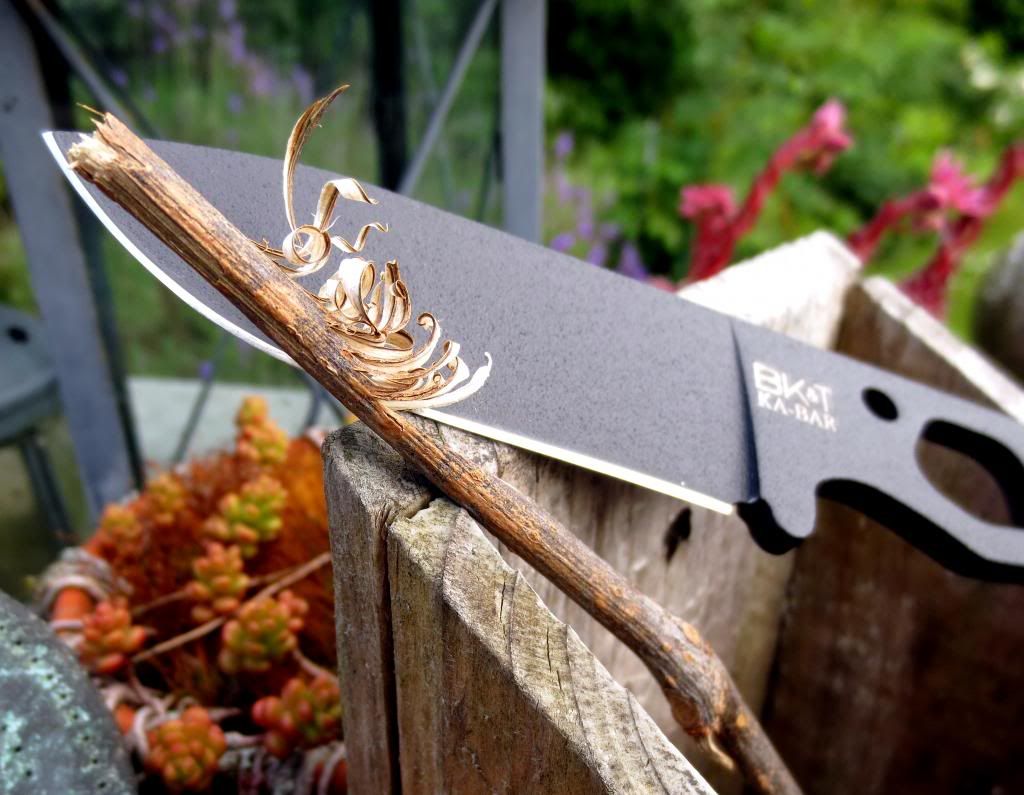

Those branches are English Walnut. The Magnum Camp slices through some thick stuff like butter!
Thanks for the cool contest Gunyon. :thumbup:

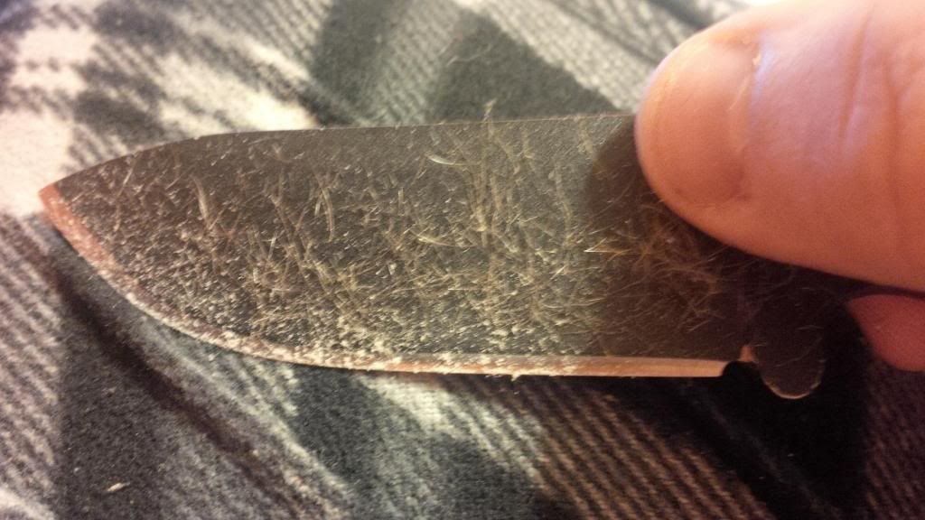

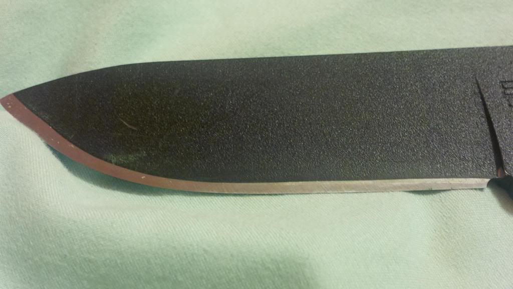

I'm in!!!! Thanks soooo Much!!!
The edge doesn't look like much, but it is very sharp. Pointy did sharpen this at the Gathering, but since then I've re-profiled it, this is entirely my edge.
The edge was put on this BK16 with some 600 grit sandpaper, and I leather strop with two different compounds.
Easily feathers Receipt paper:
Top left-hand corner:
Another one:

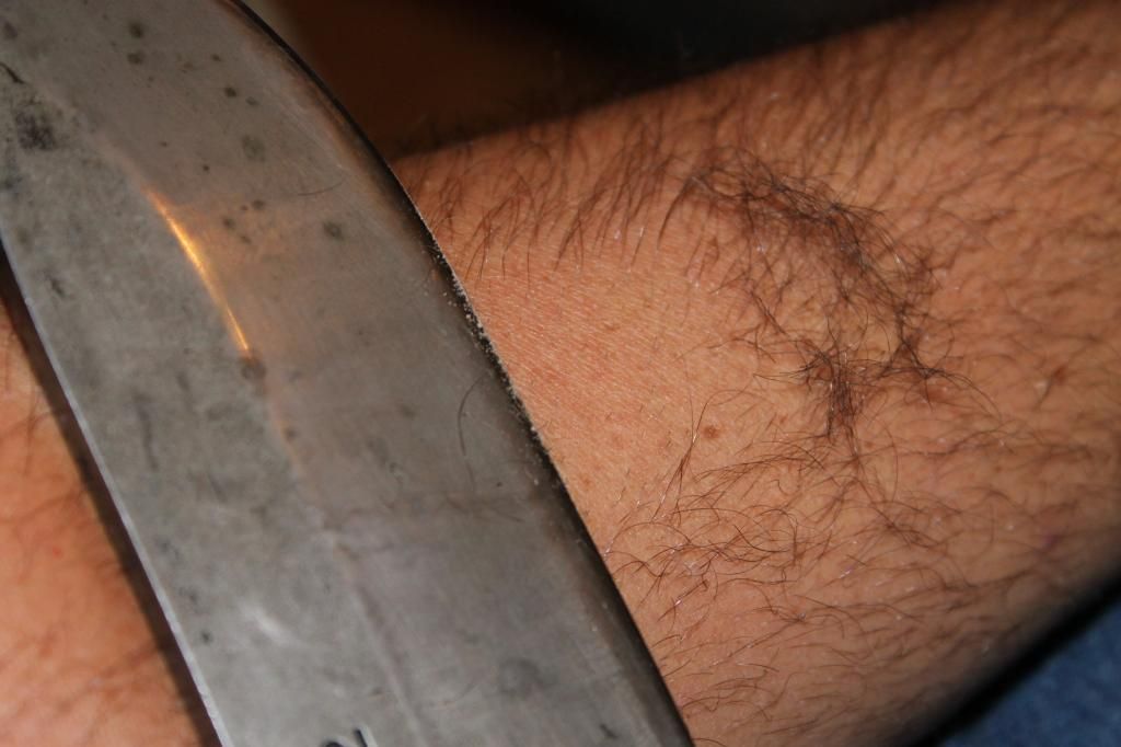

And it easily shaves arm hair:
Thanks so much!

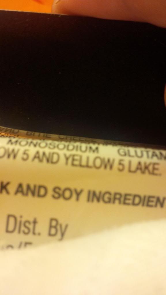

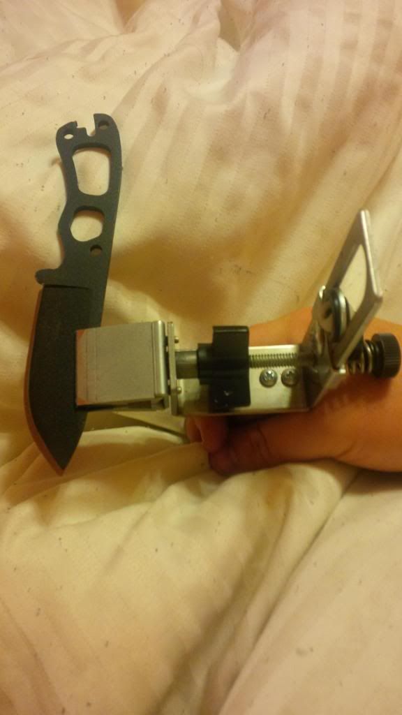

Alright so this is my SHARPEST knife... EVER! It's a Camillus BK-11.
I use this as a slicey cutter which this excels at.
I'm editing my entry to give you what you actually asked for... Sorta... I don't think you actually asked for this but I'm editing it in anyway...
It will single pass shave hairs off my arm
What I did was used my KME and I took it to the lowest setting on it. Which is a 17° per side. It will single pass shave hairs off my arm no problem, it will shave hairs off my face, but the most impressive thing about it's edge to me, was when Ethan borrowed it to cut a burger in half and looked at me afterwards with this look on his face and handed it back and said "You turned that into a goddamn laser!"
That was the highest praise I could ever get on an edge to me.

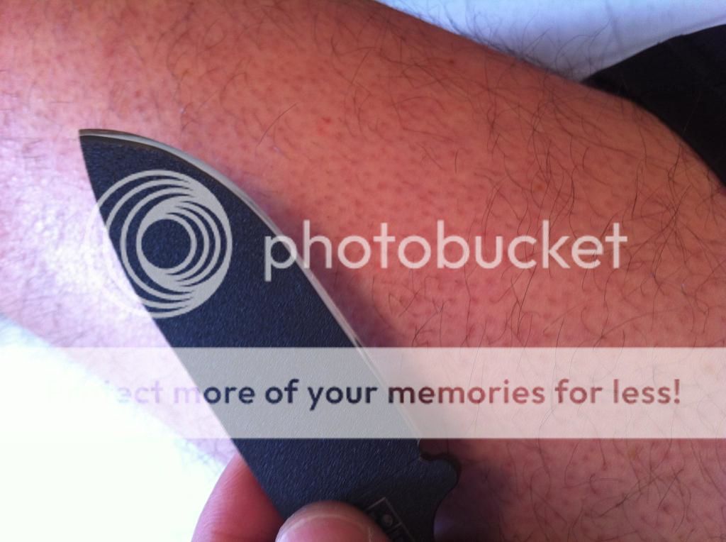

Okay I'm in.
Here's the system/setup I use
Here's a close up of the edge itself
And here's what it'll shave

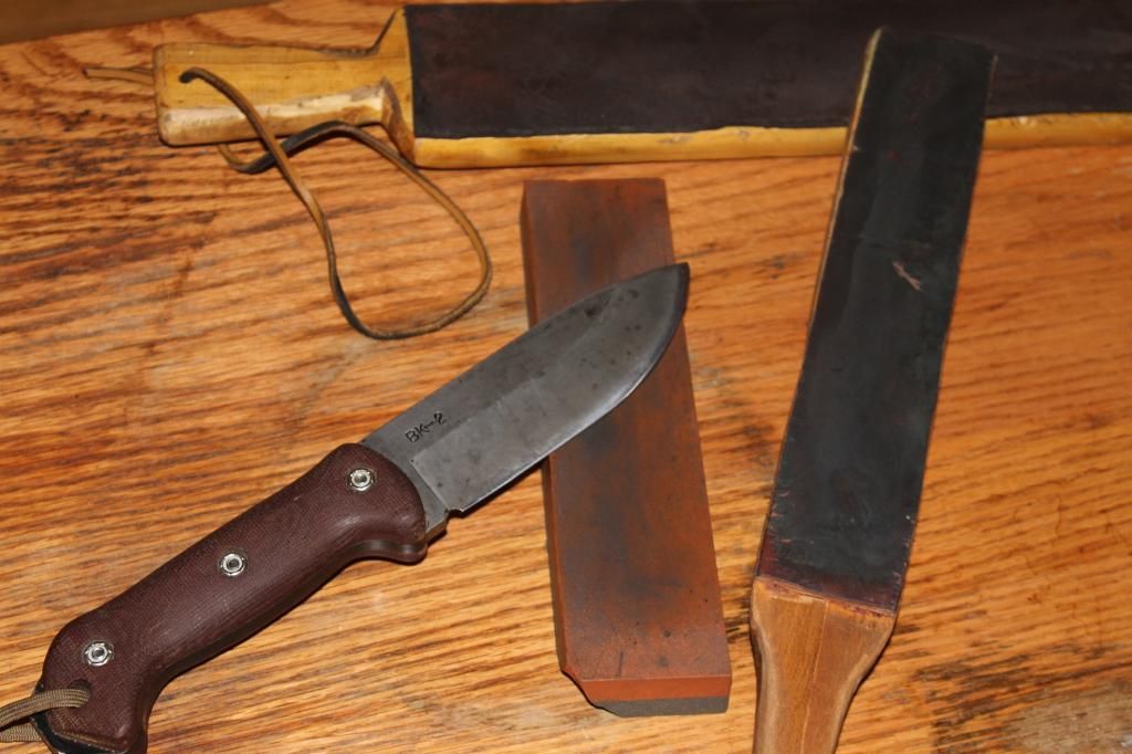

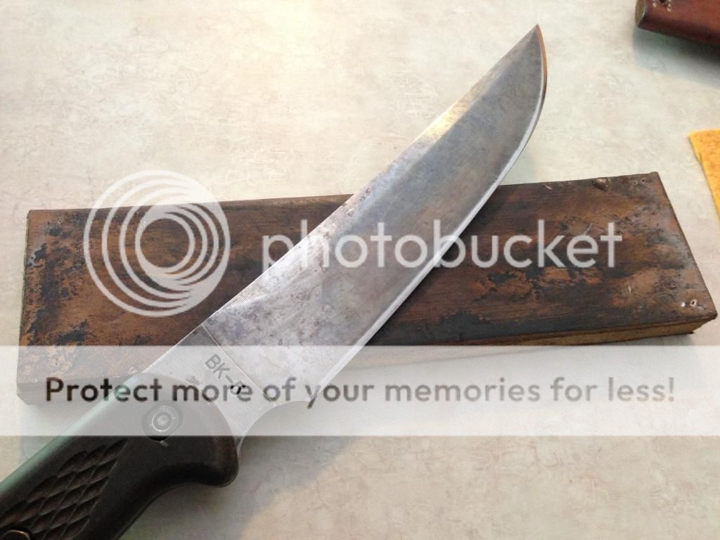

My BK2 has a convex edge that is stupid sharp for that thick of a knife. When it was new I used sandpaper and a mouse pad to get the convex ever since then its just the Norton fine and strops. It is a laser

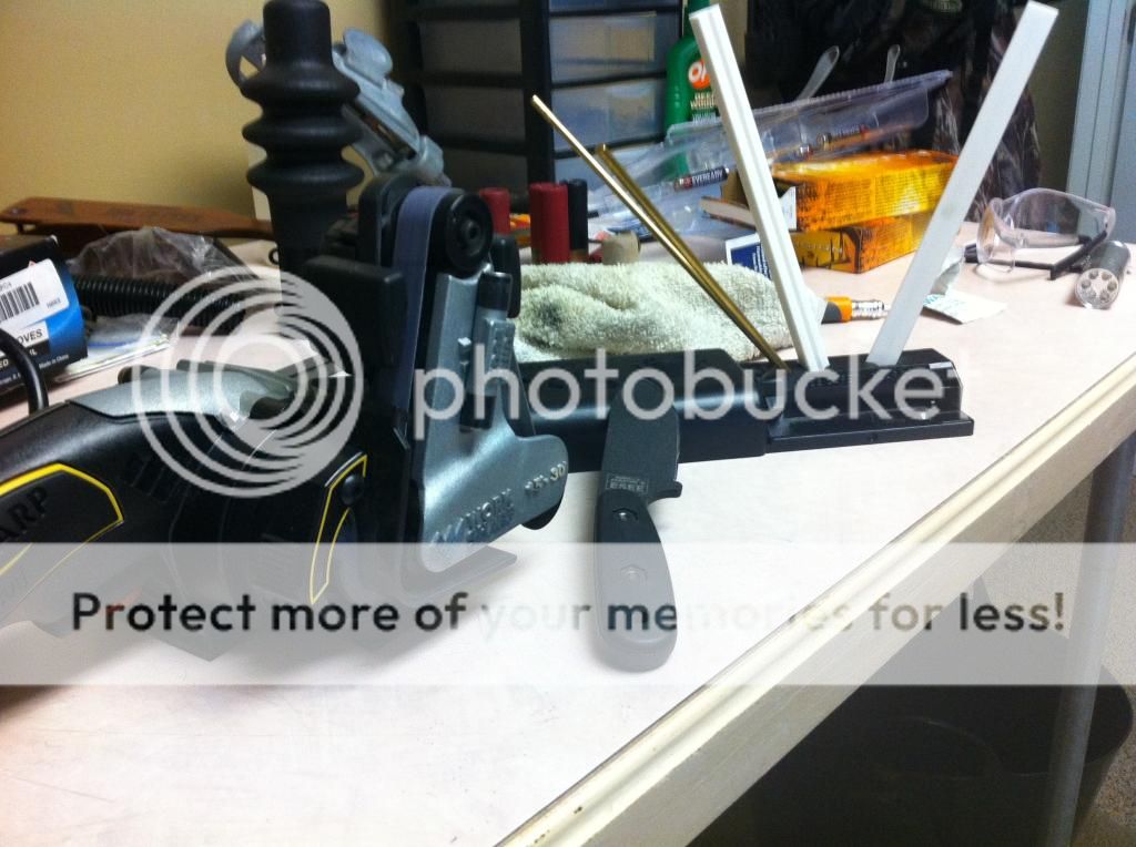

I've never had much in the way of sharpening tools. However, for Father's Day, I received a Ken Onion-edition Worksharp. I like it, but also use the fine rods in my Sharpmaker to supplement.
Here is a shot of my BK14, much in need of a sharpening from use. Also, the tools I used on it. Forgive my bench - it's a mess.
Here's the 20-degree finished edge, the best I can show with my phone.
Its nice and will shave very well. I like the edge I'm able to obtain with the WSKO.
