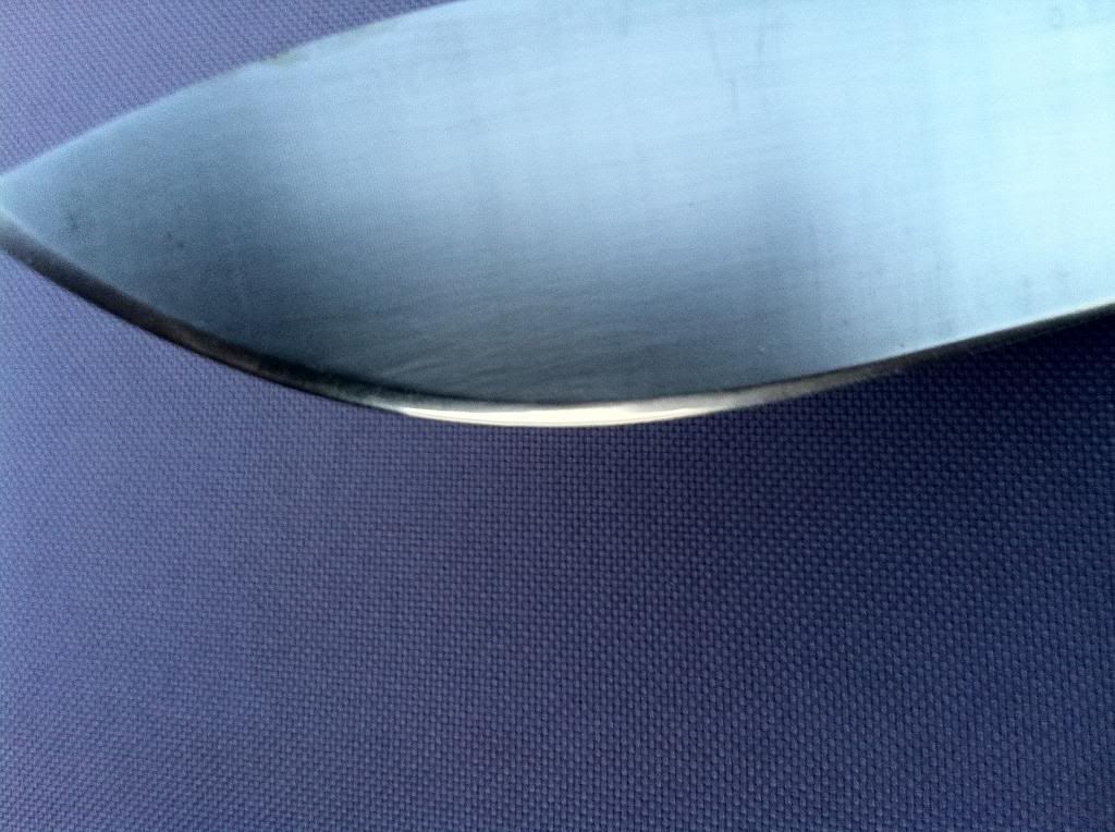

after having fun removing steel from this 11 and adding a patina, I finished it with some worn diamond stones and a homemade strop loaded with black compound. It was further refined by my regular 2-belt barber strop loaded with black compound on the leather belt and white compound on the nylon belt. It shaves, curls fuzzies and grins back at me

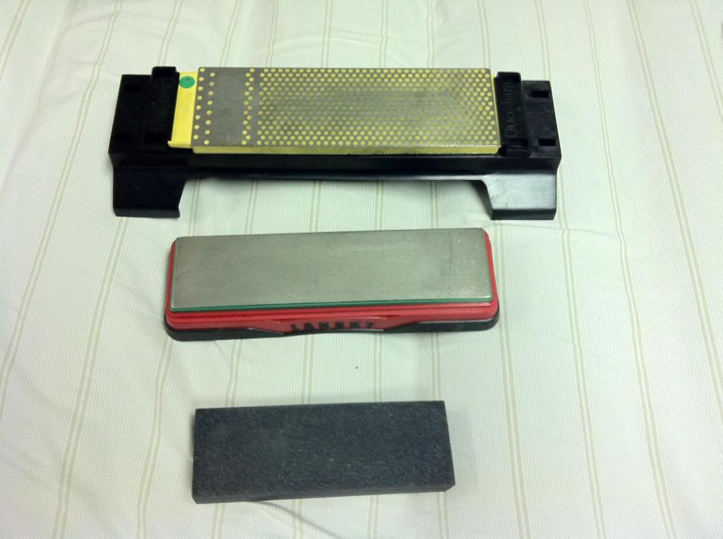

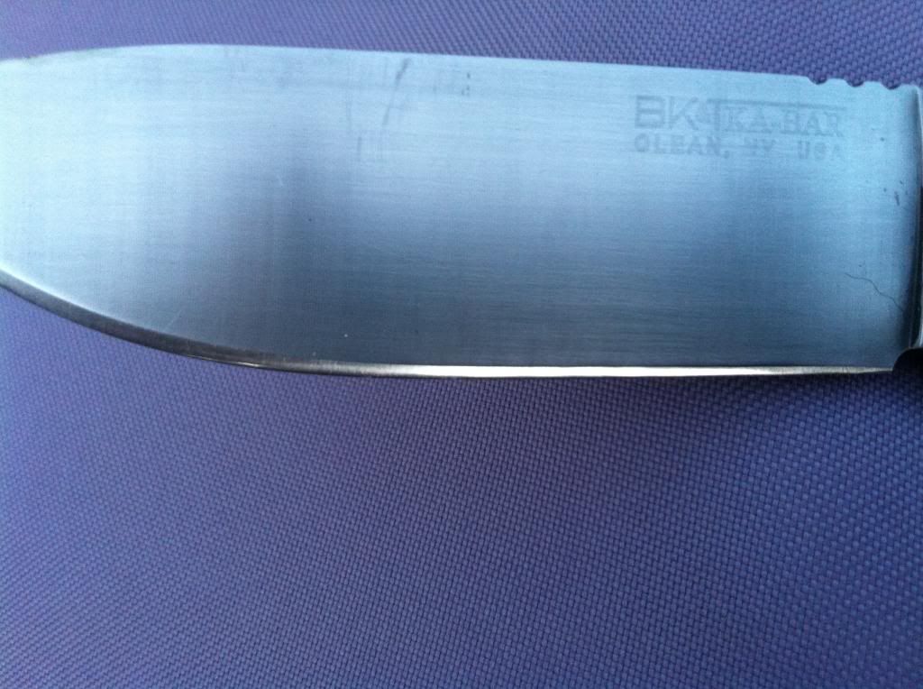

I sharpened the BK10 this evening on my Tri-hone, with the help of a little 600 grit sandpaper and as leather scrap used as a strop.
Note the old bottle of Ka-Bar honing oil. A friend gave it to me from his late grandfather's shop.
After a stropping it was good to go. I tried my best to get a good one of the edge, but it's no slouch. :( I'll try again in the sunlight and edit one in if I can scrounge up a better one with my phone. Hopefully these pics give you an idea about it though.

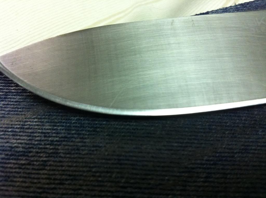

I recently became obsessed with convex edges. So I picked up a series of belts for my 1 x 30 all the way up to 9 micron and a leather honing belt. I chose my BK-7 partly because I don't give it the time it deserves. I wanted to make it scary sharp. I did this last weekend on full sunlight and went slow so hopefully I wouldn't mess up.
Here is the edge before. Pretty much the factory edge. Lots of grind marks.
I removed the lanyard and put on some safety glasses and went to work. Notice the bucket of water to dip the blade in to keep it cool after pretty much every pass on the belt. Before the blade touched the belt it was dried by a micro fiber towel. Slow but safe.
After to first belt the edge is looking better.
I switched belts and got after it again.
Getting better.

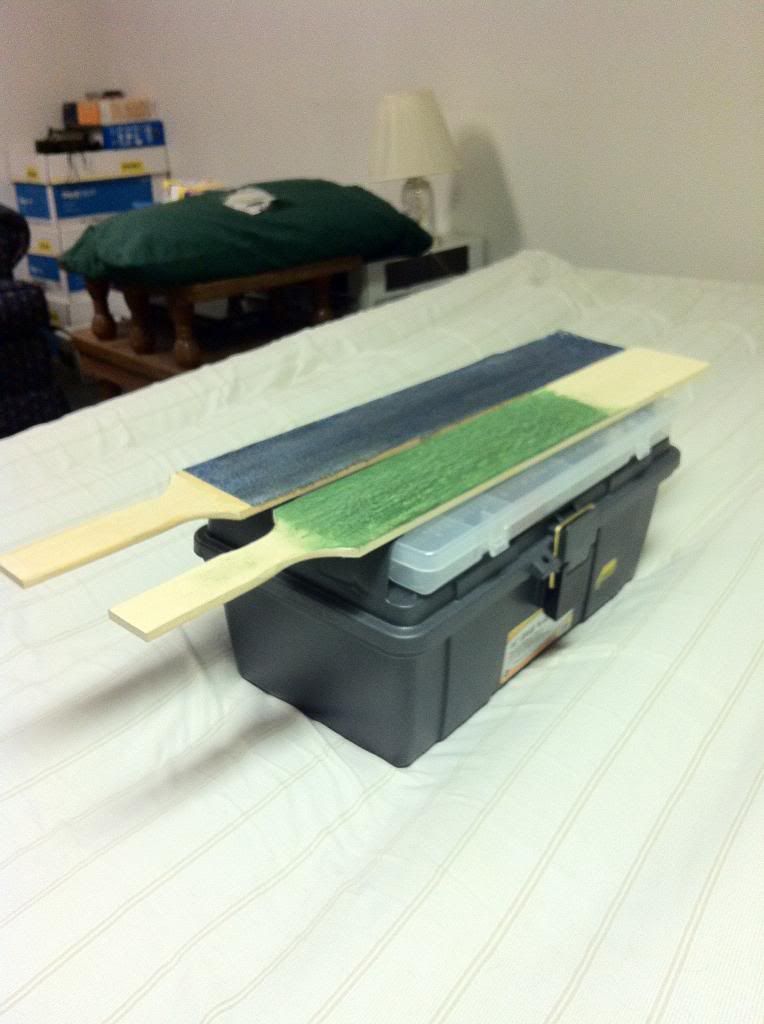

After that I went to the leather belt with green compound on it. I am in love with this way of stropping.
Look at it shine now!
Reflection in the edge.

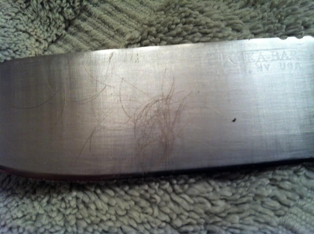

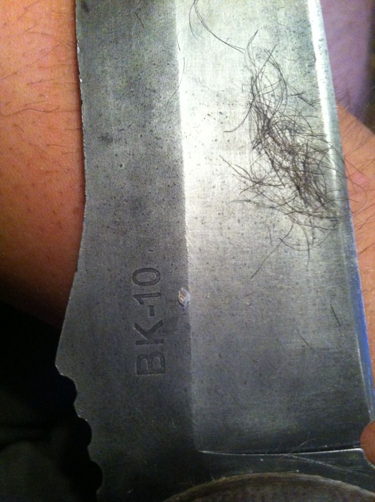

Of course it easily shaves and whittles hair.

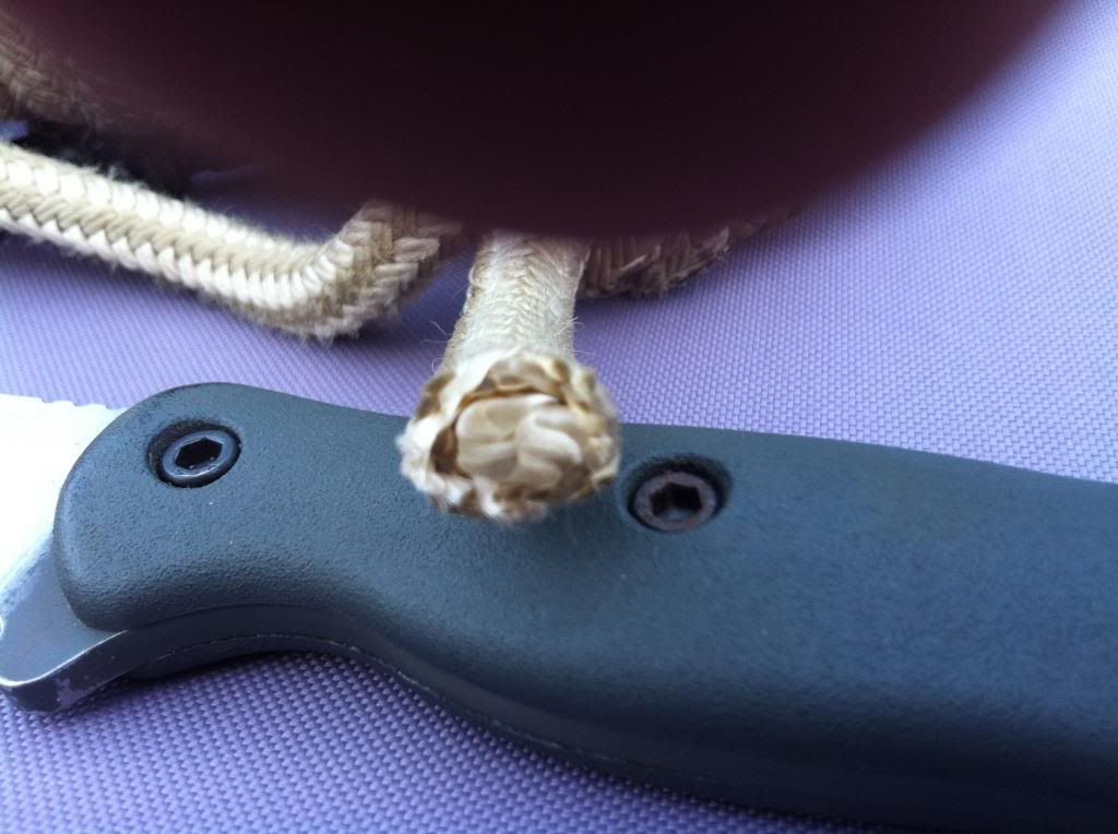

It goes through computer paper very easy.

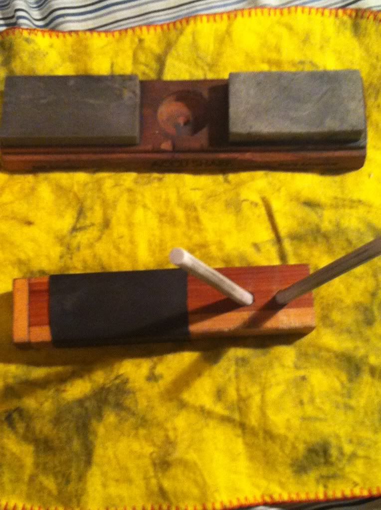

The tools I use, hard and soft Arkansas, ceramic rods, and WD-40
This is my 10 shaving hair, I put hardly any pressure with the knife
The edge after
All of the tools, homemade strops and an assortment of stones. All free hand sharpening these days.

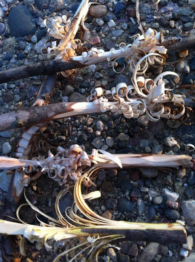

The BK16 was chosen for this project.

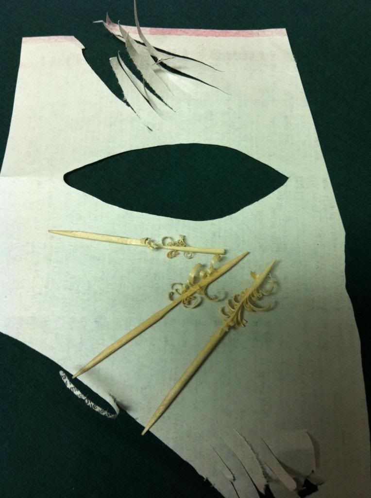

She'll push cut phonebook paper, cut circles in a fold and feather.

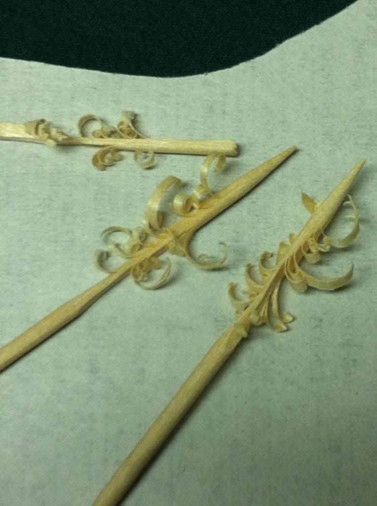

Feather sticks, no problem.
Even little ones were not a challenge

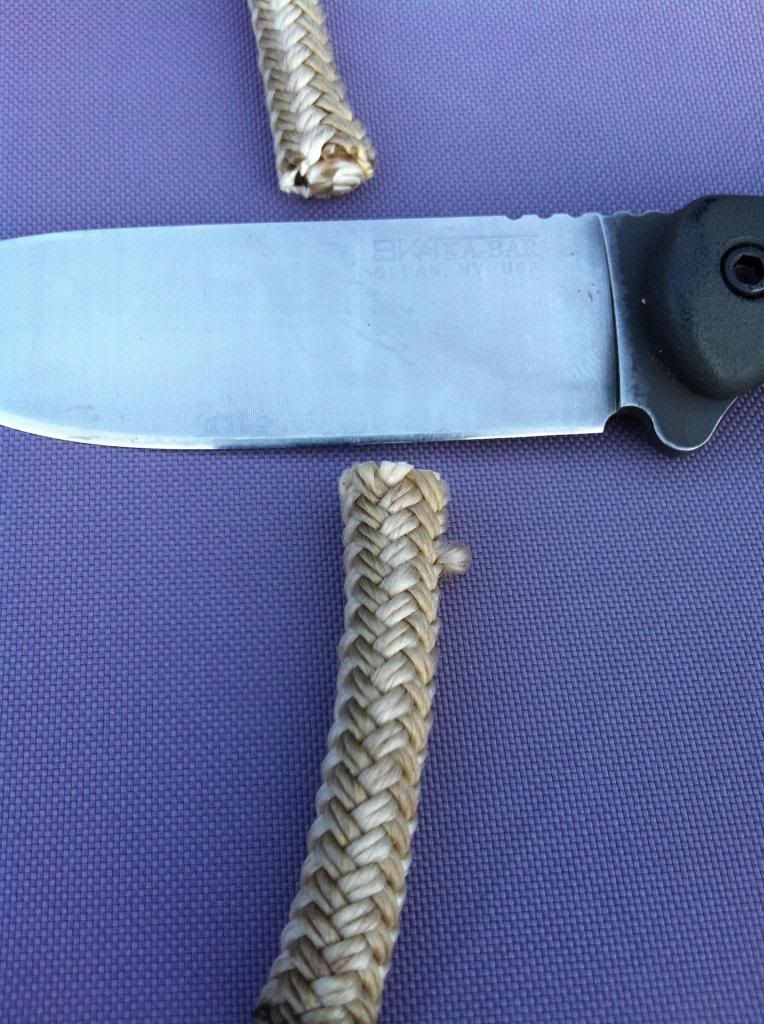

Push cut 3/8 rope with ease.
Can even be used as an axe if one is not handy, just add a club and you're in business.
Oh and it will shave too.

Mouse pad and sandpaper. 320, 400, 600. (Because that's what I had).
Brought to a mirror polish on a strop loaded with Mother's Mag Polish.
