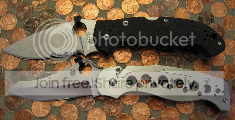

Okay, here are a couple I did. That should convice you not to try it :D
(Kidding. If I can do it, anyone can. Probably better...)
Nice touch on the Ladybug. In another thread, I almost made a sarcastic comment about the new version not having a wave. :) Although with that tiny opener hole, it probably needs it more than any other model.
Both of those Natives look really cool with the modifications.
Thank you. I had seen pictures of a waved Ladybug on one of the forums and thought "That is just TOO cool! I gotta have one." So I found a used beater on the Bay, got it for about $10 shipped, and went to work. The hardest part was making the clip.
