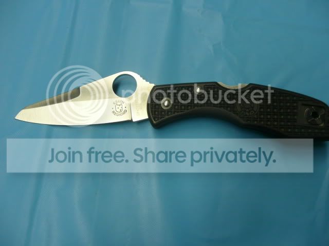

Here are some from Tom, once upon a time ago. I no longer have any myself, but mine here were the BM-42, Spyderco Jess Horn, and the CQC-12. I too am interested in who else is doing them now-a-days.
This is a Benchmade 635 mini-skirmish with the recurve ground straight & flat ground by TK.This is the last regrind I have left from Tom.It's in my pocket more than any other knife I own.

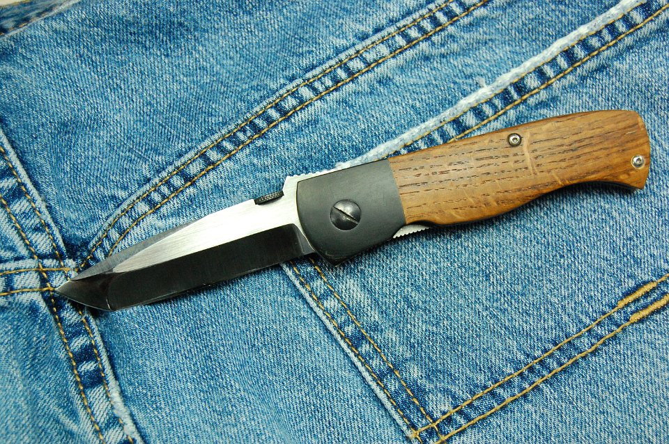

Emerson cqc-7 with English Oak / Micarta scales and American Spanto regrind by Phillip Dobson.
