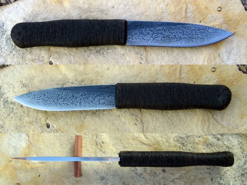

Magnussen - I really like the first blade in your photos which is next to the key board with the paracord handle. Can you share the specs (what steel, OAL length, blade length, blade width and thickness, and edge profile)?

Well...like a dummy I forgot to add in the specs, and since I don't have it on hand at the moment I can not accurately give them to you now. But it is basically the same knife as in this thread but with a different handle. You can still get some perspective of it though.
http://www.bladeforums.com/forums/showthread.php?t=620052
I'm thinking it is about 9 inches over all, 4.5" blade, 4.5" handle, 1/8 W1 steel, about an inch wide. I bought it for my daughter nearly two years ago so I really don't remember for sure off of the top of my head. I'm sure Rick can give you more accurate specs at the moment :) Pardon the pics, they were taken with an old vivitar camera so they aren't so great.
:thumbup:that is one of the best looking knives ive seen lately
