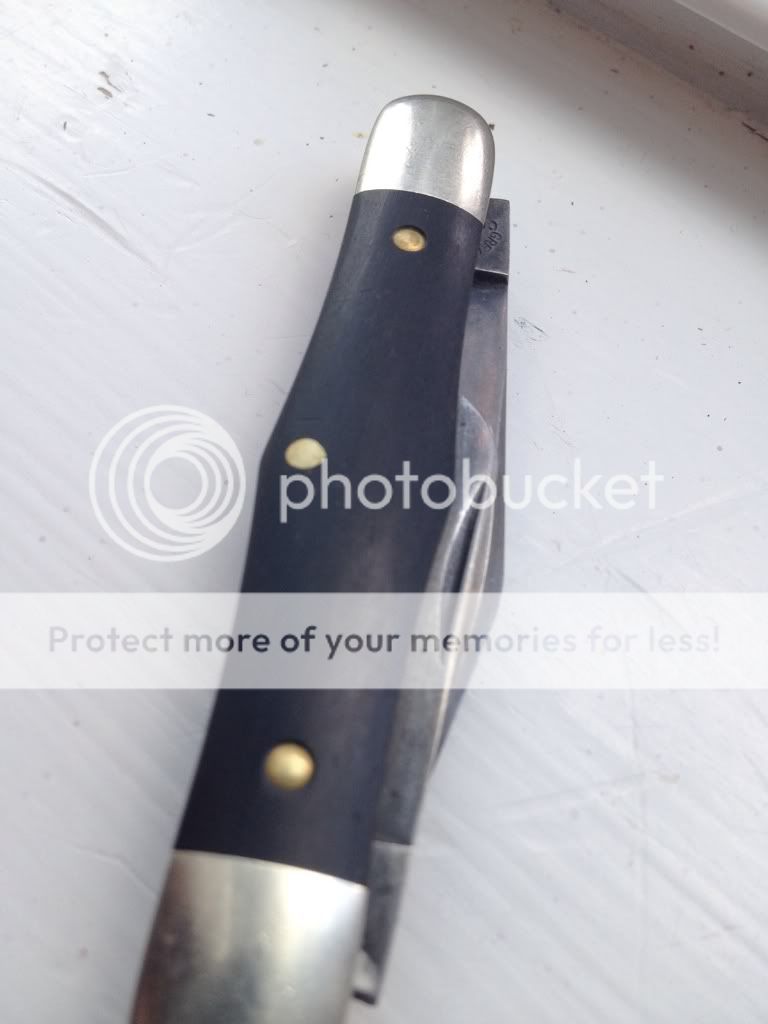

I've had this Buffalo handled Ablett for a few years. I posted in a thread a while back about fixing a crack with with high impact superglue.
That has not worked. I'm just wondering if anyone has a solution to this warping problem.I can get my thumbnail under here now and thats not good.

I pasted this over from another thread.Since then I used a hypodermic needle and syringe to inject twopack epoxy under the offending scale.
It was not easy. The scale has bent /lifted/warped/curled away from the pin IMO severely.The repair seems to be holding up so far.As this knife has never been a regular user I point my finger at
improperly cured /stabilised buffalo horn.
cheers.
Its my understanding from a good friend and blade smith (who made my sword) that you cannot stabilize buffalo horn...it is what it is and is best used on fixed blades rather than thin slabs or like bull horn and other similar materials it will warp. IIRC you can mold horn under high heat but you'd likely need to remove the scale to do that.
Well that is interesting.I guess I owe Ablett an apology for castigating his buffalo.Makes sense though. With that in mind I would probably get acrylic over buffalo horn from now on.Perhaps they need to leave the horn lying around for years before using it-green horn is a term of derision is it not?

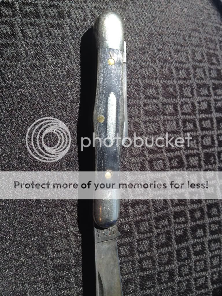

No washing machine and it's only like that on one side. Here is a quick pic of the other side. I soaked the knife overnight in 3n1 with no long lasting luck. I have carried it with change and a peanut in the same pocket for about six months religiously.
Try an application of Lemon Oil, leave 20 mins and buff it off. Might help a bit.
Meako's point about 'greenhorn' is apt. The curing of horn in former days was complex, apparently, and it is an art which may have been lost. Otherwise, why do century old horn knives look reasonable when many contemporary horn knives often show shrink/warp? The animal bearers of those horns won't have changed radically in structure in a 100 years.

Keith, humidity plays a key role. Here in Scandinavia, it's very dry and hot indoors during long winters.(less than 20% humidity!) some of my knives display drawback from the scales, come summer with humidity over 40% they all perk up greatly, stag shows this, woods too.
Another thinking aloud about horn. I've noticed on a horn Opinel and a horn Italian knife (shadow) that these knives show no problems, but both are light colour/'blonde' Whereas dark horn does show a tendency to play up. Looks like blondes have more fun than brunettes after all!
