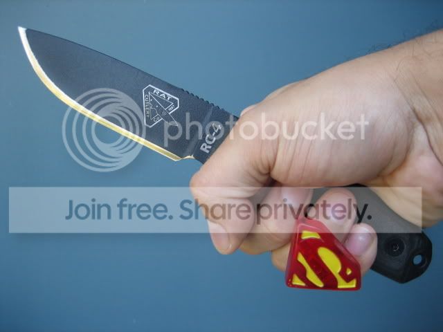

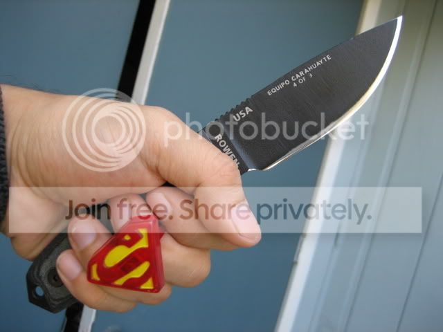

I just got back two more blades from Simon. I wanted them thinned out a bit and re-convexed. These are two of my favorite blades with about as much sentimant as I could muster up for tools. After the first two knives Simon put a convex on for me, I didn't have any hesitation sending him my most loved knives. Altogether so far, Breeden Kelly, JK Kephart, RC-3, RC-4. I only have the RC's with me where I am so here ya go.
RC-3
RC-4

Simon what service did you give my knives? Did you do different things to get them that way?
People they are sick and I am afraid to use them and getting them dull.
-RB
the strop should do well to keep them sharp for quite a while...
if i remember correctly i took them from 120 grit through to a 15 micron belt, followed by a powerstrop and then a handstropping.
the powerstrop breaks the burr (but leaves it attached) and polishes the edge some. the handstropping is to remove the burr, providing a crazy sharp, stable edge.
