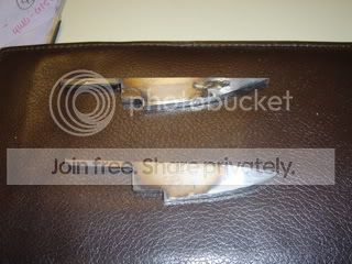

Man i cut cut half a shape well maybe 40% of the top knife in a piece of 1/8" A2.
It was tuff. I used a die grinder with a cut off wheel. I dont know how ill cut the curves and stuff. I wasn't expecting it to be that tuff.
Well heres where im at.
marked em up. Then cut them out.
I guess next i'll clean them up some and drill the pivot hole.

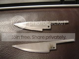

Well here they are cleaned some and filed some. I did look at one of my books and it appears i have draw filed wrong. I did more of a sharpening style push on this not a pull. I will try again tonight.
They are not exactally like i wanted, but its my first shot at this. Any ideas or thoughts?

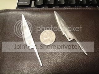

well here they are before hardening.
I knocked the edges off with a belt sander, and man that thing can get away from you.
They are small and hard to handle. Next i will make a nice mideum size knife.
I am going to show my ignorance about making folders and ask a question. What is the purpose of the skinny portion opposite the blade, like a continuation of the spine?
Its a friction folder and does not have a lock blade. When open you hold that section against the handle to stop it from closing.
