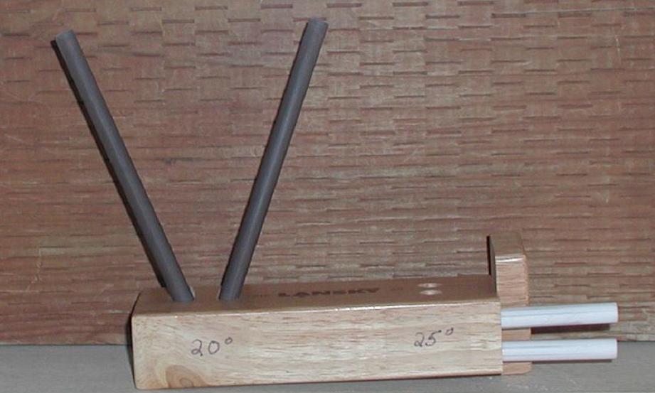

I'm afraid I have to disagree with David (Obsessed with Edges) on this. I think a simple, inexpensive, Lansky 4-Rod Turn Box set of rods would be just the ticket for you. Just pay attention to your strokes.
Once you have that down get a Norton Crystolon Combination Fine/Medium stone and that should take care of all your needs.

David (OWE) knows just TONS about sharpening. But he and I disagree on small sharpeners. I think that most people, especially beginners, have a hard time with small hand held sharpeners, like the diafold he is recommending. The diafold is a solid product, but I think you need really good mechanics to use it correctly, which most beginners won't have at first and will require a good bit of practice. That's one reason I'm recommending the SharpMaker: The mechanics are easier. It's not hand held. It does most of the angle setting for you; you just have to hold the blade straight up and down through the whole stroke.

Sorry David. I wasn't thinking about the single rod. You are right about that type of rod being difficult to master.
