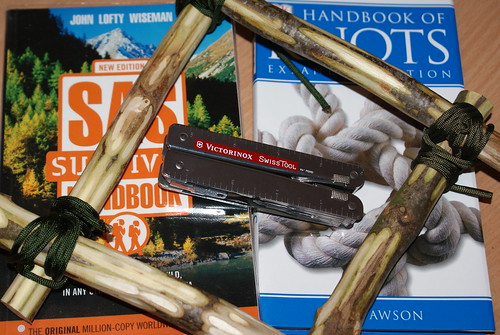

Was thinkng about making a video on some knots.. It;s led me to do some thinking about what I actually use.. seems that while there is allot of skill involved with many of the knots out there.. the ones I use the most seem to be the simplest
i think for general (non climbing, Sar) type stuff
for general woodsman style stuff one could get by with
not including the simple overhand knot
Slip knot (various applications)
Figure 8 loop (creating a fixed loop)
fishermans knot (simple rope joining)
prusik knot setting tarps
taughtline hitch (guy lines stakes etc)
quick release knot (poncho or shelter set up)
timber hitch (hauling)
square and diagnal lashing (general camp craft and shelter)
I think with a good understanding of those basic knots one can be weel on there way to improving there situation outdoors by a significant amount, armed only with some cordage (and of course a knife)
I plan on doing a photo thread and possibly a vid on the subject soon, but just wanted to get some conversation and opinions about these first
I know there seems to be a standard body of knots that are in every survival guide that seems to be accepted as the knots one "needs to know" and many of the ones on my list are not on those lists and some from those lists have been excluded from mine, but I've given this some thought for a bit, so let me know your thoughts.
