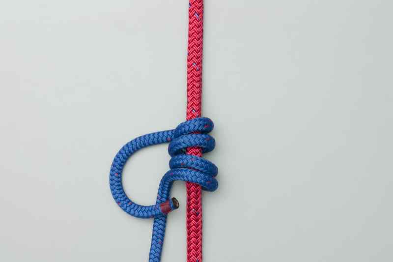

The blakes hitch is a far better replacement for the taut-line hitch. It will not feed line from the tag end of the knot, plus it wont jam up like a taut-line will when you've had you weight on it for a while. The blakes and the T L are used with the same diameter climbing line whereas the prusik works best when it is tied in smaller diameter cordage than the host line. The prusik has the advantage of being able to be used (loaded) in either direction. They are ALL friction hitches capable of (grabbing) a host line in a climbing situation or when you need to secure a attachment point.

How about a diagram, picture, link?

:thumbup:I agree< My climbing rig(split tail) is set to go(for emergency/storm hazards) with a blakes speed hitch.
The blakes hitch is most commonly used by tree climbers. The other end would go to your saddle and be anchored via splice as in a split tail or by being the end of the main line itself. As soon as I can post pics I'll get some up. The blakes will replace the taut-line elsewhere too such as a tent guy line tightening knot. Anywhere you would want to tighten a line and keep it tight.
In climbing the blakes works best being the same diameter as the host line. If you tie it in much smaller cordage like a prusik it will bind up more.

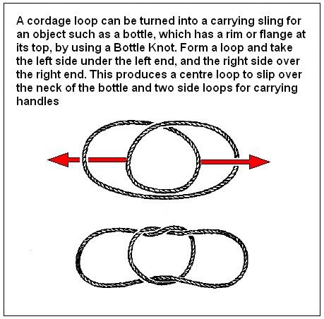

I came across another version of a jug knot. Although maybe not quite as secure as the previously posted one, it is interesting and maybe easier to remember for those that are knot knot-junkies. :rolleyes: I modified the diagram a bit to hopefully make it more clear.
