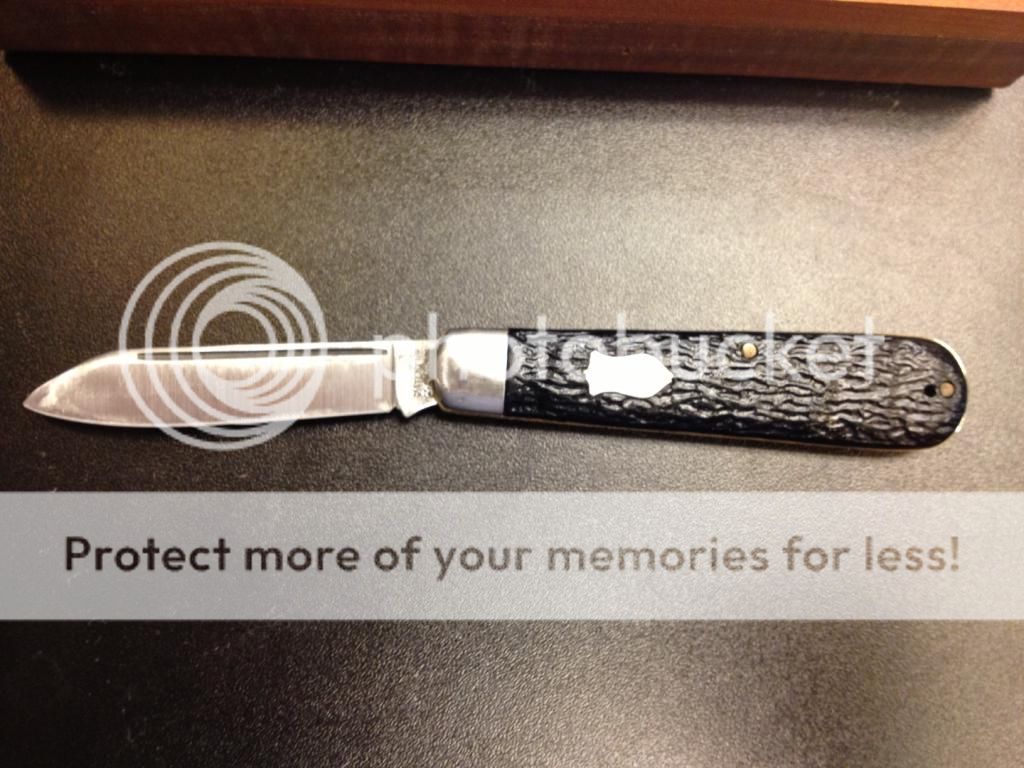

Ever since I was a kid, I have been mesmerized by the idea of a straight-profile blade... I'm sure there is a technical term for it, but think of a knife that has no edge bevel. The cutting edge is the same as the rest of the blade, and depending on the blade, can have an effective edge degree of less than 7 degrees. I call it "flatting".
I had kept this knife around for just such a task (and my grandfather gave it to me when I was 11). The patent on the blade was filed in 1940! I figure the old carbon steel would be best for this experiment.

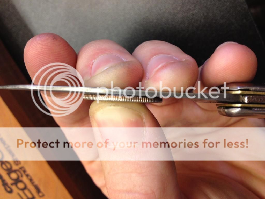

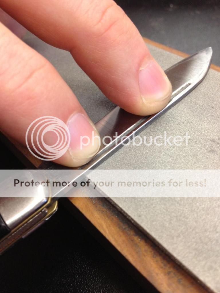

Here's my grand idea: I press the full blade against my diamond stone and just go to town. I ended up losing a bit of skin off of my fingers, as the stone would pull the skin under the blade, shaving it cleanly off.
Here's an American quarter for blade width comparison:

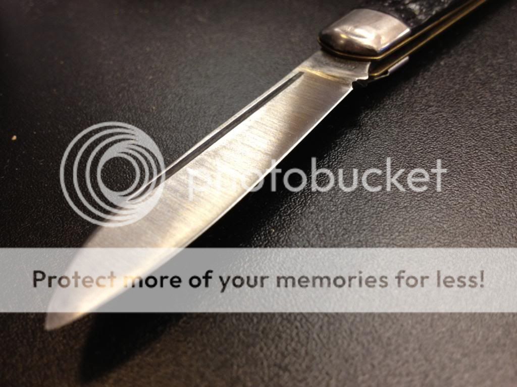

After doing some guesswork math, the eventual angle of the blade ended up being 6.7 degrees :eek:
BUT, that's where everything went wonky. As expected, the edge developed quite the burr. In an attempt to remove the burr, I dragged the edge across a new clothes pin. Once I was satisfied that the blade had been deburred, I checked the edge with my finger. It felt EXTREMELY sharp! I looked at the blade and noticed that the area I had run my finger down was "dented". Turns out, the edge was so scary thin that my own calloused finger rolled the edge and chipped a piece off in the process.
Another problem was the belly of the edge. Flatting a knife is fine if your knife has a 100% straight edge. This knife is pretty standard, and the stone wasn't touching the edge after a certain point. The gentle tapering in the blade made it impossible to flat the knife without turning it into a modified tonto :grumpy:
I eventually gave up and put what I can only think to be a 12 degree bevel on the knife, oiled it, and put it back in my knife collection. Anybody else ever tried this?
