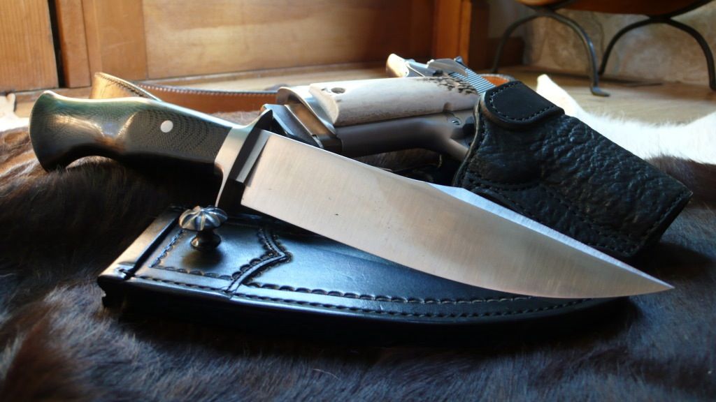

Somewhat in line with this thread, my question is why have an "S" guard at all. I can't see where they are any more useful than a straight double guard, and they are a pain in the ass for your local sheath maker. An abbreviated top guard is good per Dudley's comment, but in the whole scheme of things not absolutely necessary.

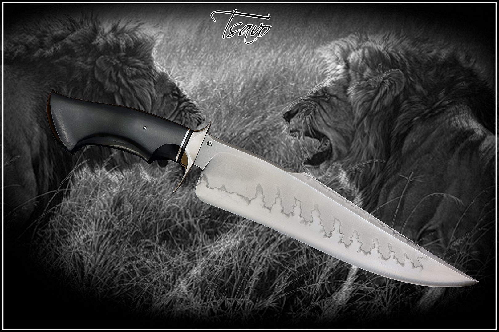

To Paul's question: Look at my avatar. I 'get it' that it's a pain to sheath. It simply looks symmetrical and sexy.
Chopper: Lose the guard? (Custom choppers have a MUCH higher tendency to actually get 'used'.)
Bowie: For fighting. Like we always do with them. ;) So make it with a double guard for thrust and extra protection.

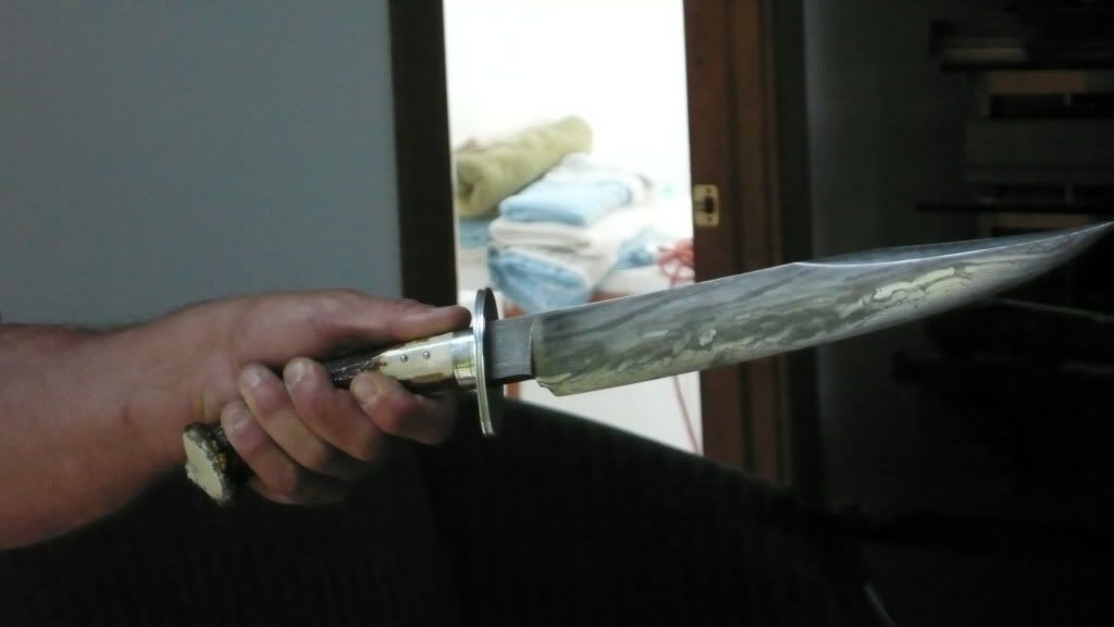

I've read that some people like to have their thumb on top of the handle to help aim the point stabbing.
Along that line a double guard makes sence.
Top right pic on the book.

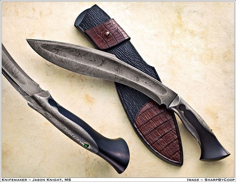

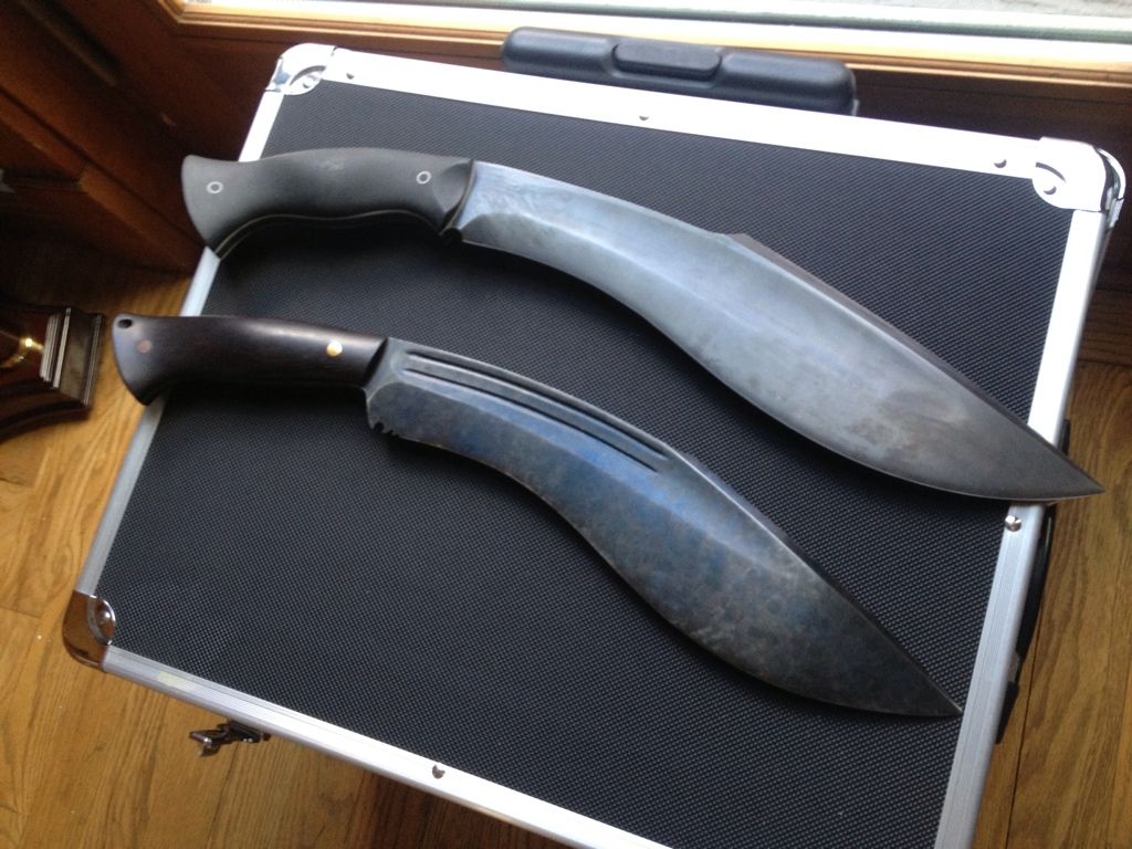

On a chopper and some swords I dont need a guard but I do like index points that can be guard like
The Turks head on this piece is an example

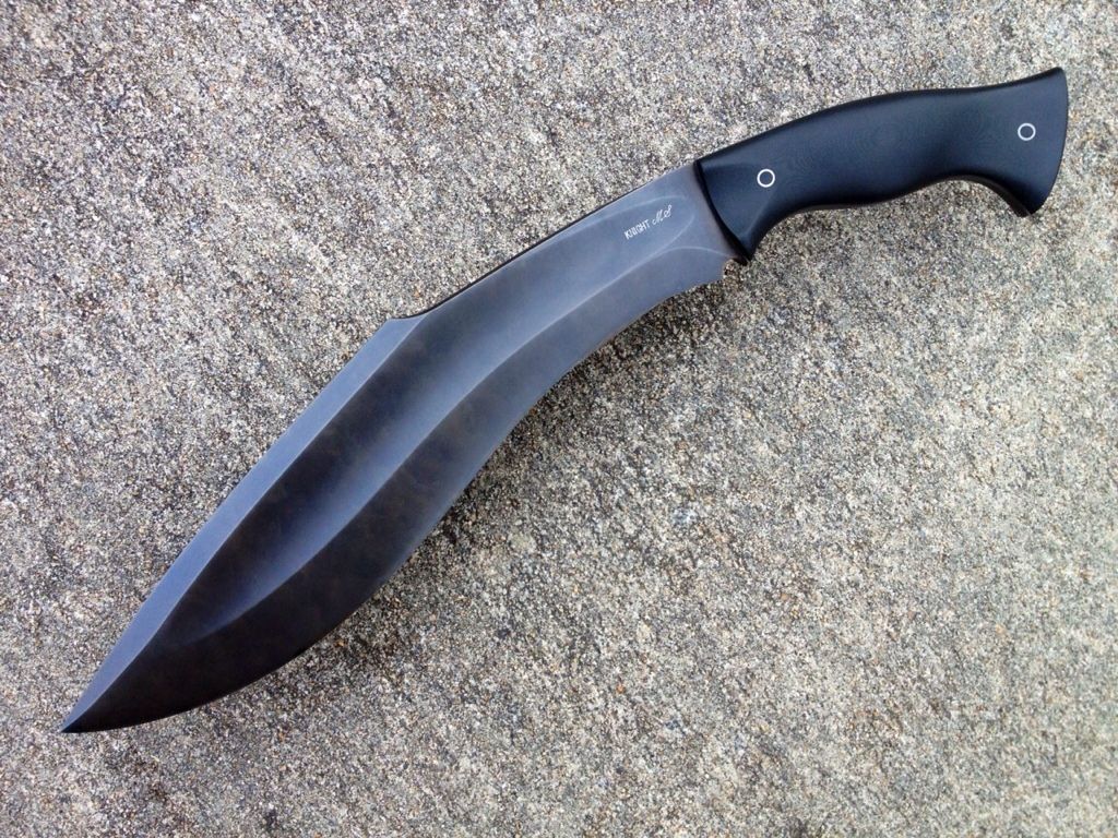

The Knight Khuks which i believe to be the finest Khuks I’ve ever handled have a great handle that really index’s and rocks well in hand

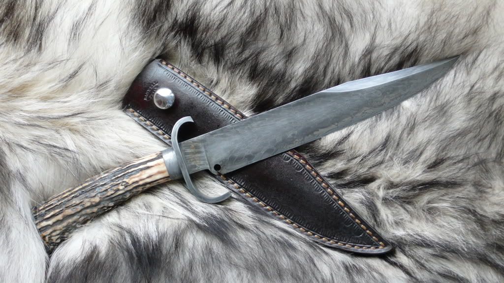

On Bowie’s that are not camp oriented blades a double guard is a must
If there were ever too much guard it would be an HB but it still works
Fighters can go all ways but i prefer at least a half guard

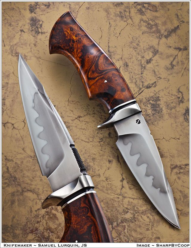

Sam does great half guards and properly sized double guards

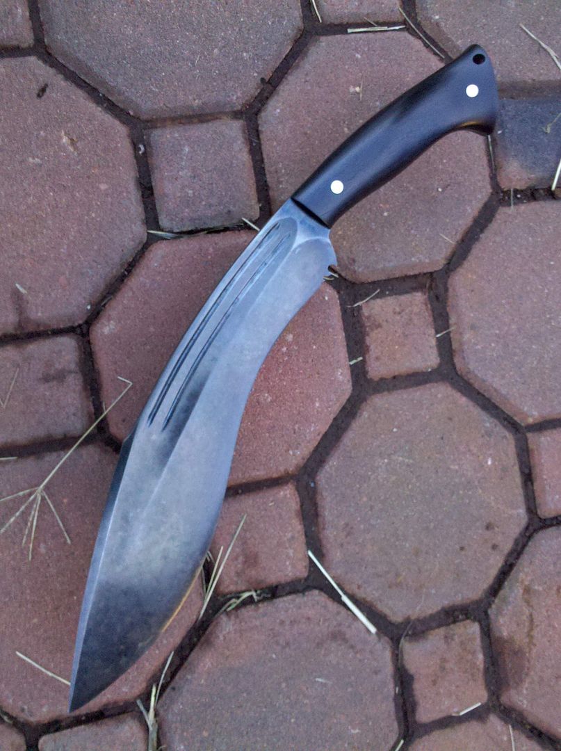

I like to use this design on a chopper:
It looks pretty dope to me and it is more user friendly than classic double guard, especially when using extended grip, etc.
