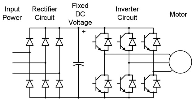

Wow, I'd never really considered this before, though I think I've see it in action. The first thing a VFD does is run the input power through a big bridge rectifier and filter caps. I would think the capacitors would be sized for a more or less even input from three legs so the DC feeding the inverter might not be perfect but I think what you're saying makes sense and I've seen three phase amps "single phase" just fine on a dropped leg. A big 5 HP 3 phase VFD is pretty cheap and easy to come by on the bay, I'm going to try this. :thumbsup:
Its actually the diodes and their respective conductors on the circuitboard what bear the extra load. Its multiple capacitors are just paralleled to make a bigazz capacitive value on the DC buss and fit within the overall physical size designed.
One can Google images of "VFD block diagram" or similar verbage to find abundant examples VFD theory of operation.
