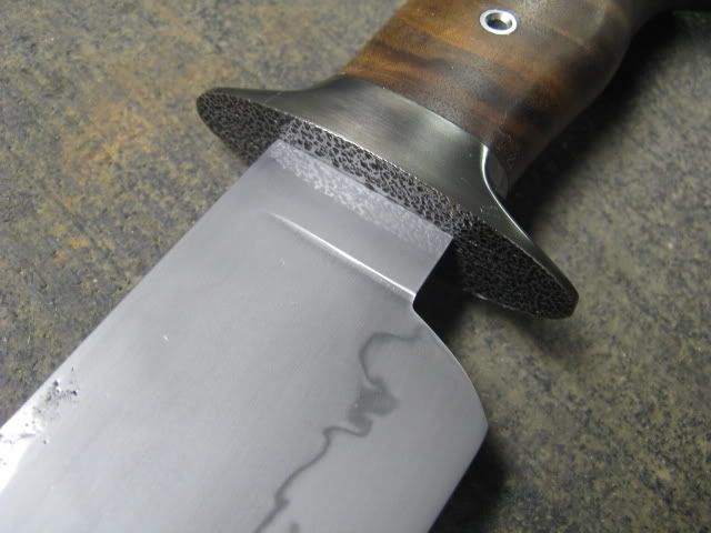

go buy a chainsaw file. do NOT square the interior edges of the notch as those will cause stress risers like the 1217 handle.

So your saying it has to be round? I really liked the idea of the squared look, kind of gives it a little different appearance to all the other thousands of knives it resembles LOL
What about all the bowies out there that have squared off ricassos?
that's not square, that's gently radiused AND is done on a super thick piece of steel that is not fully hardened (see the hamon). Furthermore, under the shoulder where the ricasso meets the guard, there will be radiused corners that meet a slimmer stick tang.
you can go square-shaped, but do not make sharp inner corners. The ricasso on that knife is muuuch wider than the one in your drawing too, leaving a bit of finger room if you need it.
I see the temper line on 1 and a hamon on the other.
So square shape is ok if you round the corners a bit? Would a chainsaw file work for that?

As long as the inside corners of the cut-out area are not sharp 90-degree angles you should be ok. yes, you can radius them with a chainsaw file - small one if you want to keep it looking more square.
Decide how you want the plunge to work relative to the cut-out too - those two pictures you linked have different approaches.
Square cut outs or angles create a stress point that cracks WW. A round curve doesnt have the same tension in a focal point so is much less likely to crack.
Also on a guard at the transition like Daiz said the Cold Steel Trail Master and such have square transitions and are known for breaking at that transition, even though they are thick stock, and have a pretty good heat treat. They dont mill them round because it takes a little more work, and that means more money, and they dont think their profit margine is good enough on their knives to afford that I guess ....lol
Ok great. Thanks for the tips Daizee. Chainsaw files look pretty cheap so i can do that LMAO
On the plunge line id probably go like the first one. I have never done one yet so ill have to play around a bit.
Yea... Ill probably end up rounding the top but keep the 2 straight lines coming down.. Like an upside down U... Hopefully that would prevent the stress risers, but keep the appearance close to the same.
