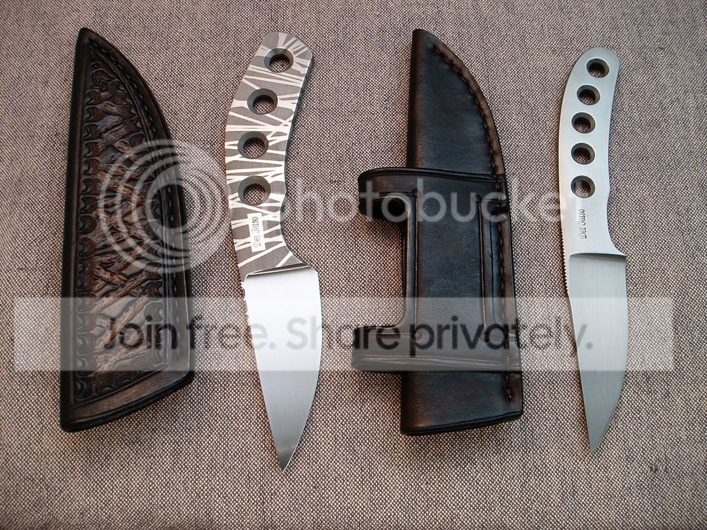

Hey guys, first post on bladeforums, and first time knifemaker
I'm in the process of making my first knife, and I planed on making a small light weight knife that would primarily be used on backpacking trips. I have the knife cut to shape, and my next step is to start removing material inside the handle to make an Izula like skeletonized handle.
I was thinking I would drill a bunch of holes, then use a file to remove the rest as I don't have a milling machine or even a dremel/die grinder. I was wondering if there is a better or faster way of doing this.

Well you could minimize the filing by sizing the larger radius' to the drill bit, and then using a small bit to take out the meat on the long sections. You will probably want a coping blade for the sawing work.

A "bunch"of holes is never the answer. A few large holes actually does more and looks much more efficient ! Leave at least 1/8" between holes and from hole to outside edge. My neckknife has no scales and has four holes from 1/4" to 1/2" .Those you can drill or if needed watr jet.
I agree with mete. I make a lot of the type of knife you are describing, a series of well spaced holes is very quick, adds character, and can look really good.
Sure do look good!

Maybe I'll go with just a series of holes, I like the looks of your knifes. This is the part that I'm most concerned about screwing up too so the holes would probably be an easier way to the get what I wanted
