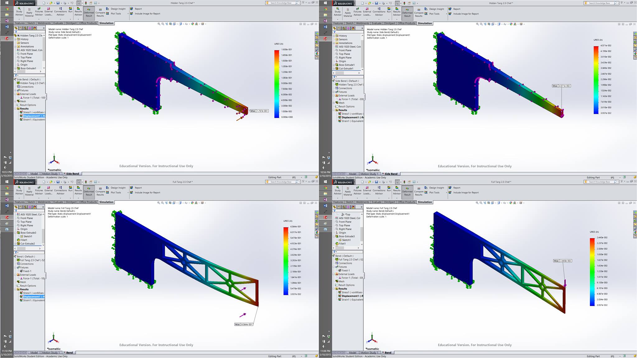

It's really difficult to try to get that same kind of feel and balance with a full tang and the materials we often see here (phenolics, composites, heavier woods). I did some SolidWorks models and it's possible to end up with the same weight with some serious metal removal (would have to be lasered/watered/edm/etc); I'll have to play around with the FEA more to make sure it isn't floppy like crazy though. Here's a really early thing I was messing around with. They're both the same weight. The FEA here doesn't really tell me much though since there's the rest of the handle that's unaccounted for. When I come up with actual iterations then I'd do direct comparisons to what I have been doing (simple holes drilled).
I hope that's what you were asking about :D Lemme know if I missed the mark completely.
