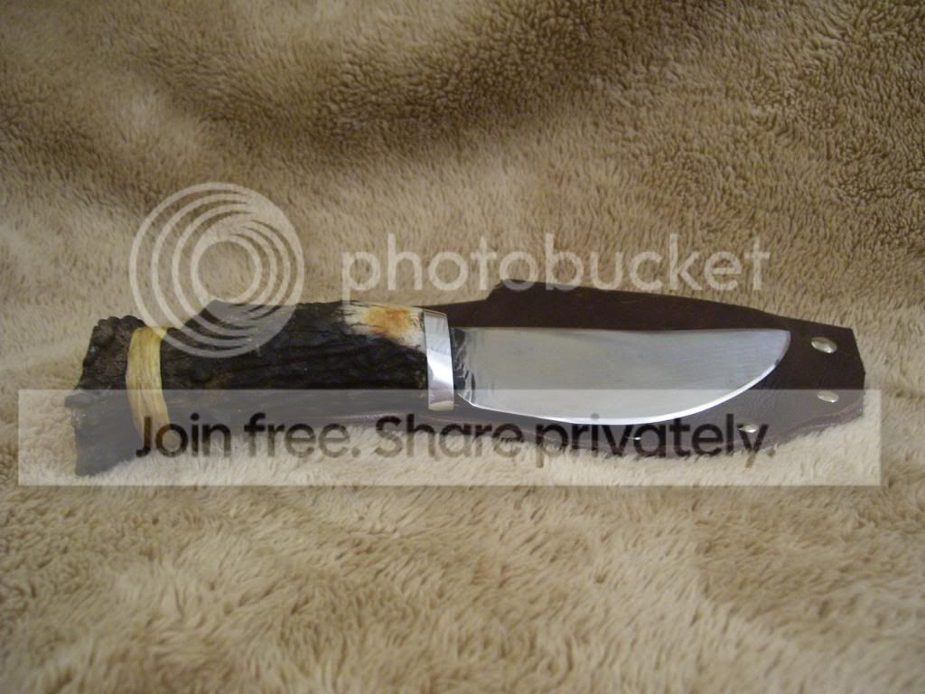

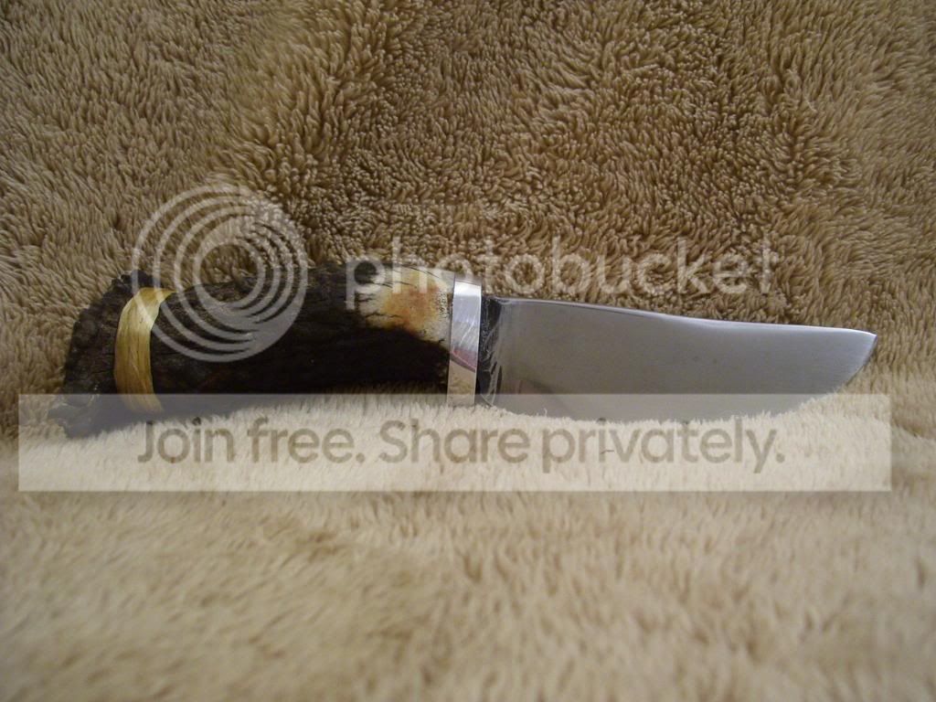

This is one I made for my grandpa for Christmas. He's getting older and had a stroke a couple years ago. Before that, he had an honest love for knives and hunting, so I know he will like this.

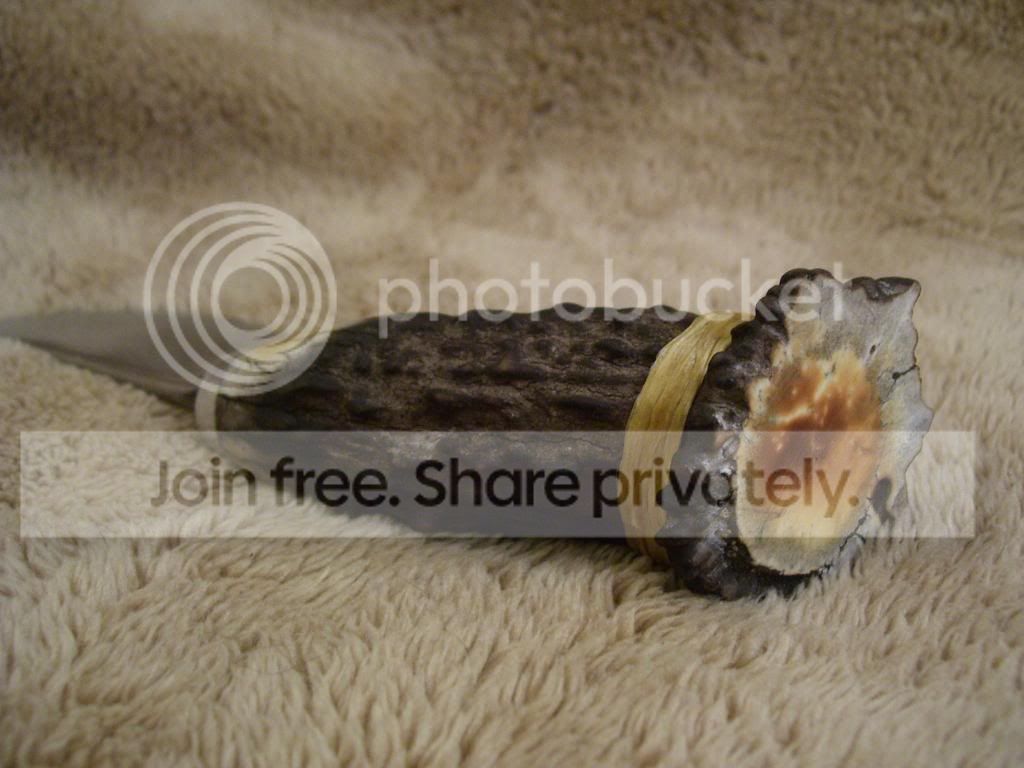

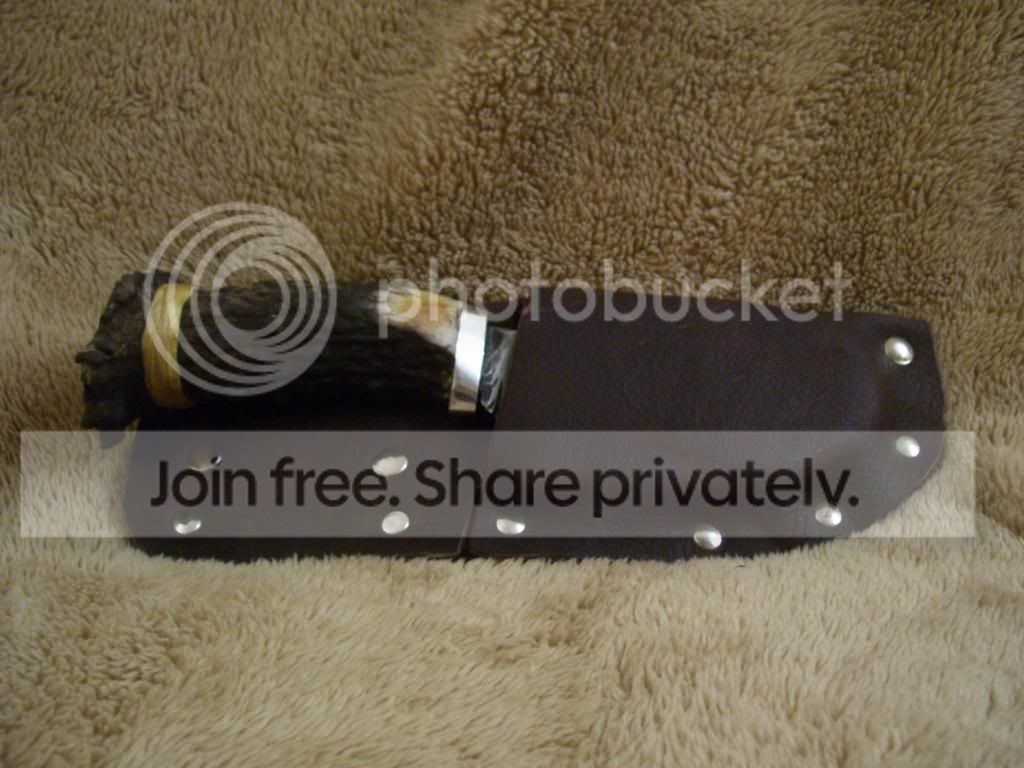

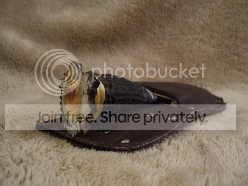

It's forged O-1, only the second blade I've hammered out. Well, let me qualify that... it's semi forged. There was still a lot of stock removal to do. I'm not as good as most of you guys. Aluminum guard, oak ply hard sheath, OLD OLD OLD antler handle that is cracked beyond belief but it looks great.

Great job, you can fill in the cracks with super glue. With few exceptions most of us smiths do a lot of stock removal in addition the "stock moval" we do with fire and hammer. :)

Thanks, that's good to know. I always thought my HT forge could get forging temps, but I never tried it because even if I did I wouldn't have anything to beat the blade out on. Finally I did one on the concrete floor of my shop and on a piece of I-beam. This one was done on a piece of rail steel that has had a horn shaped out. I want an anvil, but it's hard for me to move 500lbs. Not to mention that a 550lb Refflinghaus is almost $4000.
