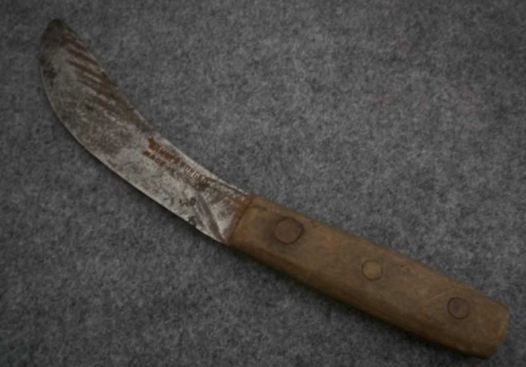

i dug this old thing out it reminds me of this ,an old butcher knife
How much for this one? Is it Scary Sharp? Maybe it's another BA knife I can afford! Where the Hell is the fine chunk of redwood burl you usually prop 'em up on? Are those handles KhakiTactical MICARTA? What kind of pins?And how didja make it look aged?

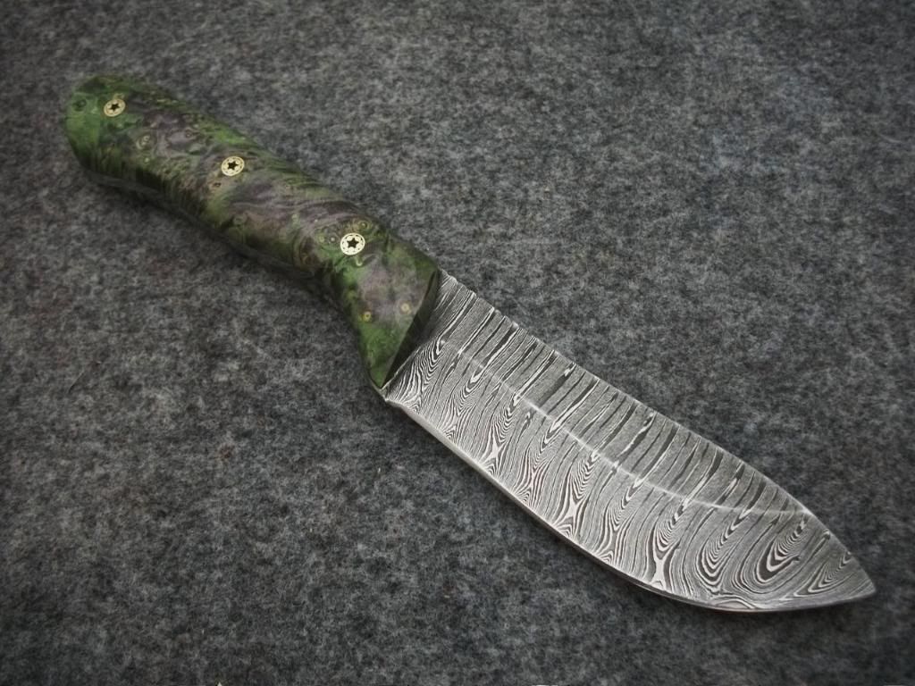

AFTER I SET HERE, I WAS THINKING I HAVENT DONER MY BULLWHIP SKINNER IN A LONG WHILE,HERE IS WHAT THEY LOOK LIKE
Bill, those two look like they would make short work out of a white tail.

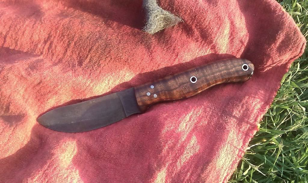

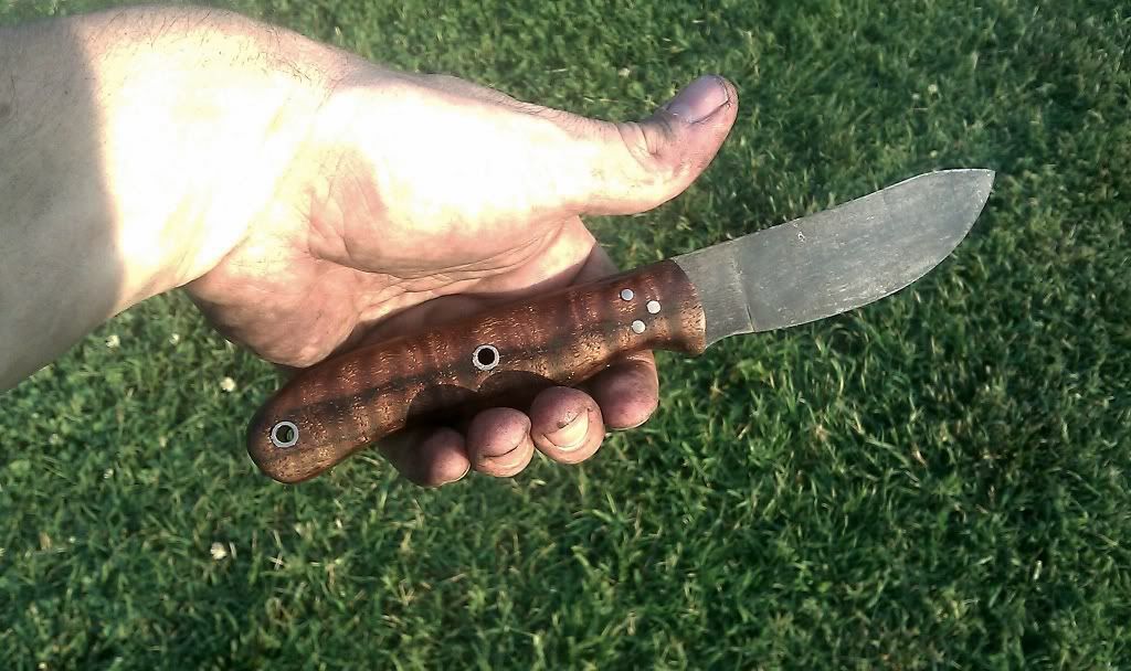

So I received an email from a guy that is looking for a skinner/Hunter the other day. Ive never made one and don't get to skin out much except for squirrel! Anyway, I don't really take orders but I want to give this style a shot. He is a custom collector so he has knives by all the greats and it is kind of intimidating really. He saw that Alans Nessie I posted on the main exchange and liked the style so....here we go. I have been thinking about the design for a couple of days and have come up with something I think might work. All you more experienced skinners speak up. I would like your feedback. I wanted something that had a curved butt, slimmer blade, and of course alot of belly. I think a guard would be great but I don't make them so I kind of added one the best I could. Oh, and he is trading me this kick ass custom slipjoint for it! Check out that handle! Be honest, I need some help

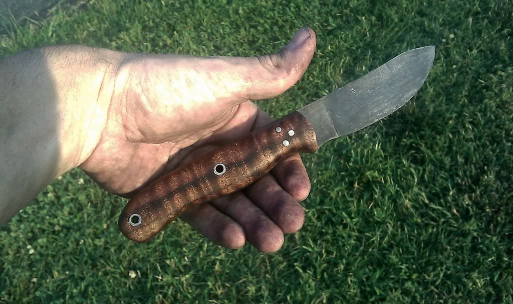

Here it is. I added a choil in front of the guard and rounded the front spine for detailed work. Its different but comfy as hell. What ya think?
Looks good Chris. I think your customer is going to be very happy. Better get ready make some more, you know after people see that one
they will want one!!LOL
Well, I did that skinner from start to finish today! I posted pics in the first post. I really like it. The wife siad its my best one yet for what thats worth.
Thanks Wilson! He said he really likes it so Im happy.
Looks good Chris.
Bill i like that bottom bullwhip,
i was thinking of that blade style when you made mine up.
Chris looks good, you were able to refine the shape but still keep it with you creative style. Wtg!
Bill what is the green colored wood on your bottom bullwhip, it's killer.
