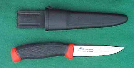

For a non-stainless (carbon) version, I recommend a Mora Clipper. I actually would recommend it before any of the other knives I listed...
