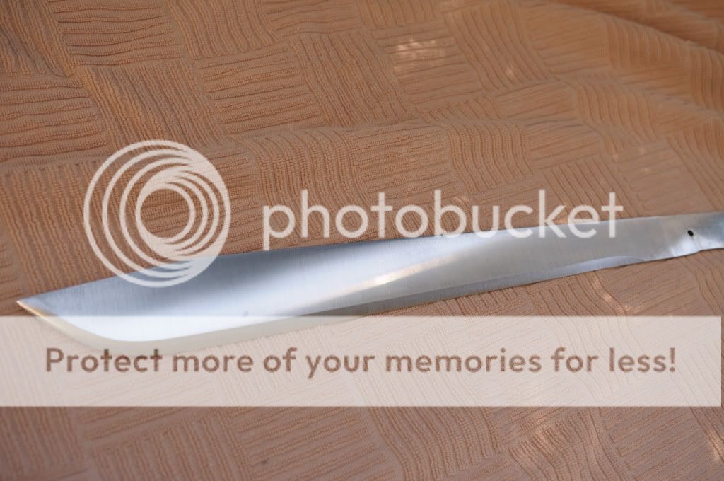

Thanks Dennis:) Right now I am looking into the best way to establish a clean plunge I guess it is called. under the coating were heavy grind marks and I want to make it look nice.
I guess I can just make it with the slack belt and make the grind lines clean by going back over the flats?
That is what I did with the most recent machete when I had to make my own "plunge?" and it turned out like this. Of course I am hoping for better results with my ASH.

To clean up the grind lines.....if you use a slack belt you end up curving the edge of the spine as it goes to right angle to the flats and to the blade and convexing at the edge itself but cannot get purchase in the middle of the blade sides/flats themselves...unless belt tension is "very tight"....it is much better to use the platten and glue the leather hide in place so you can press the sides of the blade against the belt and the leather and stroke the knife from the plunge line towards the tip pulling the knife away one the tip reaches the belt.
Do equal strokes either side to keep the geometry right...
Using a new belt at finer grit is the best way...a severe grit can remove a bit too much steel as once done you then need to use finer belts to give a satin finish.
Once the sides of the knife are clear of grind lines...then do the slack belt on the edge to give it a full convex keeping the spine away from the belt to keep strength at the spine and the correct geometry between spine and handle.
My tip about taping a block just after the plunge line so you do the ricasso and flats seperately is to avoid the loss of the plunge line as the belt skims over it to the flats...this is common when doing a ghetto satin when the grips are'nt removed...but as you have removed the grips you can avoid this.
When you do the flats you will be able to reverse the process and put a block just after the plunge line...but when you hold the blade flat against the belt you will not damage the plunge line if the belt goes over it slightly...and you should end up with a uniform shape by counting off the passes so that the handle gets the same as the blade...or better still by using a digital micrometer to check the spine thickness each side.
The job you have done so far looks great though...so no worries...you seem to have done the worst of it...but it is hard to tell from the photo's which show a spine shot...we would need to see side views to see what you mean.

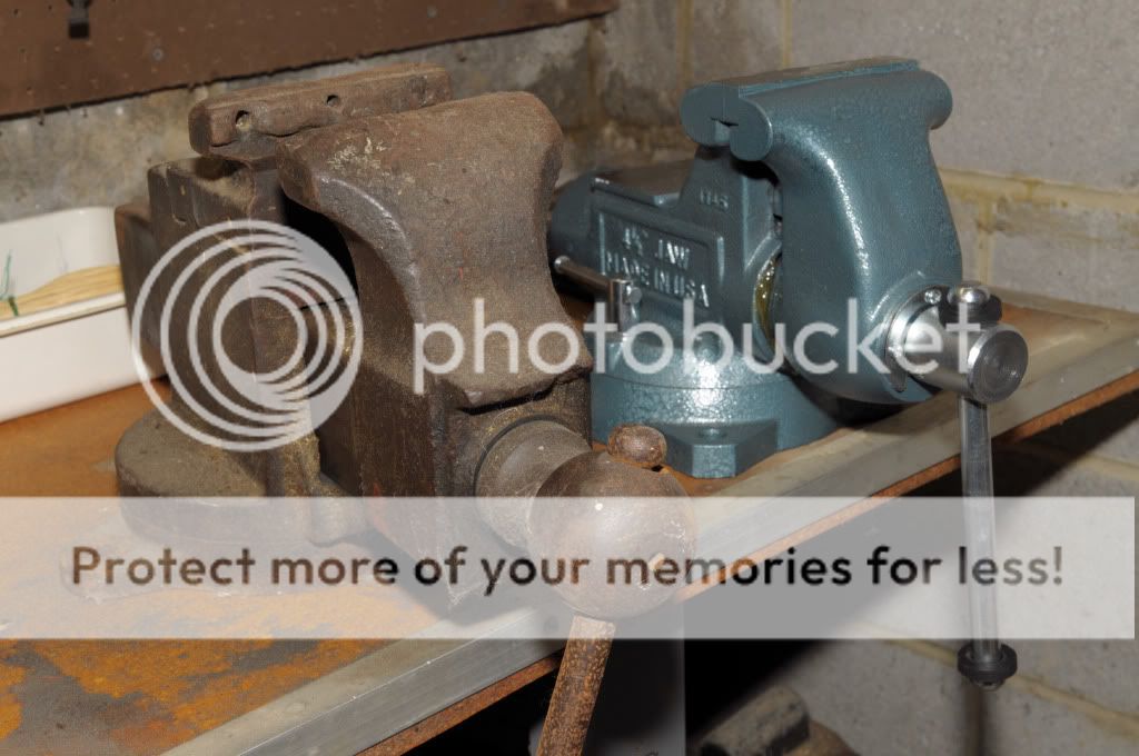

On to the idea of attaching the handles, I picked up a new vise because the old one was getting a little worn:
If anyone has any advice on this also I would appreciate it. At this point I am under the impression that this can be accomplished with ~.033" tubing and drywall screws but would gladly take more advice. I may be able to have dies for this in about a month. Should I try to wait for them?
