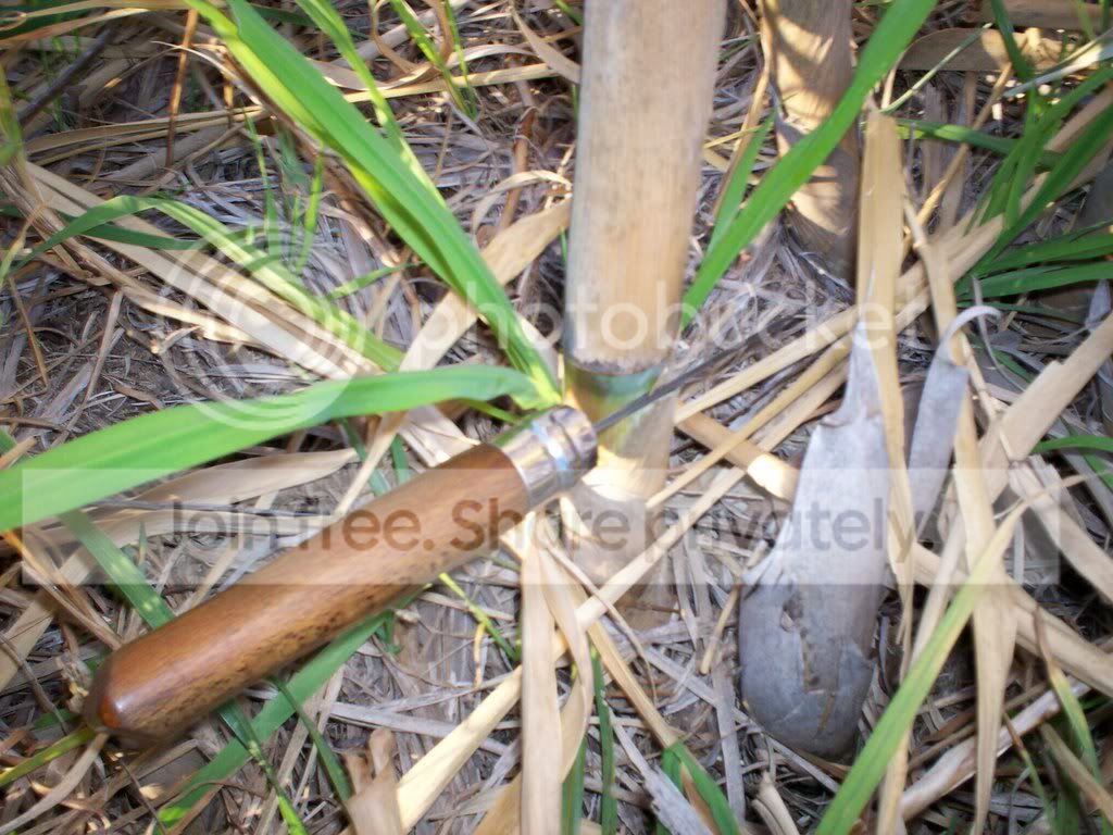

first cut

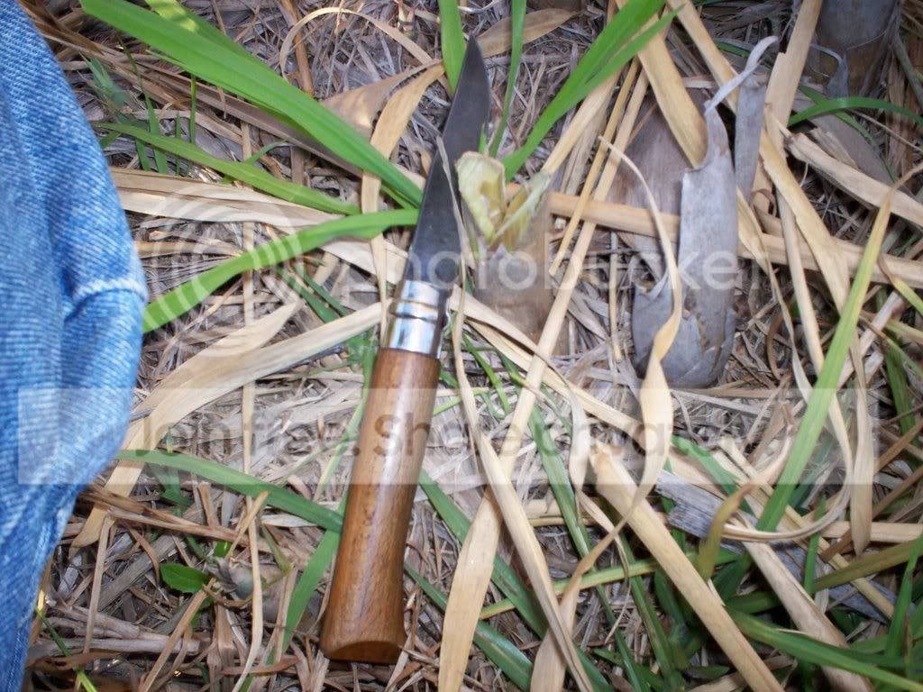

second cut and its down ...

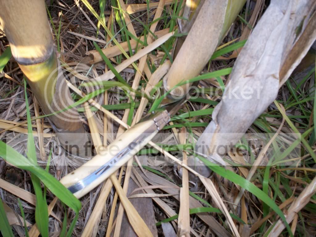

yeah OK , we only cut two 18' long poles
going back to get more later tho ... opinels are tought little knives :)
I was going to try another couple knives but ran out of time .
I never realised how hard it is to do what you usualy do , but get good pictures of it ...

Were you using a baton on that? That piece I cut was in so far I could barely wedge my shoulders in close enough to get both hands on the knife. If I could have used a baton it would have gone alot easier. Mac
Pict
It was a one handed effort , but a fair-ish effort , with a bit of blade rocking to get the cut down deep . ( Im a big bloke tho with long arms and a fair weight to lean onto the blade )
once the poles were down , I cut them straight across to shorten them into 6' sections , no baton , just a steady cut , turning the pole as I went , but it was cut at 90degrees to the grain , not a 45 across it as usual y is easiest .
I did read up on the skookum tool tho after I posted the pics , the big difference I believe is the width of blade , the opinel is a thin blade and used properly cuts deep into all kinds of things , I have sliced green coconut in halves husk and all with it . I have problems with thicker blades just cutting a plug from the coconut let alone slicing it in half ....
the opinel tho does fold the edge if I try to whittle mulga or other desert hardwoods here ..
