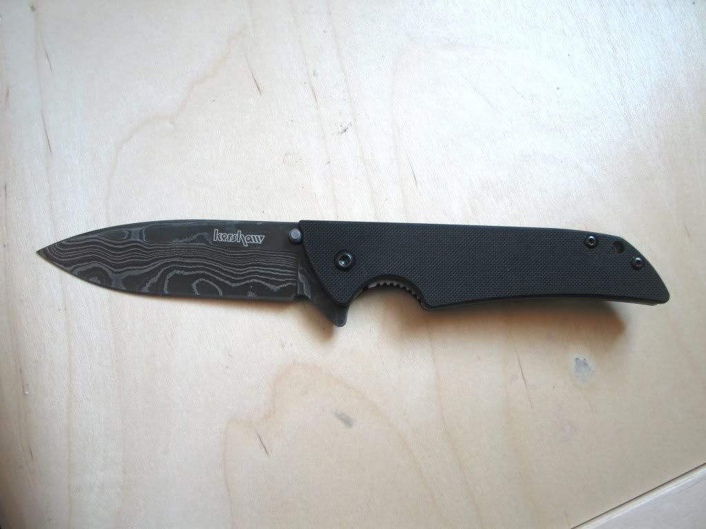

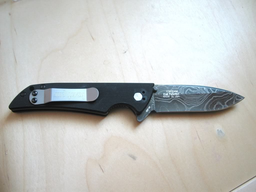

Here's mine

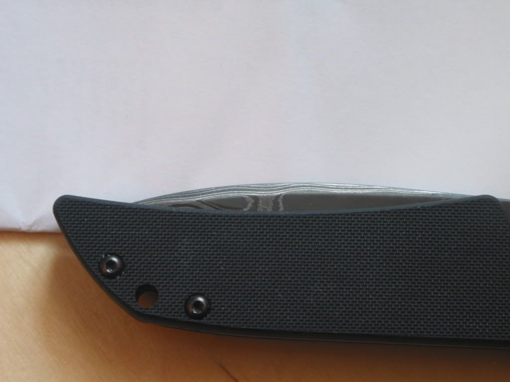

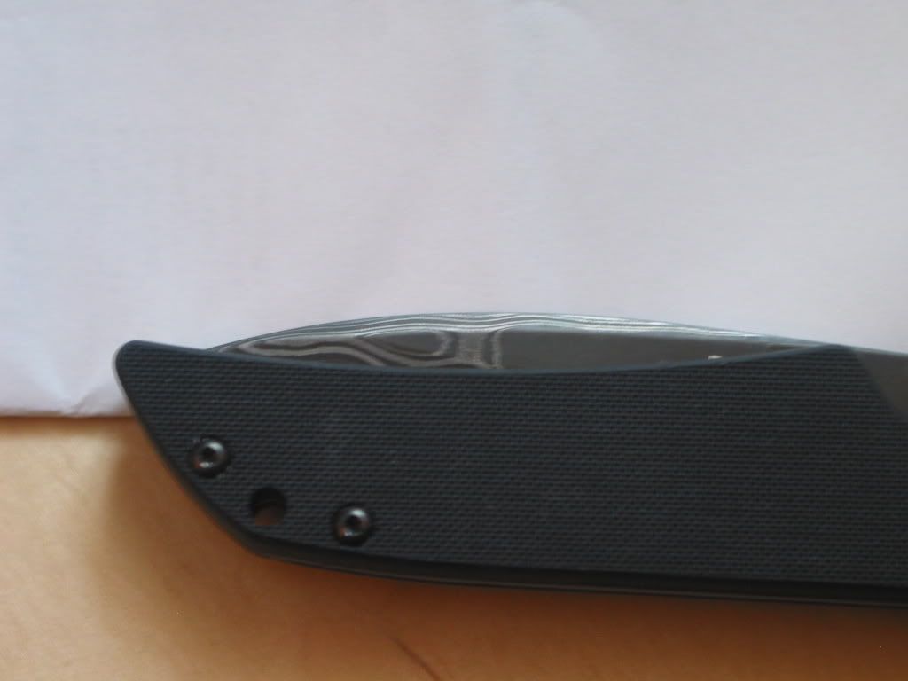

My blade rocks back and forth a bit when the Skyline is closed which is bugging the hell out of me. There doesn't seem to be any tension to lock the blade tight. I posted this problem in another thread and it doesn't happen to Flashpoint's Skyline.
Would you guys try to fix yourselves or would you send back to Kershaw if it happened to you?
free radical
to clarify the rock you are experiancing is it in the direction of closed to open or front handle to back handle?
Hi tommie
There's small play closed to open. When I shake the knife back and forth it makes a metallic rattle sound.
If you hold the knife in the closed position, in a closed grip, does it still rattle?
If I put my knife in my hand in with the blade in the closed position, the knife does not rattle.
The rattle comes from some play from the blade moving a bit back and forth because it has not tension pushing it in against the handle.
The first pic shows the blade butt against the the handle in the closed position
The second pic shows how much it is allowed to move before there's any tension. hope that makes any sense.
Mine is the exact same as Free Radical's. However, I don't believe it's any kind of defect. Maybe it's part of the whole flipper design?
