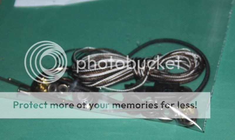

Here's what comes in the kits. First, the leather pieces, then the bag of thread, snaps, eyelets, firesteel shock cord attachment, and needles.

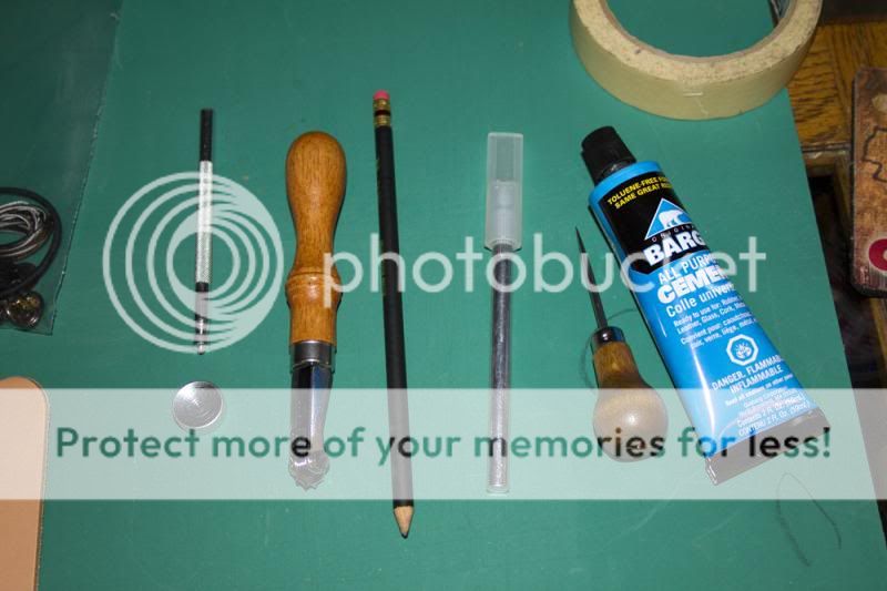

Here are the tools I'll be using. Not pictured is the dye, drill press, and sandpaper (maybe belt sander, we'll see).

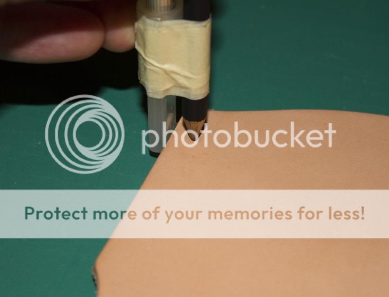

This is my improvised compass I used for drawing the seam guideline. It worked well...next time I'd rather use a compass.

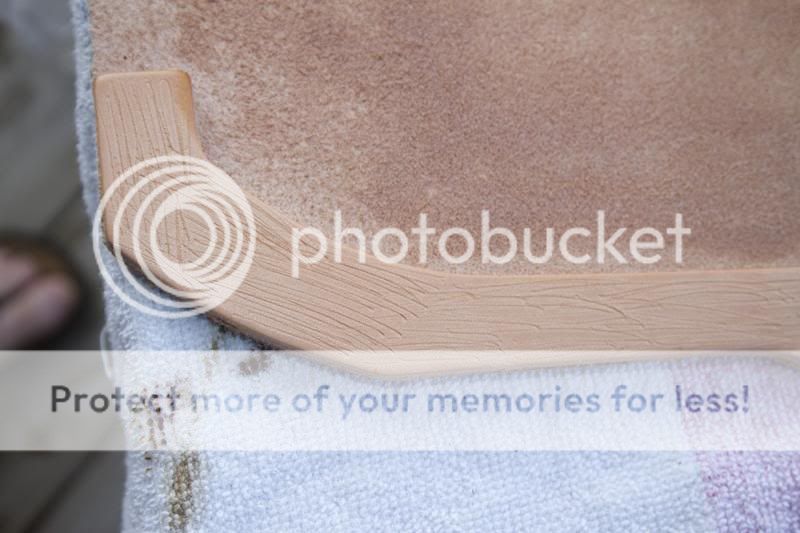

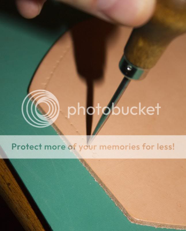

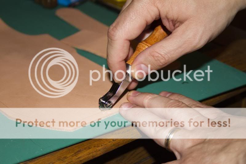

After the line was on, I used a stitch marker to mark where I'd drill each hole.
Then I marked them a little deeper, and slightly corrected a few, with an awl. I'll take these even deeper after I glue the welt on and fold it over.

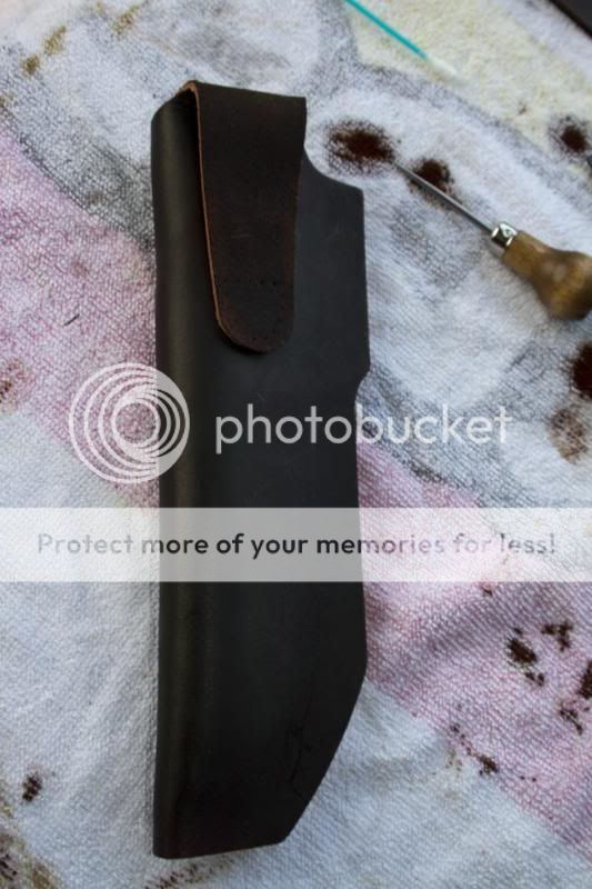

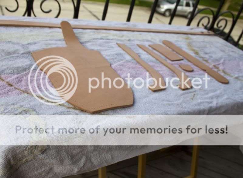

Here's what I got done on Friday...complete with my bonehead mistake. :) I laid out all the pieces and wet them a little before applying the dye.

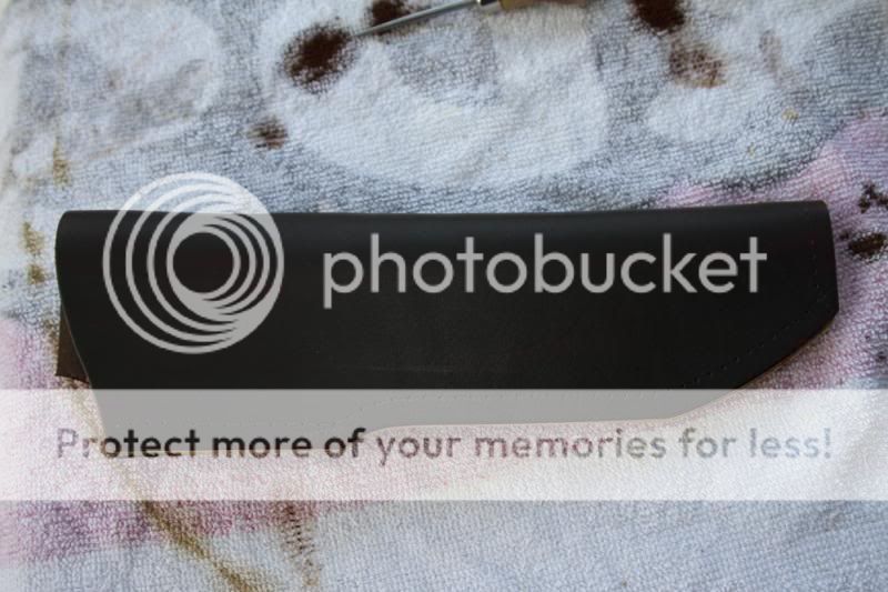

All dyed...darker than I expected, but I think it will age well, so I'm ok with it.

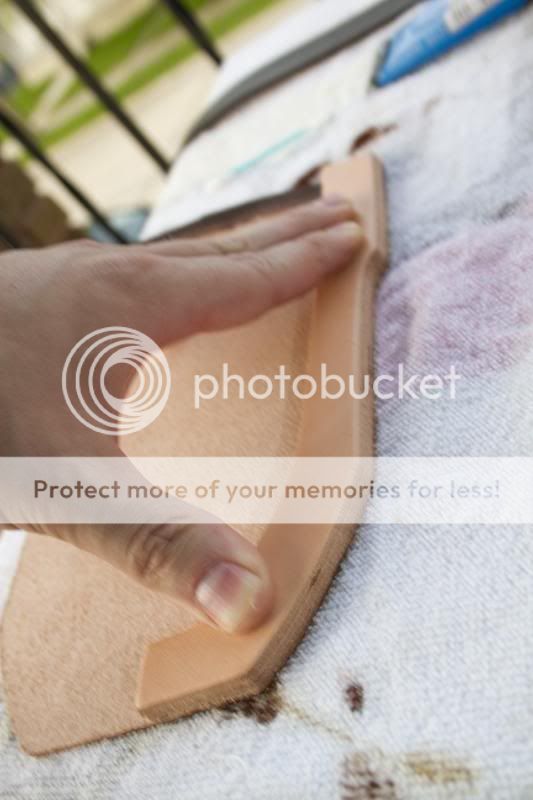

Glued the welt in, roughing up the smooth sides, so it adheres better.
Folded it over and glued up and starting to get excited about the way it looks...

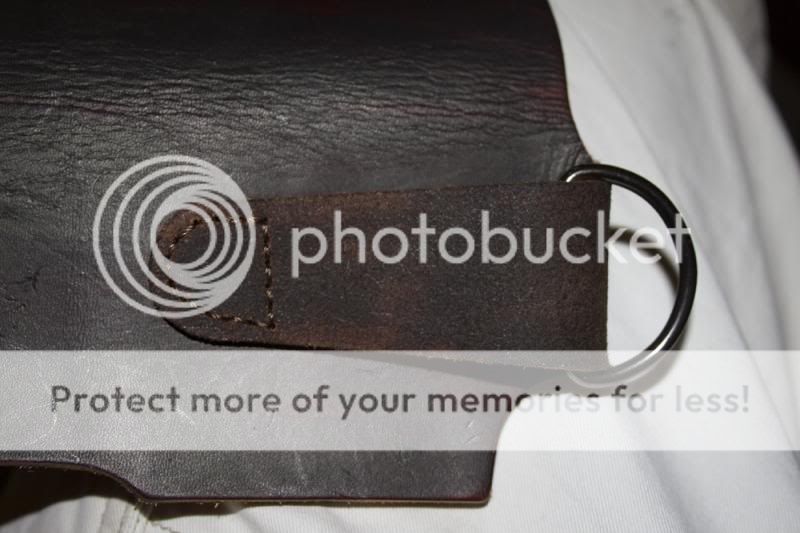

Oh crap! I forgot to sew the belt / d-ring strap and firesteel holder. Time to unglue. Doh!
The back piece I didn't draw out, so the stiching isn't perfectly even from the edge, but it'll be hidden in the end. I did dye the back of this section and the very top inside parts, too.

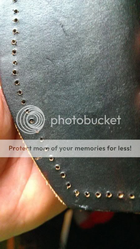

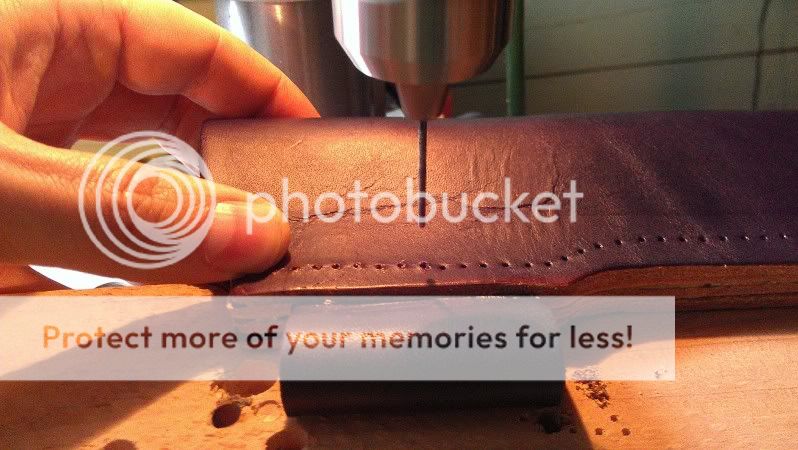

So, I got everything glued and sewn and suprisingly only broke one needle! I drilled out the stitch marks with a 1/16" drill bit after the Barge had a chance to set up a bit. One mistake here, I lost focus and pressed the drill chuck into the leather at the top hole. It left an impression that looks like it's there to stay. :rolleyes: At least I'll know this one was mine!

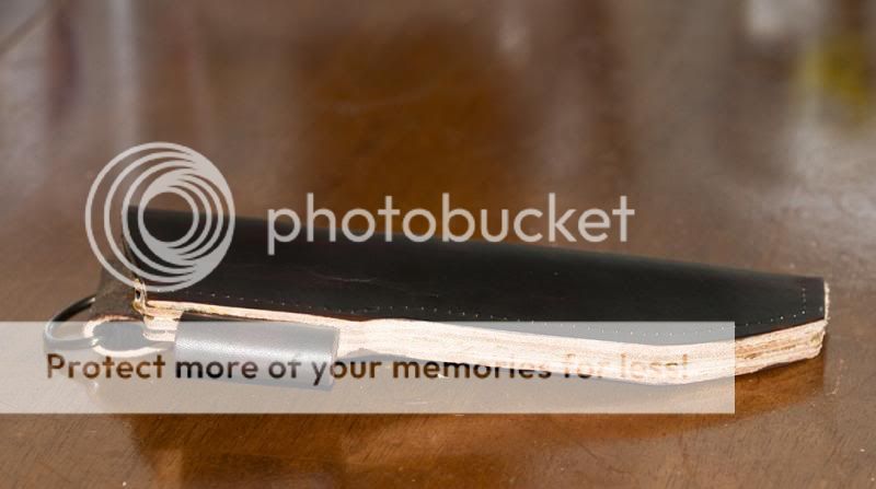

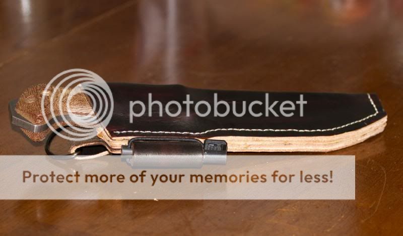

Stitched and ready for edge dye and a couple of touch-ups.

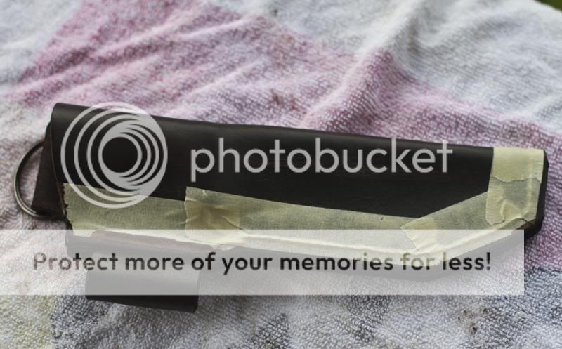

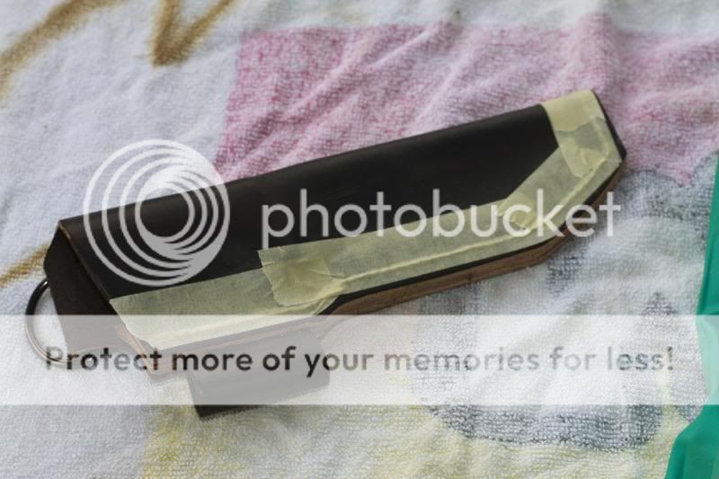

Before I put dye on the edges, I thought, huh...it would be a shame to mess up this nice white thread already. I taped it off and that worked perfectly!

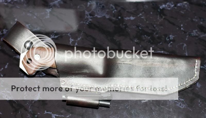

Unfortunately, it started storming as I was going to take this pic outside in the nice morning sunlight. Once I clean up the edge and wax it, I'll get some proper pictures of it in good light.
