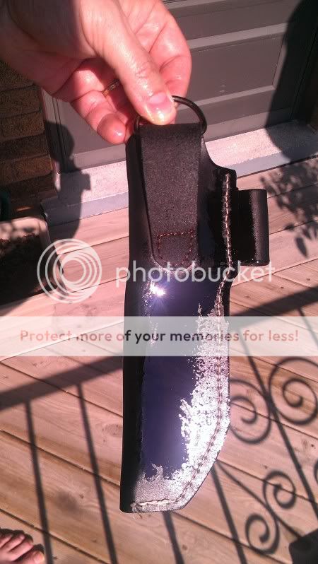

Here are a couple of better pics of it finished up. That's probably all I'll put in here, but some may end up in the Becker pic thread in the future. The edge isn't quite to my liking yet, but I'll work it out when I figure out what I want to do. Right now, all the layers are pretty much flush, but I didn't get the layers to stay down with the Barge cement, so I probably should have let it cure longer than I did. Anyway, thanks again Skystorm, this was good and I'll look forward to seeing kits available!
Just a quick update on this. First, I re-dyed the edges, since I had burnished them on the 1x30 belt sander. Darkening it up again really helped it look more complete.

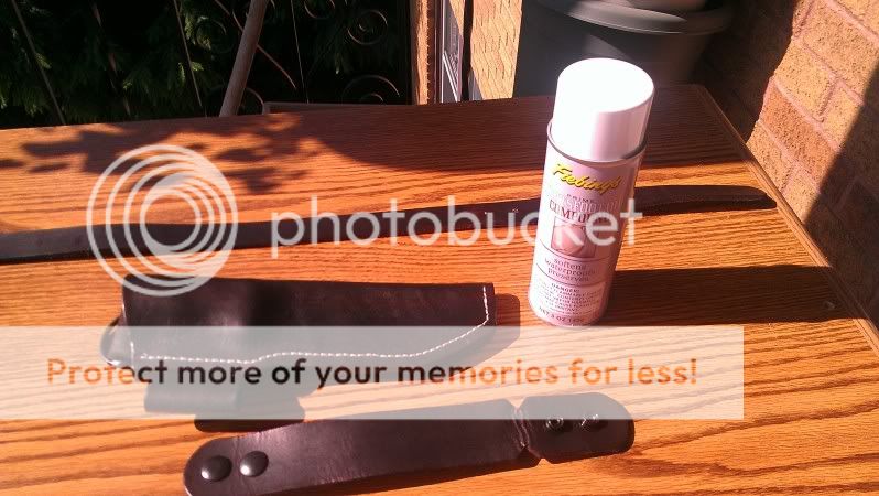

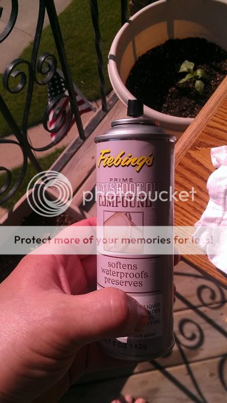

I wanted to get an oil onto the leather, so I decided to stop at the local farm supply store and I had a choice of a lifetime supply of Neatsfoot Oil or a little spray can. I chose the spray can. I had no camera person with me this time, so I had to resort to the cell phone for these. Here's what it looks like:
All laid out.
Then, I sprayed it on until it was "standing" on the surface. This leather actually soaked a lot up and then I rubbed the excess with a cotton rag. I'm not sure if it's the aerosol or the oil, but it smells a lot like WD-40. At any rate, I need to test to see if it's somewhat waterproofed now and I'll try to get pics of that, too.
Once dry, the white stitching didn't seem to darken at all, which I was happy about. I like the contrast and am glad it stayed that way.
Be careful using that neatsfoot oil compound. Too much of it will soften the leather and make the sheath lose its rigidness and turn into a floppy mess.
My suggestion for a natural finish would be beeswax and paraffin melted together with liquid neatsfoot oil. Rub it on and soak it in with heat from a hair dryer. Will stiffen up the leather and make it pretty water proof.

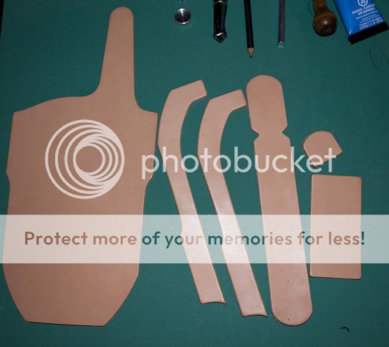

Sorry to resurrect this old thread. I have the same kit from Skystorm, and I am embarrassed to say that I'm just now getting around to assembling mine. One question, what is the smallest piece of leather in the top right of this photograph for?
I can't see where it is used in the sheath. Thanks for any help.
I believe you can put that at the bottom and put rivets through it and use it as a lashing point. I left it out on mine.
Correct. The lashing point is helpful if you have the dangler attached, though some people do let it flop around willy nilly like.
