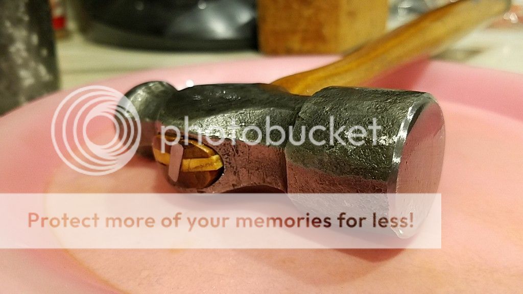

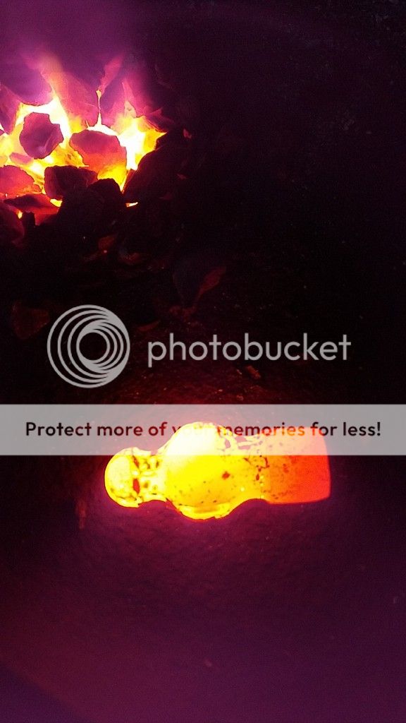

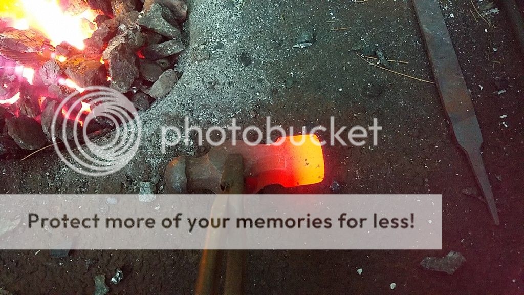

How'd you get the proper temper back in it ? BTW that turned out great👍
I don't know about proper temper, but I looked online about heating to a certain color then re-quenching. I did my best, amateur, non-scientific, just winging it temper. I'm sure that it isn't quite right and may be way off, but I was antsy to use the forge and I figured I would grab a worthless 1.5lb chipped ballpein head to use as my play-doh. I just wanted to hit hot metal! At best this is a usable hammer, at worst it will be too hard. This is one that I will not sell and will use for general tasks. I'll see how it works.
I've watched a bunch and read a bunch but have no practical experience. I think that I will follow along a beginner's course and start with pointing cold chisels and working my way up. My goal is to forge an axe/hatchet head that is of respectable quality. I'm a long way from that but I'll get there. I have a few heads that I've saved that are in great shape but have some even/symmetrical eye swelling that I want to fix. Light heat and shaping will make them easy physical fixes, but the heat and re=tempering is what I need to be careful with.

The temper crossed my mind but I wasn't the first thing. I was thinking you were doing exactly what you said here - having a good time getting your hands dirty and starting something you have wanted to probably for a long time. Also that hammer face was cleaned up nice, that head has a cool color cast to it, the steel wedge looks well set in the contrast of the kerf and wedge materials.
Also was thinking I want to see the handle lol.
Thanks for taking and sharing the pictures too.

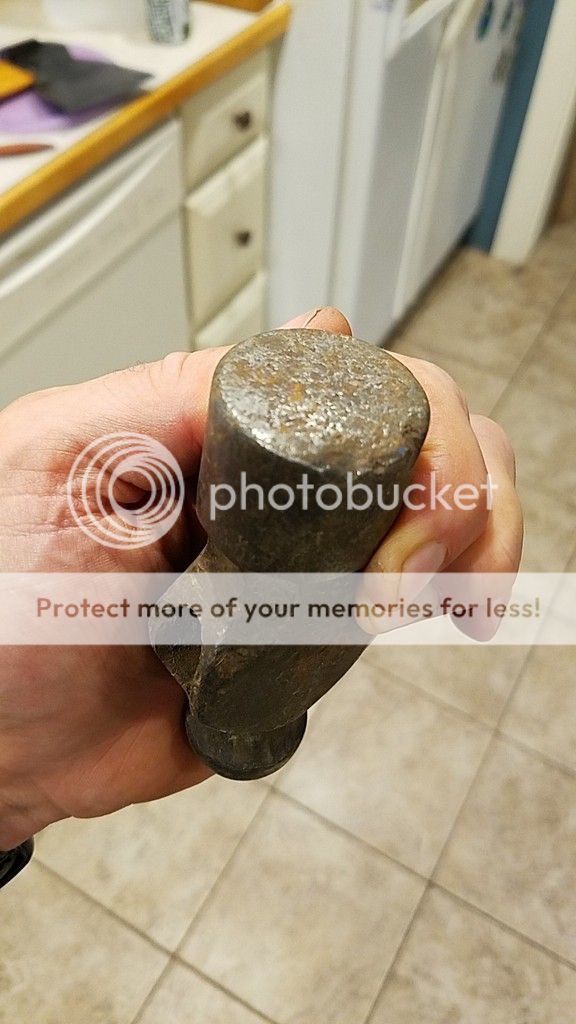

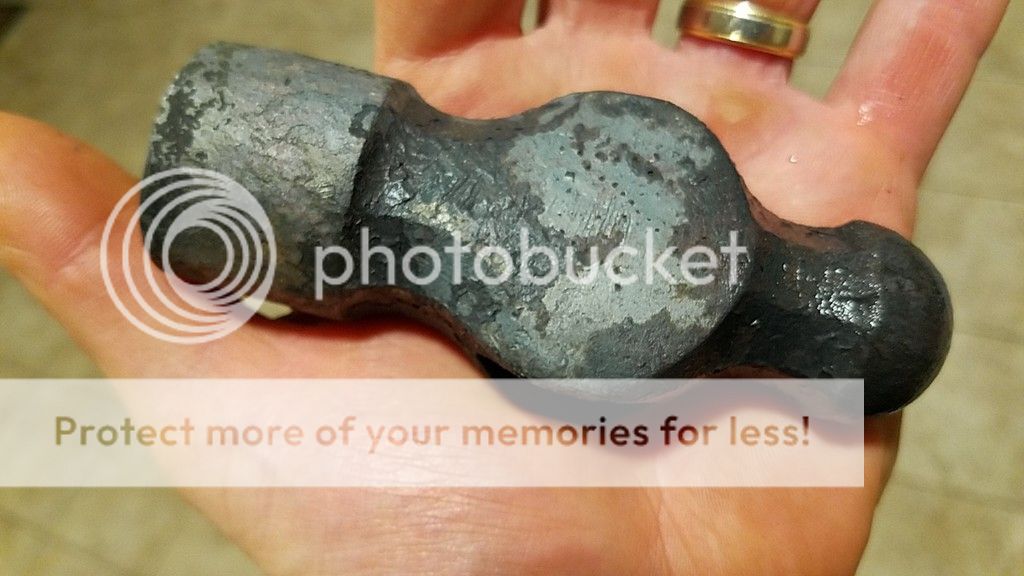

I had some fun tonight, and this head needed cleaning up.
Looks like you had a good time! Good to see your forge lit.
One relatively simple way to heat treat a hammer face is to harden it and temper it in the same heat. To do this you'll need some color charts and a 60 or 80 grit flap disc ready on your 4-1/2" angle grinder. Heat the face to non-magnetic (varies by steel but cherry red or 1500°-1600°F). Take the heat the full length of the hammer side up to the eye - the eye area needn't reach full temperature. Quench the face 3/4" deep leaving residual heat in the rest of the heated portion of the tool. Then quickly clear a patch of metal leading out to the face with the angle grinder. Get it just to shiny - should take only a couple seconds.
Immediately you'll see the temper colors start to run from the hot steel to the cool quenched face. Pay attention to the color. When the pale straw color hits the face quench the whole tool again.
Err on the side of too soft. You'd rather a hammer face that gets dinged up to a hammer face that shatters.
