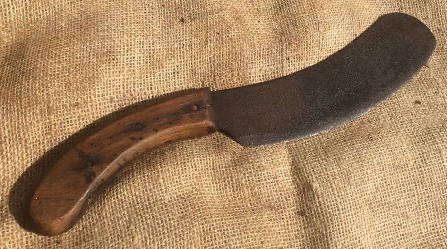

Slight used HI Farm Kknife for 7/7
George I had a butt-ding like that on my Thamar Tin Chirra...
I fixed it with some "Walnut Wood Filler" or was it mahogany? I think it was made by loctite or somebody. I just picked the fanciest stuff they had at Lowes. It looks pretty good, very serviceable!
I have no idea how it happened, I went out into the woods and it was perfect. When I came home it was chipped! Surely it wasn't me tromping around the woods and hacking at stuff ;)
Thanks for the info stwm. That sounds like an easy fix, or I'll glue the piece back and sand it flush.
I use Tightbond wood glue. The waterproof stuff. I think Gorilla glue for wood is great stuff too. Dont matter tho because if you clamp it the bond will be stronger than the wood itself so it will never break there again. Ill try to post up something this weekend on that repair George. The grit of paper dont matter too much. Just start with something coarse like 200 to shape it and work your way up to the finish you want. Some woods dont respond so well to the higher grades like 1000+ but the dark Satisal and harder woods do. I go to 2000 or even 3000 on it. Bamboo root is fairly porous and dont do too well for me in the higher grades unless you use some polymerizing stuff like BLO or Tru oil. Then you have to do many layers and let it dry really well between coats. YMMV?

Thanks Danny. I'm sure it's satisal wood so I'll try it with finishing with 1000+. I've got some JB weld and some wood glue. Think I'll use JB.

Be careful if you use Gorilla glue. It swells up a lot as it cures. So use a thin layer and clamp it tight, otherwise it will be a lot of work to remove the overflow. If you're gluing a chip back in place and don't have enough clamping the Gorilla glue might push it out as it swells and turn the repair into a mess.
In fact my recommendation is to test the Gorilla glue on a couple of scrap pieces before trying it on something you care about.
Gorilla glue has a regular wood glue as well. I think the stuff your talking about is just marketed as a general purpose glue. Not sure but ill have to look into that. I always clamp so it dont matter much. Just make sure you get the "WOOD" glue. Thats some good info David. I didnt know about that stuff. I got plenty of uses for that swelling stuff.
I didn't have the piece of wood, mine went missing. I'd definitely go with the TitebondII treatment.
It's excellent stuff, I use it for nearly everything. You can get liquid or gel. I usually use the gel, it's easy to mix, one to one by volume, easier to measure, I just eye ball to equal size little dabs.
Super tough, impervious to most anything. The kit comes with brown or black dye so you can blend the color a bit to match. They dye is very concentrated, a tiny little drop goes a long long way.
If your gluing a piece back on the liquid might have an advantage but I still use the gel myself, just easier.
