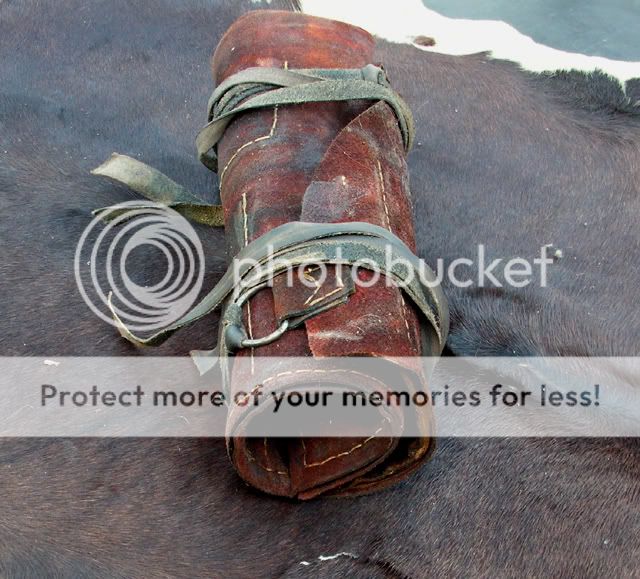

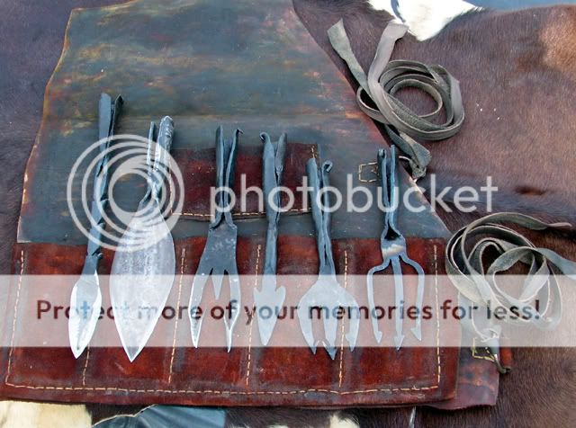

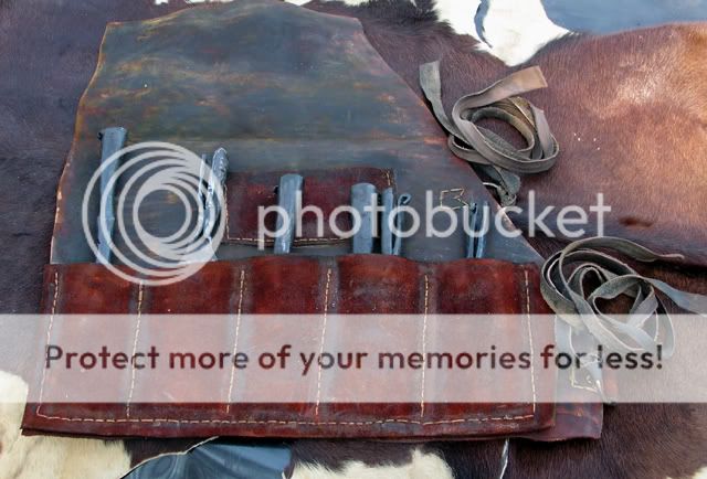

Can we amend the title of this forum to include other old handmade stuff? If someone wants to move this, go ahead, but there isn't anywhere. Anyway I told you I would do anything . This set is for a customer who is into Primitive. He goes out into the swamp, and stays there. All socket head so he can cut his spear where he needs them. The little cirlies are for tying on spear with a thong. I love it, It was a lot of fun.

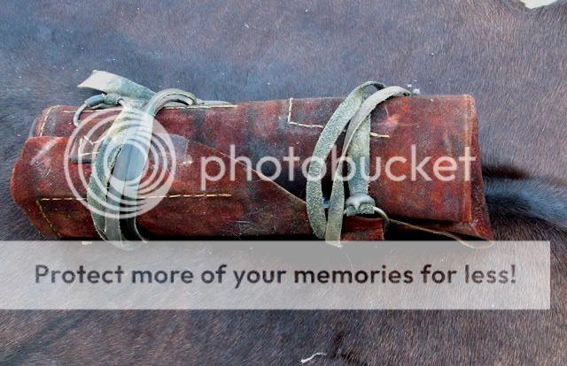

All reused steel, a shovel, a rock drill bit and part of a plow. Hacksaw, heat and beat. The leather “Roll” is from a set of saddlebags, D rings w/ long thongs to tie when rolled and also attach to a backpack. Stitched w/ linen 7 cord. Also an inside pocket for his handmade fishhooks.
