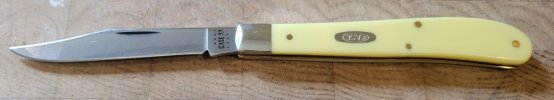

I had a slimline trapper and while living up to its name -slim- in aesthetics, the blade stock did actually seem very thick. Probably the thickest traditional knife I’ve seen.

FWIW, a dealer website that reports "blade thickness" claims a Case slimline trapper has thickness of .08".
(I couldn't find an explanation of where on the blade they measured thickness; seems to me they'd want to measure the maximum blade thickness.)
