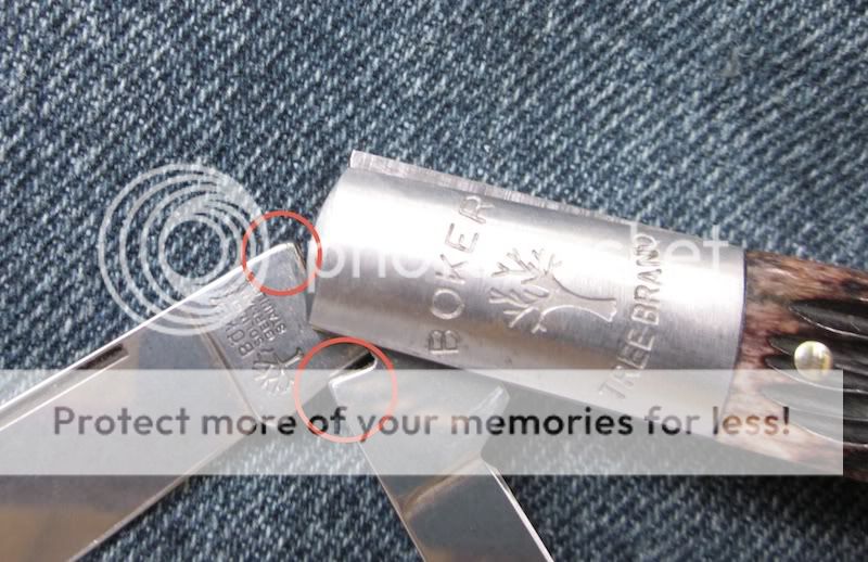

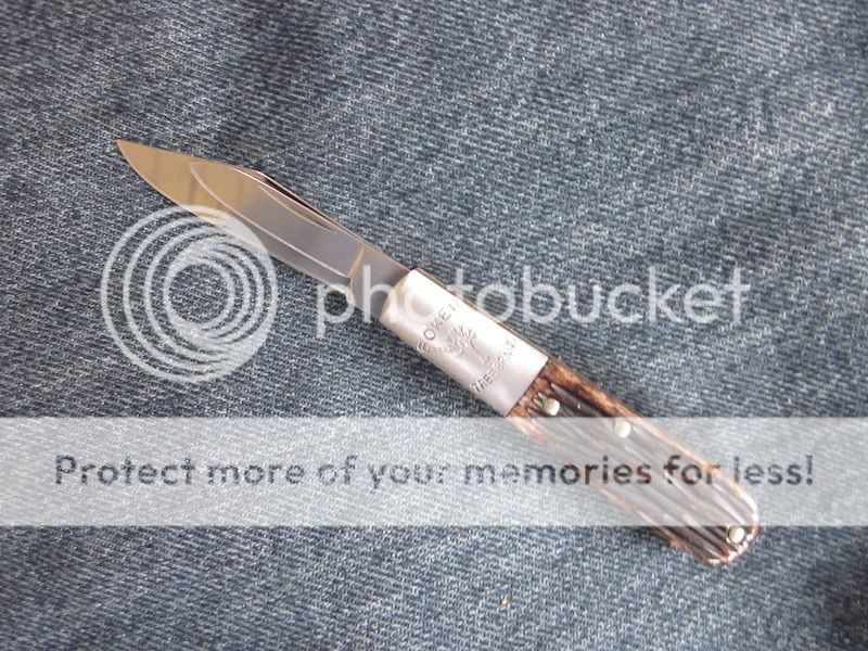

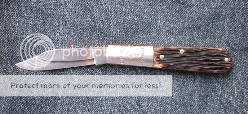

Dave, here's my own experience, and outcome, with a traditional slipjoint:
...I believe it can be "normal and acceptable," and more characteristic of some makers than others.
I have no idea if the following might apply to anything you have in front of you, and lack the knowledge of whether or not to recommend anyone else try this, BUT---
On this particular knife, "normal" or not, this bugged me:
Barlowopenbladeangle.jpg~original
I carefully sanded away material from the tang areas circled here, going slowly and checking things frequently...
Here.jpg~original
... bringing the blades more in line with the handle/springs when open:
Better.jpg~original
IMG_3610.jpg~original
I have not noticed any negative change in the knife's action or other characteristics, and think it looks much better now.
Hope this helps. :)
~ P.

@Pertinux thanks, that pic is exactly what I am describing. And those contact areas you circled are exactly what could use a bit of removal. And, its also a barlow so those pics really hit the mark. Thanks again guys.
