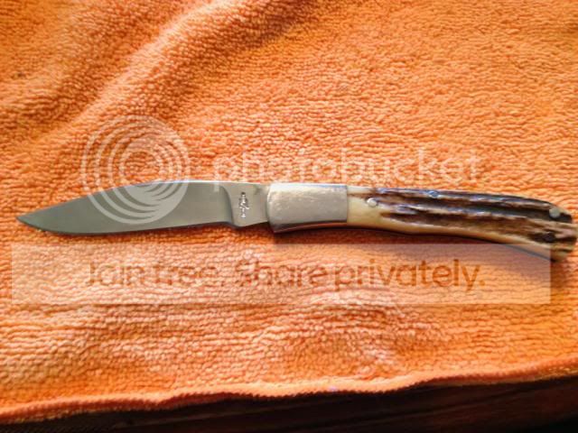

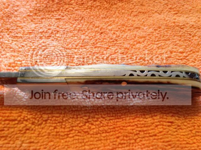

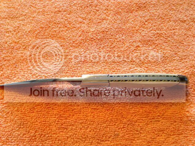

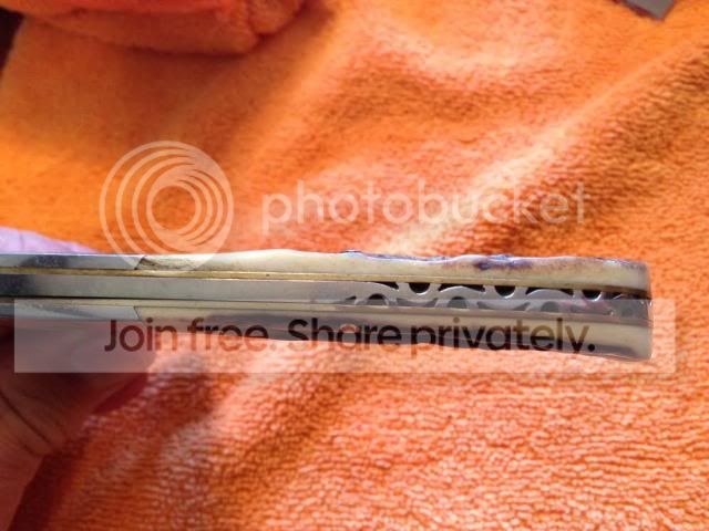

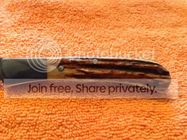

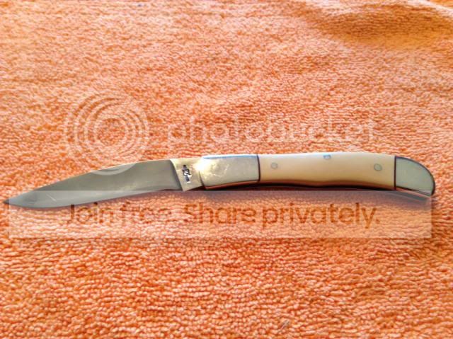

Recently I received 2 knives. Both are made by a maker last name Zinzmeister. I have not heard of this maker before but I must say his work on these slip joints is awesome. The feel so nice, joints are pretty tight and the snap that slip joint has just keeps me thinking about it. The guy who sent me them says he got them directly from maker in 2001 I think.
Well my mission is to replace the ivory micarta one with some mammoth ivory, a daunting task for me made more difficult by the fact that the FF is hardly lacking.
Any way, now that I have seen and handled these knives, I just have to have a go at making one. Could any of you slip joint makers share a couple different traditional patterns with me? It would be very much appreciated.
and here are some pics of the Zinzmeister knives.
