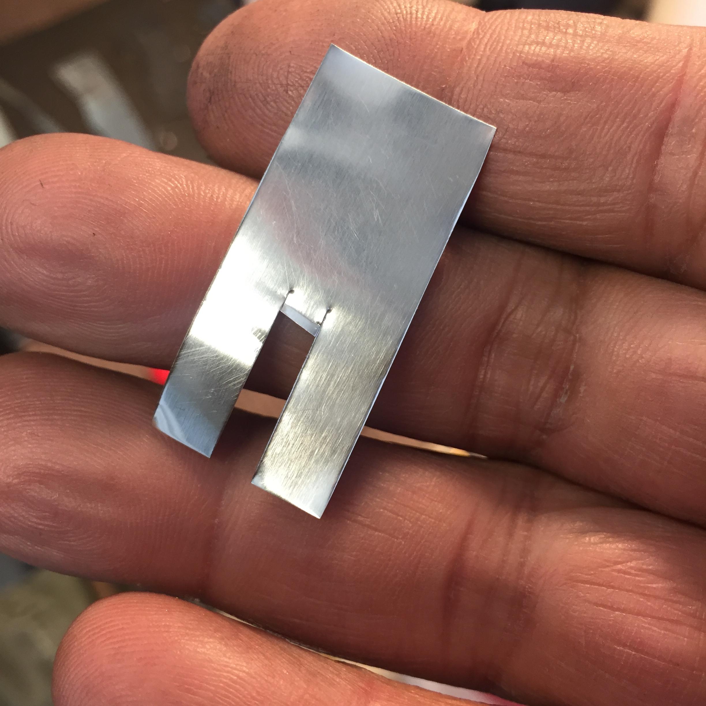

Ok, I'll try doing the pivot pin like you said. I am worried about peening it too tight. My spring is about .005 thicker than the blade. I guess i can stick a scrap piece of steel inside the handle to help from peening it too tight?
use .002 stainless shim and some stainless lube,
cut out the shim to make it look like a pull tab, with a slot for the pin.
pull the the shim out and it gives you .002 clearance
of course if you peen the pivot too hard then then shim might be stuck
you have to find the right balance
