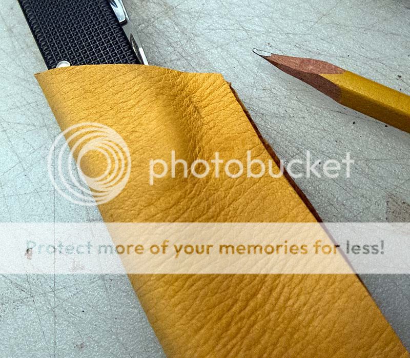

Making these I wrap the leather around the knife, pulling the leather tightly as they usually have some stretch to them. Pressing down around the leather once you have it pulled tight, opening the leather up you'll see where it's made an impression in the leather, this will provide you some guide lines as to where the edges of your sheath will be. I take a pencil and draw a line just, barely just, towards the knife side of the impression. I also will slice down the sides, holding it down with a small ruler, so you know where the two edges should meet.
Down at the bottom you'll see it drop off because the knife's spine, just continue the line across the bottom of the sheath, you'll end up with a great big U shape. Apply your contact cement along the outside edges of the sheath, along that pencil line. Like other sheaths when you are making them, don't be stingy with the leather, I allow about 1/4" to 3/8" wide of an area to glue down, this will provide a more solid surface to sew.

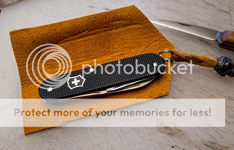

You're welcome and yes, that green is super nice! Just got my Black Alox Cadet in tonight, wow, I wish I knew about this one sooner, very cool, while I would probably rather have a small coping blade instead of a fingernail cleaner/file, it'll do just fine...very sleek thin folder, while I would most likely carry this in just my watch pocket, I made a slip sheath for this thread, pardon the images, still recuperating from my busted ankle and not the most mobile person yet.
Here you can see the impression the knife left on the inside of the leather, now the outer edges could be a little wider, but I found this small piece and saw it would JUST work for this knife so I used it, otherwise I'd have a bit more room to the outside of the threads.

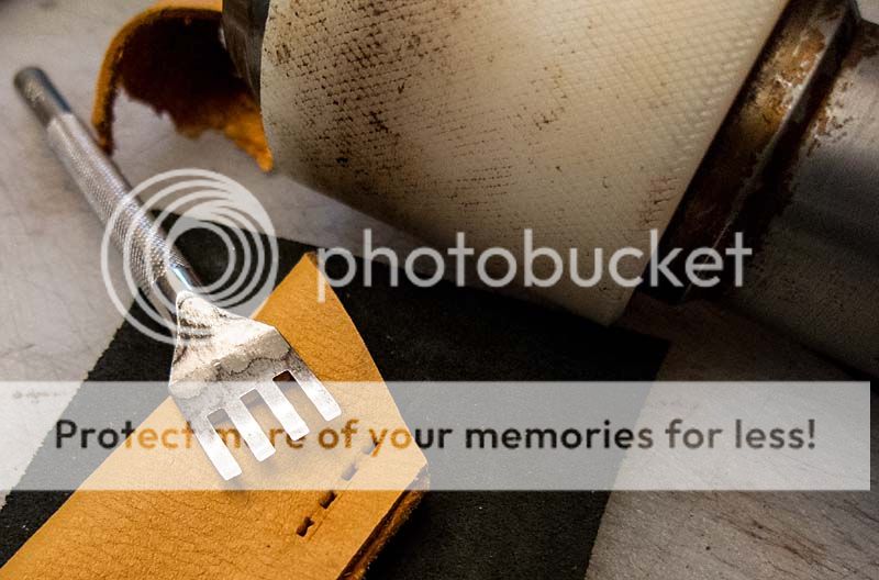

using a mallet and a 4 prong stitching tool to put holes spaced down along that line
IMG_0384.jpg~original
around the bottom I switch to a two prong one I made from an old 4 prong tool, makes it easier to go around the corner

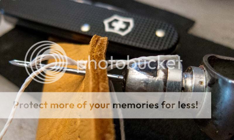

I use an Awl n Awl for sewing, always have, probably always will. See more info in the tutorials at the top of this forum on how I sew, basically one thread on one side, one on the other, poke it through, pull back to make a loop, put the thread through the loop and pull back down into the leather

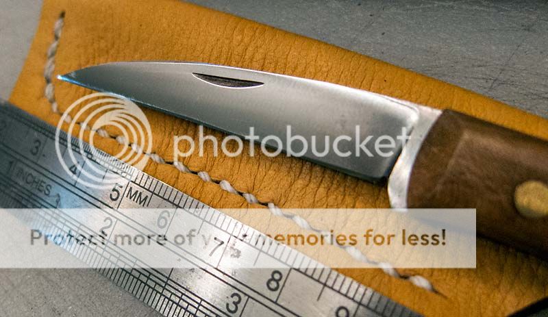

I'll start from the opening down to the bottom and back stitch several holes to lock the stitching in, once it's stitched up, use a straight edge and a sharp knife, just happened to have Tina on hand to help, clean cutter she be too, thanks again Ken!

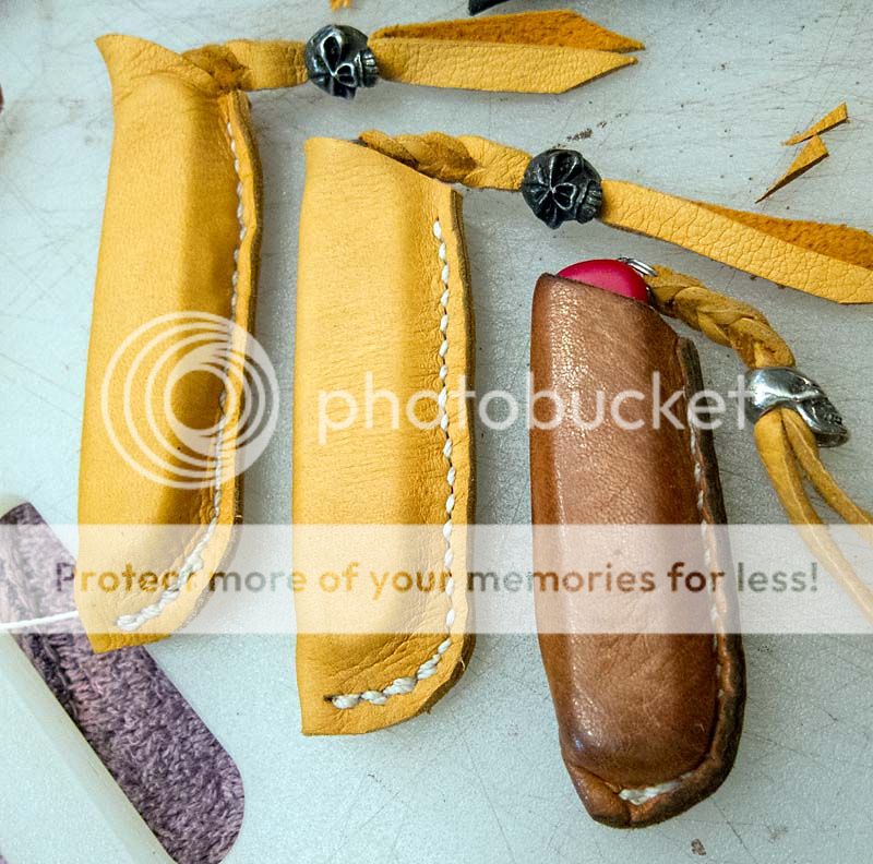

Here's three that I have right now, the bottom one is for the SAK Executive and has seen a lot of travel, the top is for the Green one and you can see the outer edges of the leather are starting to roll with use, it'll become curled up along side in time and the middle is the one just made for the Cadet.
