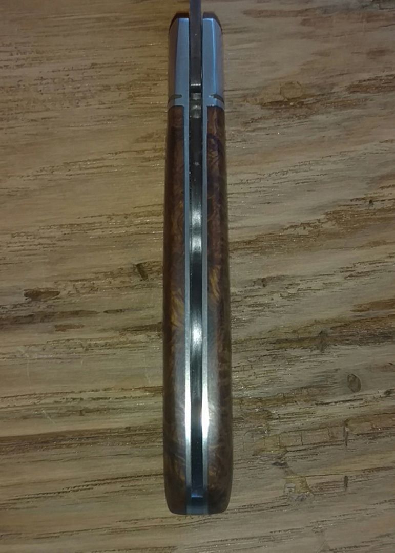

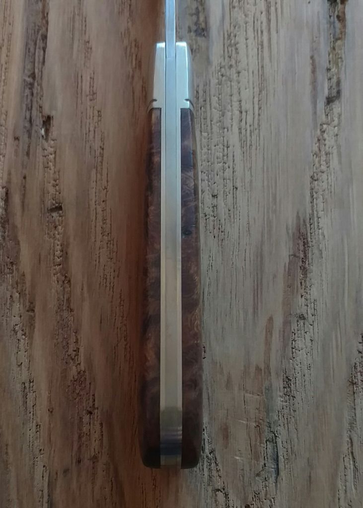

I would like to see more "makers angle" shots. ie. One into the well and another of the spine. I agree with Tim that ascetically the tang is a bit long for my eye. I would like to see the swedge closer to the end of the long pull so as not to break up the flow as much...just a tad. The plunge line would look more pleasing to the eye if it was a few degrees more angular from spine to edge. I think the makers mark would look better if it were smaller.

I took a few shots with my phone. Hope you can get a feel for what you wanted to see. The "well" shot is difficult. My wife took the "purdy pics" might have to get her to do a few more angles next time. Thanks again.
