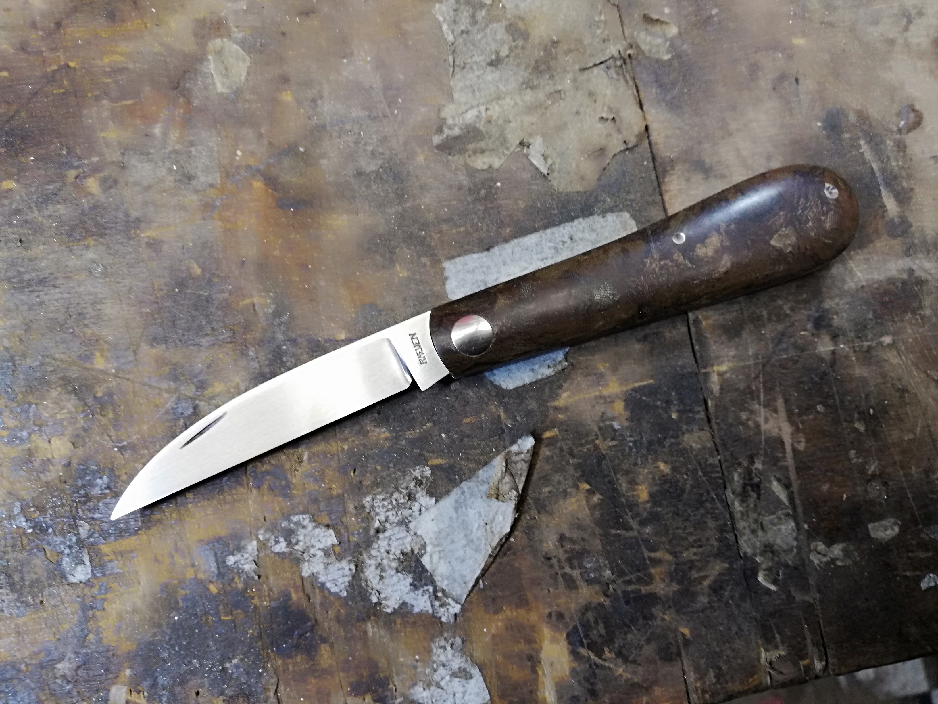

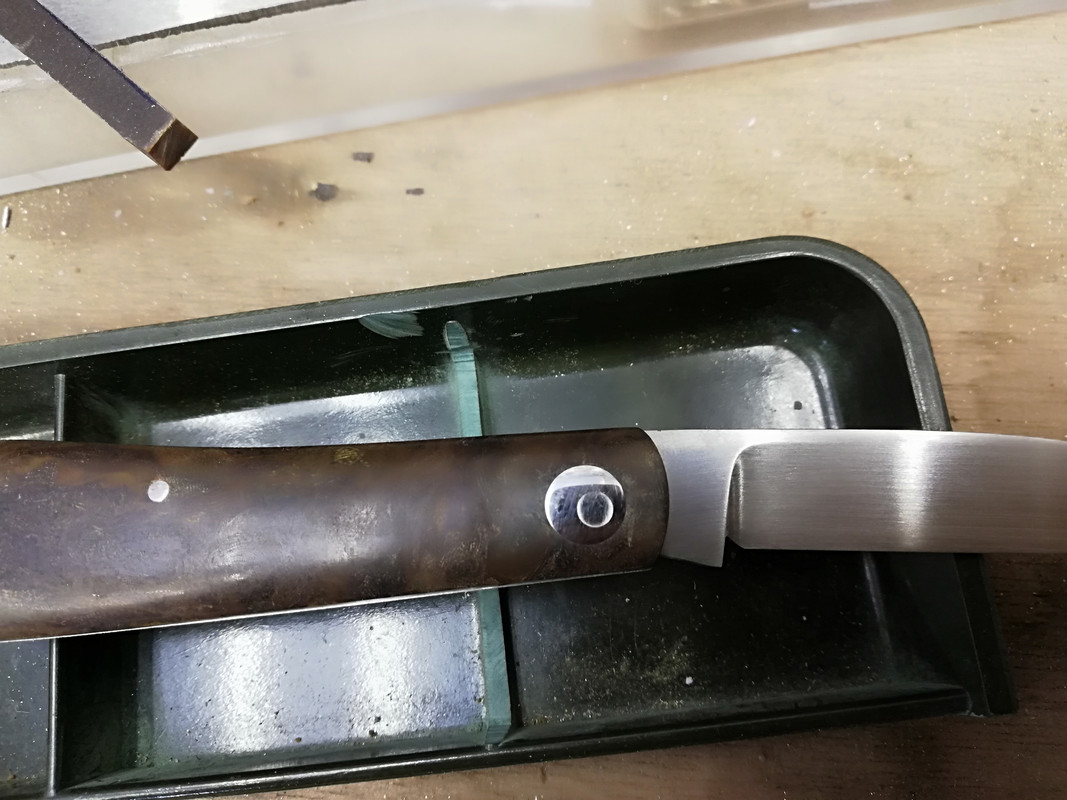

This is slipjoint #11 for me.
As you can see the pivot did not disappear well in to the disk around it. Both are stainless (annealed). The pivot is 3mm
I think it is because I chamfered the hole to much, having to move to much steel to close it.
Am I right?
Or is it something else?

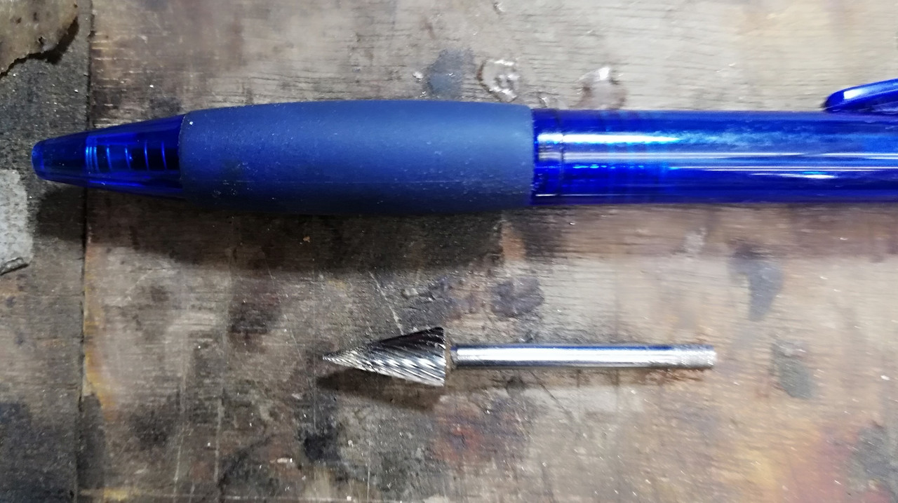

What are you using to do the chamfer? I am using a bit on the advice of AVigil AVigil : carbide 20 degree 0.1mm CNC triangular pyramid engraving bit.
I was only able to find it on ebay from china.
I think that is the issue as it is way too steep. I suggest using a 4/0 tapered reamer for 3/32 pivot stock. Ream it by hand and just barely. You do not need to remove much at all….you could probably get by not reaming at all.
To set the pivot, Pinch the pivot pin together inside the flat jaws of a mill vise while keeping an eye on the blade ensuring it is centered then after it is mushroomed peen the rest by hand with a 4oz hammer on your stiddy.
I will then take a file and file down the excess just scratching the surface of the shadow bushing and then go to sandpaper with a hard backer (ie. A piece of steel)

On this one probably you chamfered the hole to much .This should be easy task ..... I have some question about process .Did you tapered little ends of pivot ? Did you use shim under pivot on other side when you start peening one side ? If you hit too hard and move the material quickly, it is not good ,the pin will expand to fast and that part will remain at the surface , inside it will not expand to fill the taper . Light shots, many of them are better when you peening pins .
Thnx, I probably removed to much steel around the hole. I used a carbide cutter in a drill press.
I have a hand reamer on order for the next one. First I'll re-handle an older slipjoint to try it out and see how it goes
