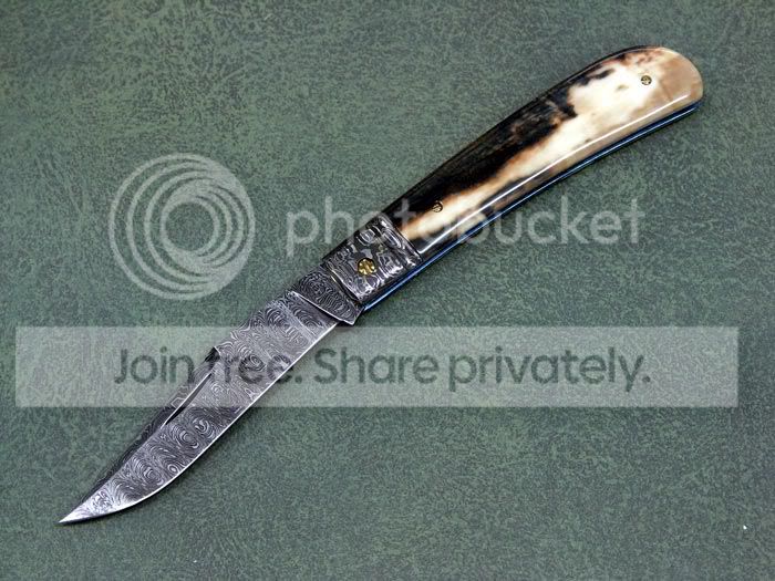

I have seen a few slipjoints that used a regular folder pivot and screw construction; looked great.
I'm guessing that you don't see this method as often because most makers are going for a more "traditional look".

I use damascus for springs on folders like shown above, usually same steel as the blade. On more traditional slipjoints I use W2 for blades and W1, or 1084 for the springs. Heat treat like the blade, but use a higher temp when tempering springs, for a Rc hardness of around 50.

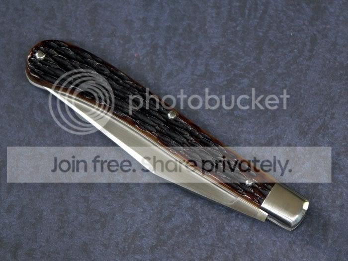

Most of the guys buying traditional slip joints want the knife pinned together and really turn their nose up at screws. I like screws and use them on all my damascus slip joints. But when I do traditional with no damascus, I pin everything together. Two different styles of the same type knife. Works for me...
