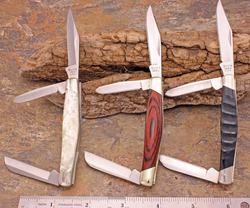

Here are three photos and my critical review of them in my "state-of-wanting".

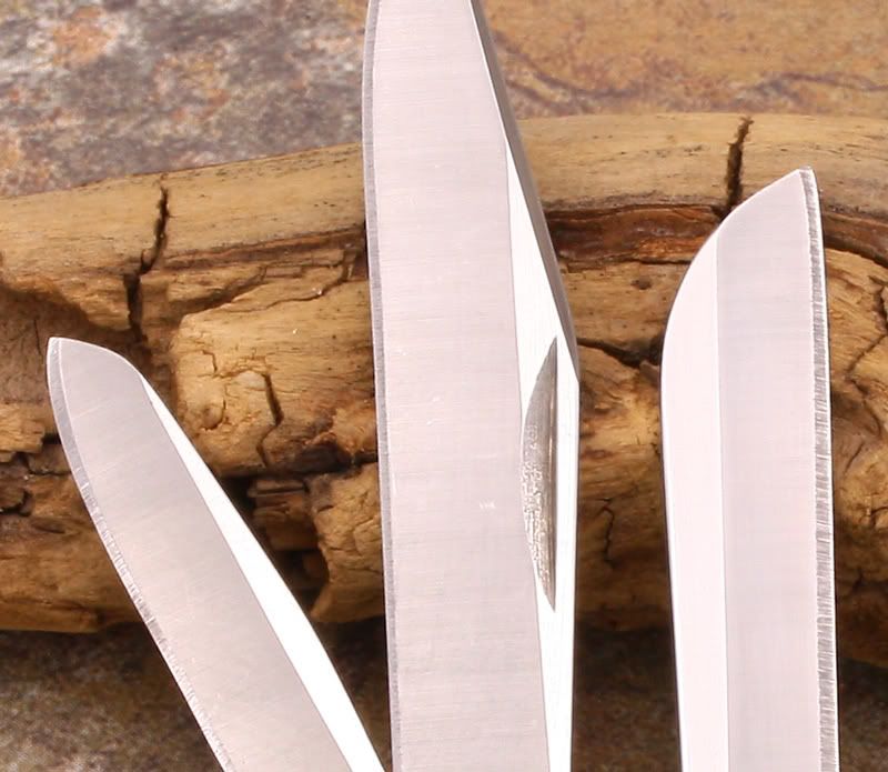

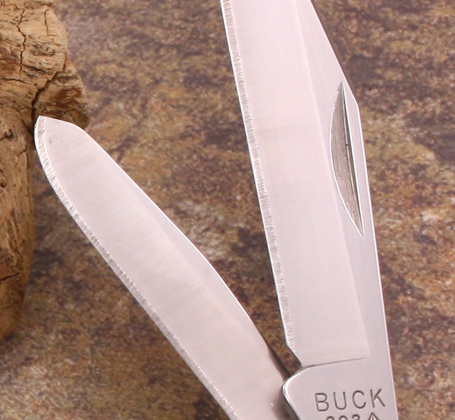

Looks pretty good but look at the difference in the polished area above the bevel grind and also noticed the nail nics are different sized. On a limited edition knife I would hope for more polish on most surfaces. Yes, it costs more but we are not paying 5 and dime prices for these limited editions.

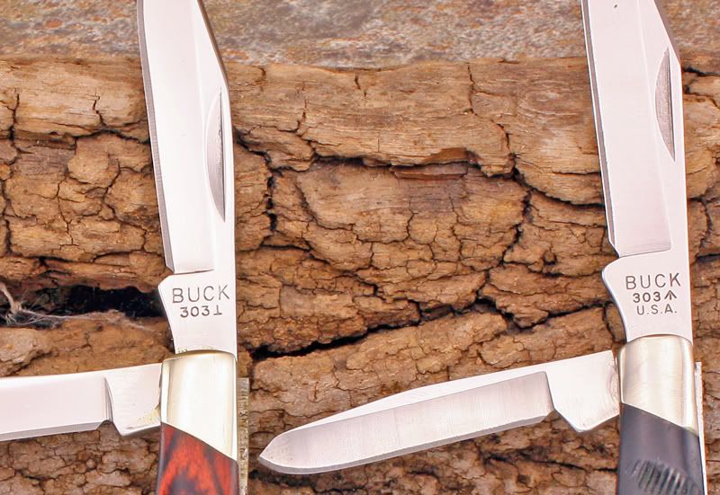

Here's the reverse, noticed that the partial jigging spots had bolster edges rounded off in the depression. I think I would like mine sharp with scale thick enough it could be polished down to bolster level. The partial jigged areas next to the bolster were "messed up" by the bolster polishing. Notice difference in nail nic size. Front scales look better in both knives ?

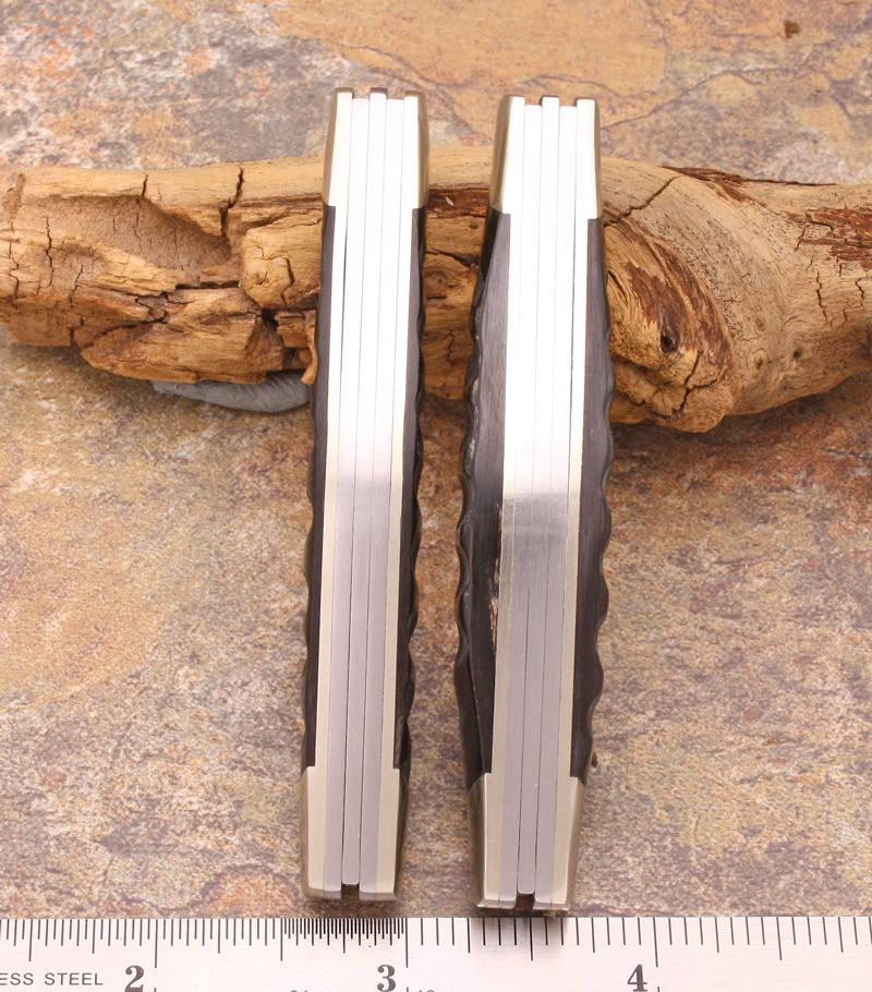

Photo of bottom view. Yes there is variance in natural materials, but I would want my scale thick enough that it could be buffed down on ends so that no jigged depression were against bolster edge.
