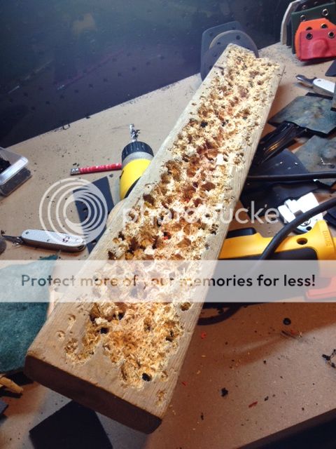

The pea sized brain isnt working tonight. Can someone please give me some ideas on how to add slots to kydex say for a belt :confused:
A jigsaw? Trying to envision it but I cant see a safe way of making it happen on my work bench. Get a vice to hold the sheath securely while sawing maybe?
Made due tonight by drilling a line of holes with my drill and cleaning it up with my sak awe and dremmel, works good but sloppy/hardly a clean 180 degree cut. When drilling holes I set a 2x4 on top of my work bench, set the sheath on top, and drill into it. Kinda ghetto but it works. However, if I use a jig, it will eat through the 2x4 and into my bench Im thinkin :confused: and with the jig can I start from the top (penetrate it directly into the kydex) or do they only work well when starting from the end, (like a bandsaw) No experience with jigs so please pardon my ignorance.

Drill your start hole, then your end hole.
Draw a line from your start hole to your end hole on either the outside or the knife side,
Draw another line opposite the one you just drew
Stuff your jigsaw blade in the start hole and aim it and your end hole
make sure you're off to one side, either the knife side, or the outside.
cut... follow the line... cut... follow the line... cut... follow the line... take your time, make it straight
repeat for the other side of the hole.
provided your slot is to be straight you should be alright.

Assuming you're doing a pancake sheath like the ones in your pic... Drill your holes first (through both sides) then draw your lines on the inside. From there you can just clamp it half of it to your bench with the part your doing surgery on hanging off of your bench... just watch out when you're running your saw your sheath will bounce like hell you'll probably want to clamp something to it... I'm sure you'll figure that part out...
Edit 2:
Made a quick and dirty in paint of the hole/line bit
The red bits are the lines you want to draw and cut along, make sure you stay INSIDE the lines.
you can file/sand the rest straight.
If you have a router, I can suggest how to make a jig...

Thanks for taking the time to post that. I like that. Seems simple enough, now I gotta go buy a jig and vice and test it out. Thanks again man.

I use a sheet metal punch it has a back stop and you just punch half holes until your slot is long enough
http://roperwhitney.com/punching/2-45.cfm
