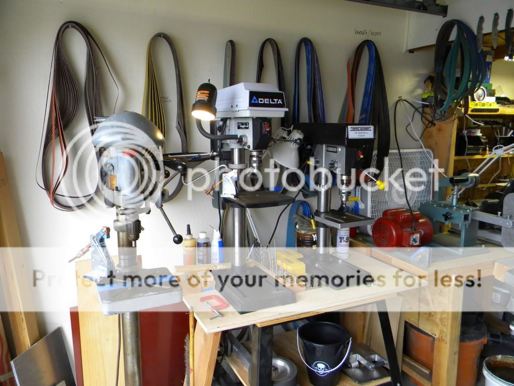

I just picked up a Central Machinery 10 inch, 12 speed press from Harbor Freight, with coupon code came out to about $125 shipped. It's not my main drill press, but if you're on a budget it'll certainly give you some good service. I know plenty of pro makers that use the very same model.

Here is a comparison shot with my other presses that I just took:
How can everything be so neat?? No dust, no drill chips! WOW!!
LOL, that's because I took the photo right after I built that table and mounted the presses!:D I'll get you another shot after my next shop day.........you'll be calling me pig pen after you see it;)
