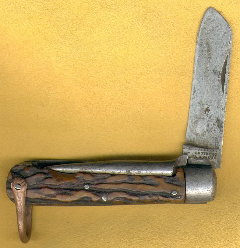

I have one that seems to fall into the last category. It is marked Harrison Brothers and Howson, and its manufacturing location is not marked; probably Sheffield.
At 4 3/4" long, would you say it still falls into the Admiralty pattern?

Thanks everyone for your positve comments. Yes waynorth that appears to be an Admiralty 301 pattern made in Sheffield. My knife is a little longer than 4.5 inches. There was probably some slight variation from maker to maker. Knice stag on your knife. Thanks for adding it here.
added; just looked in Flook's British and Commonwealth Military Knives book and there is a photo of a Harrison Bros & Howson 301 described as having original spec stag handles, a 3.5 inch sheeps foot blade and an overall length of 8.125 inches. Looks like your knife waynorth.
