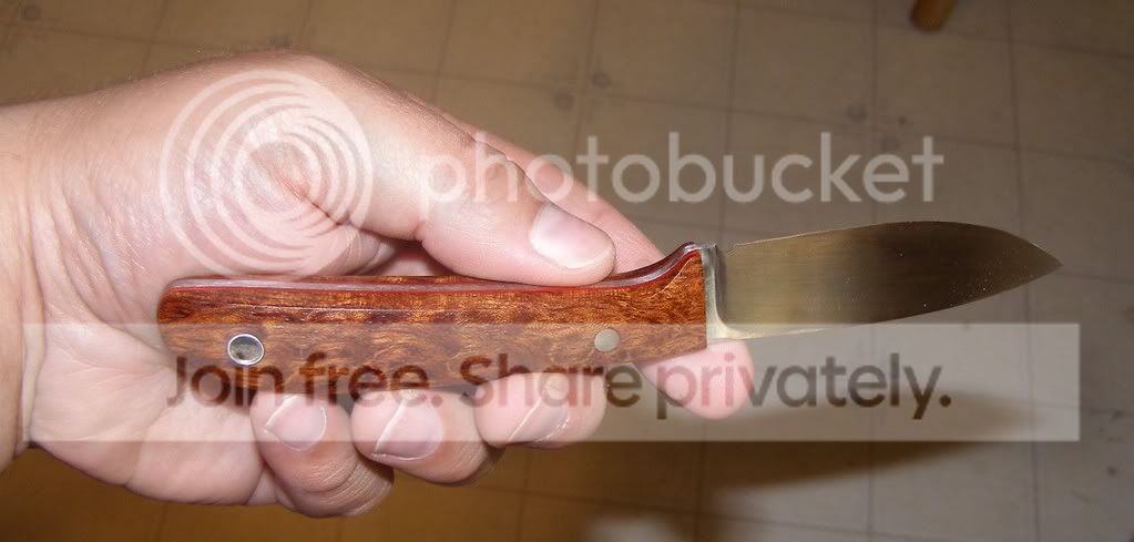

Small Drop Point Hunter
Dec 31, 2007
420
Finished At last
This is a small hunter 1/8" ATS-34
Bubinga Handle
Stailess Drill Rod Pin
Stainless Lanyard Tube
Red Pacers
Blade is Just under 3" (1/16th under) and OAL is 7"
I have not made a sheath for this one.
Paul Bos Heat Treat.
Nice proportions and flow. Beautiful wood. I especially like the sweep of the plunge cuts with the shape of the blade. In the foto, the thong tube looks like it could use a little more attention at the inner rim and clean up the inside.
Nice piece.:thumbup:
Fitzo Your are right on with the lanyard hole. I got a lot of the Ture-Oil in the lanyard hole that I still need to clean out. I was thinking of using a Pipe cleaner with some WD-40 on it to clean it out. (Good Eye)
Larry, for shining up the inside of my lanyard tubes I took a piece of 1/8" brass rod ~ 3" L. and saw cut a short slot in it. Chuck it up in your foredom or dremel tool, slip a small piece of 220 paper in the saw cut slot and roll the paper around the brass rod. Slip it into your lanyard tube and let-er-rip. It will shine the ID of your tube up like a mirror.
Great looking knife you made there btw :thumbup: I like it :)
David,
I like your method of using the brass rod and sand paper. I use s similar technique. Instead of a brass rod, I just use a long cotter pin in my electric drill.
