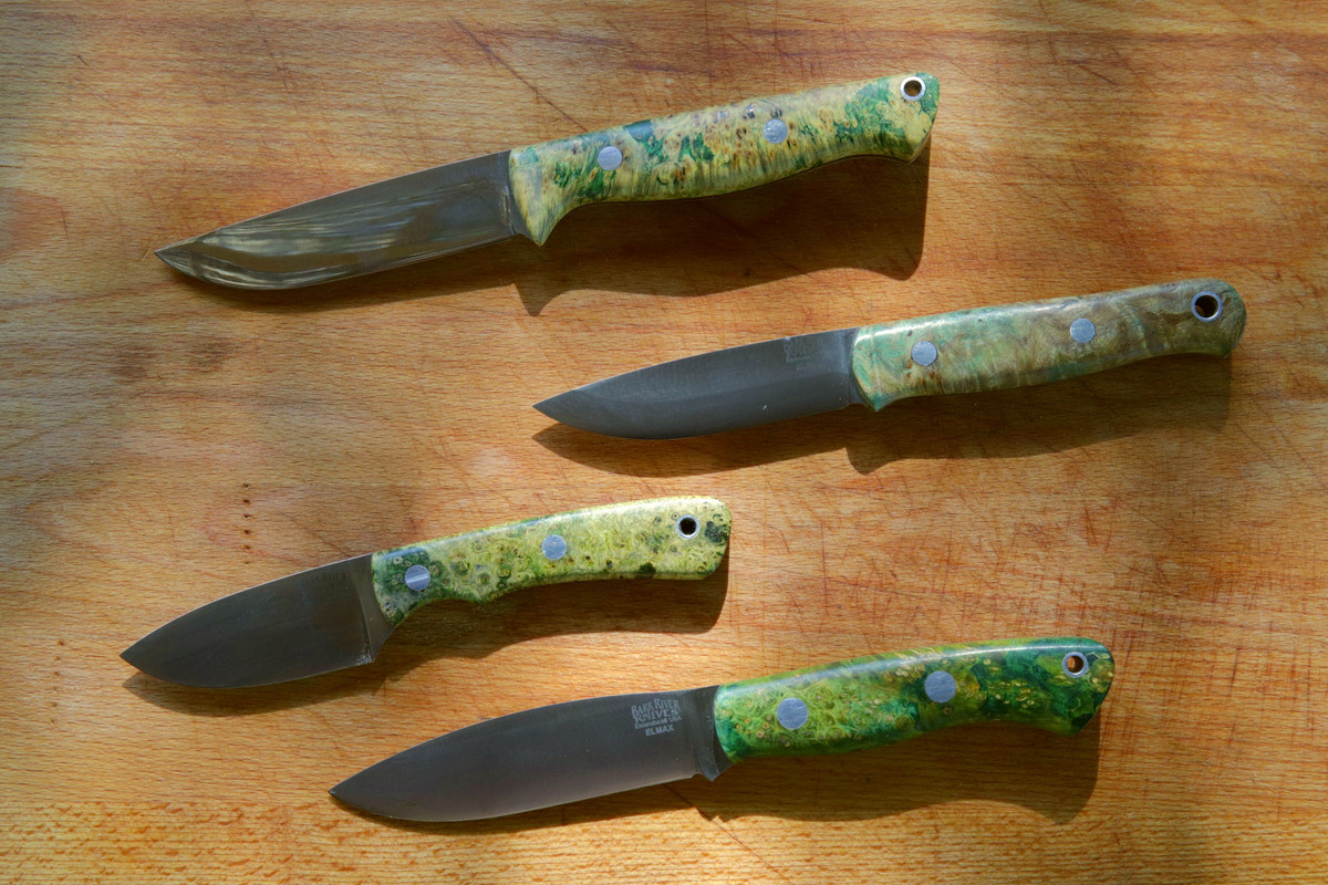

Man your blades are solid designs with decent lines. And your only a bit of sandpaper and some time away from bumping them up a notch.
You should always want to be in higher demand even if YOU CHOOSE not to take on extra work.
This is meant as positive constructive criticism. It pains me seeing guys using the above position to justify lesser fit/finish than they're capable of.
Knives can be BOTH beautiful/exquisitely finished AND functional. I want makers to always do better(ultimately their best) work.

I'm VERY proud of My work. I make knives that others aren't making. If people were making knives like how I wanted, I never would of started making knives. I know my knives are Better, and the people who have them say so. I know it's alot of hard work and time that I put into each and every knife. I am Slow.
I do need to let people know what to expect though.
There will be scuffs and scratches, dings, and nicks........ I want to make knives for People.
Knives people aren't afraid to use. I don't want to sell knives too expensive, too pretty, too rare to use.
I am going to polish up my looks a tiny bit. I made a nice disk grinder. This winter I am going to make a waterfall platen.
Each knife looks better and better. I will increase my finish, but I don't want to increase my cost. Much.
I understand collecting things/knives..... but (I'm) not ready yet to be lumped into That group. I don't plan on making any safe queens any time soon.
Please Use my knives.
