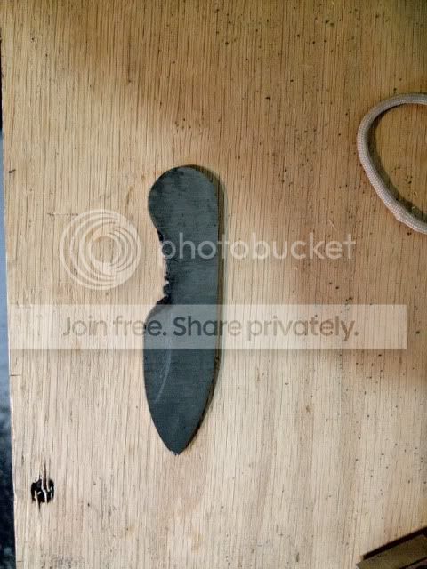

The rough shape was cut out with a grinder

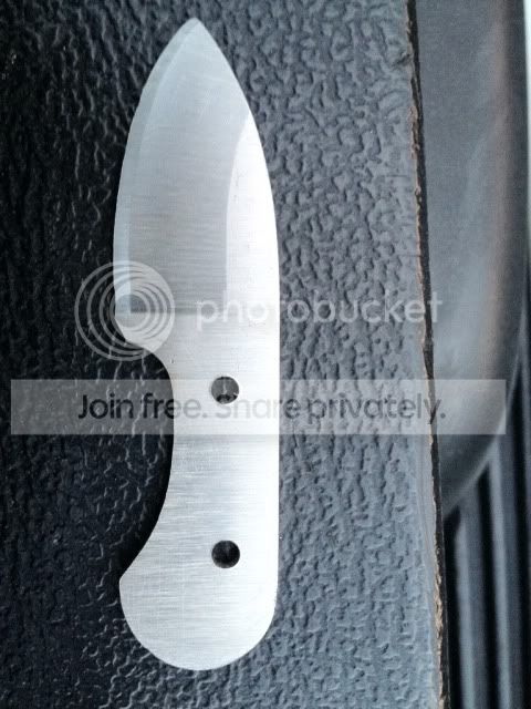

Forgot to snap a few pics in between, but I used a 80 grit belt to flat grind in the bevel. Then put a 15 degree edge an drilled a few holes. I'm still struggling with the grinding but I am not gonna be to critical of myself seeing as this is only my 3rd time grinding. I went to high on one side but the left side came out better.

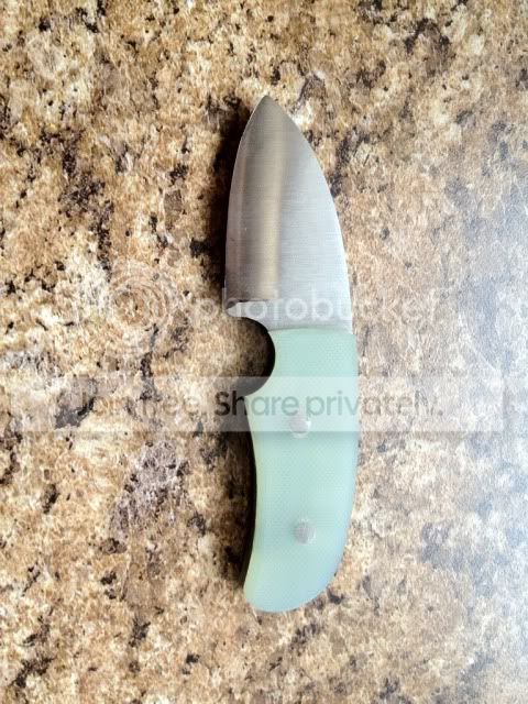

This last pic is a just a quick convex grind and some jade g10 with 3/16 pins. This was just to practice putting on handles. I wanted to try it out on this knife so I didn't mess up my WIP

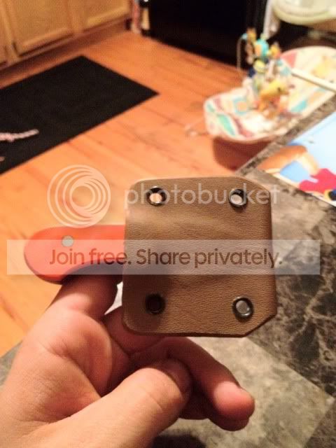

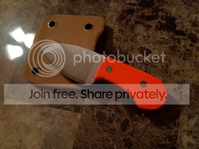

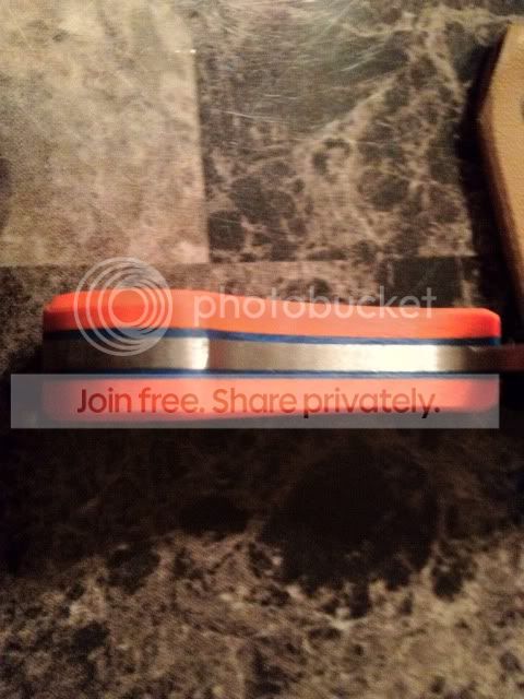

I figured I just post up the finished pics. I used orange g10, blue liners and 3/16 stainless pins.
It looks as though you suffer from the dreaded blocky handle syndrome. I doubt there is a new maker that doesn't struggle with it. I have it bad. don't be afraid to take of a lot of handle material to make it comfortable. curves are good, edges are not.
http://www.bladeforums.com/forums/showthread.php/870361-Avoiding-the-dreaded...BLOCKY-HANDLE!
I don't mean this to say that you did a bad job. I love the knife. I just want to pass on what other people have told me.
