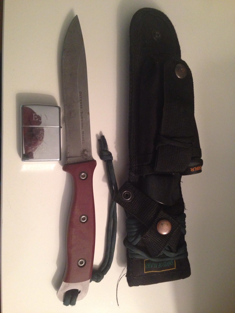

What I am seeing is a lot of input on specs and style. How about type of steel, Knives of Alaska has got a superb D2 steel that holds an edge and is easy enough for even me to sharpen. No it's not completely stainless but I like a little patina.
