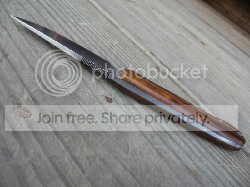

Here is a little knife I've been working on, between others. Designed to be a small game knife, the ricasso is long enough to choke up on the blade for those initial cuts on squirrels and such.
Blade is A2 X 1/8 flat ground handle material is Desert Ironwood from Shaughnessy here on the forum. Hidden Tang,the handle is secured with Brownells Acraglass epoxy. Still need to etch my name, and make the sheath.
